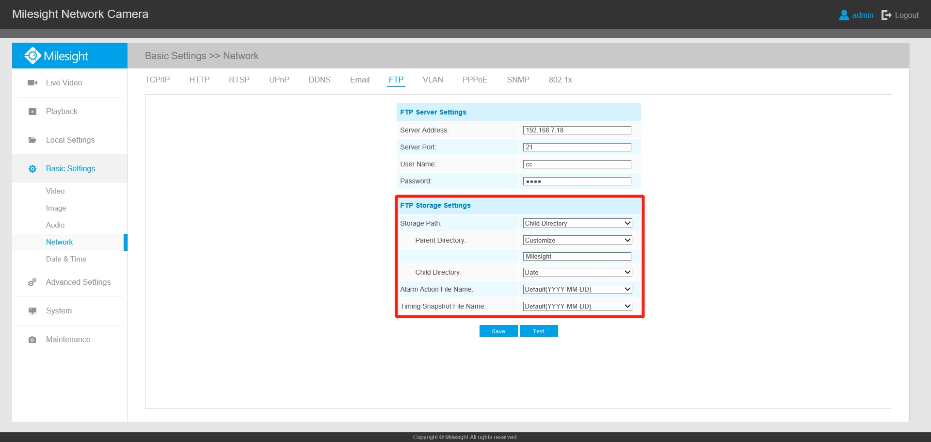

We changed the FTP working mechanism, set the Date to an option to generate the FTP folder, not by default. And I think the Date customer said is dynamic date time, not a folder named Date, right?
So based on the situation customer told, you can ask him to do as following steps to make video storage to the David/Milesight/Date again.
  1. Share the folder David, for example, I shared folder G:\David.
  2. Set the Storage Path on camera to Child Directory, Parent Directory to Customize and input Milesight as Directory Name, Child Directory to Date.

Hi, we have contacted Milesight Tech Support again and received this latest advice:
Please ask him to share the David folder on FTP server, no matter where it is, find it and share it. I mean, not just share the David, if it is in E:/1/David, then share this path.
After sharing, plz set as per the last email I sent. No need to set David in Camera side.
Besides, if storage path set to customize, Multilevel folder name supports three levels of folder name such as aa/bb/cc.

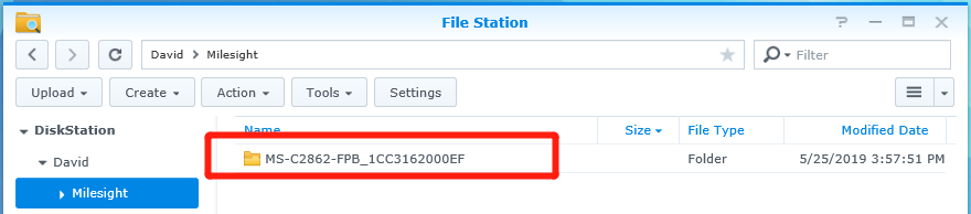

On my Synology NAS I have volume1/David, volume1/John, and volume1/Margaret shared.
Note that 'Milesight' is below folder 'David'
When I fill in the form with with 'Parent Directory' set to 'Customize' the inserting 'Milesight' as instructed save and press the test button I get 'Failed' message.
However if I fill in the form with with 'Parent Directory' set to 'Customize' the inserting 'David' save and press the test button I get 'Success' message with contents of the share = David/"Today's Date"/test.txt.
This suggests to me that when 'Parent Directory' is set with 'Milesight' the NAS is trying to find volume1/Milesight which does not exist and that to make it work the 'Parent Directory' needs to be set to 'David/Milesight' which is not allowed.

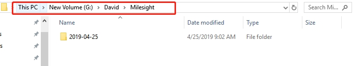

I tested this on my PC with NAS share: David and subfolder: Milesight.
Test 1. Map network drive with \\192.168.1.67\David This works
Test 2. Map network drive with \\192.168.1.67\Milesight This does NOT work.
Test 3. Map network drive with \\192.168.1.67\David\Milesight This works
Since test 2 failed on my PC I would not expect it to work on a Milesight camera or any other camera for that matter.

I can confirm my FTP settings are OK.
I have created a folder called David on my PC and created a sub folder called Milesight.
This actually works on a PC but who wants to leave their PC running 24/7 to store camera video.

I checked again and seems like the Synology can't share the sub folder like you said, so that our camera can't reach the folder Milesight directly. That's the Synology issue, I'm afraid if you want to use Synology FTP, you need to create root folder manually for every camera.
Or how about NAS? You can use Synology NAS, and we will generate folder named Model Name_MAC Address for every single camera automatically, so that you don't have to create folder manually. You can also trigger storage to NAS for alarm. Is it ok?
