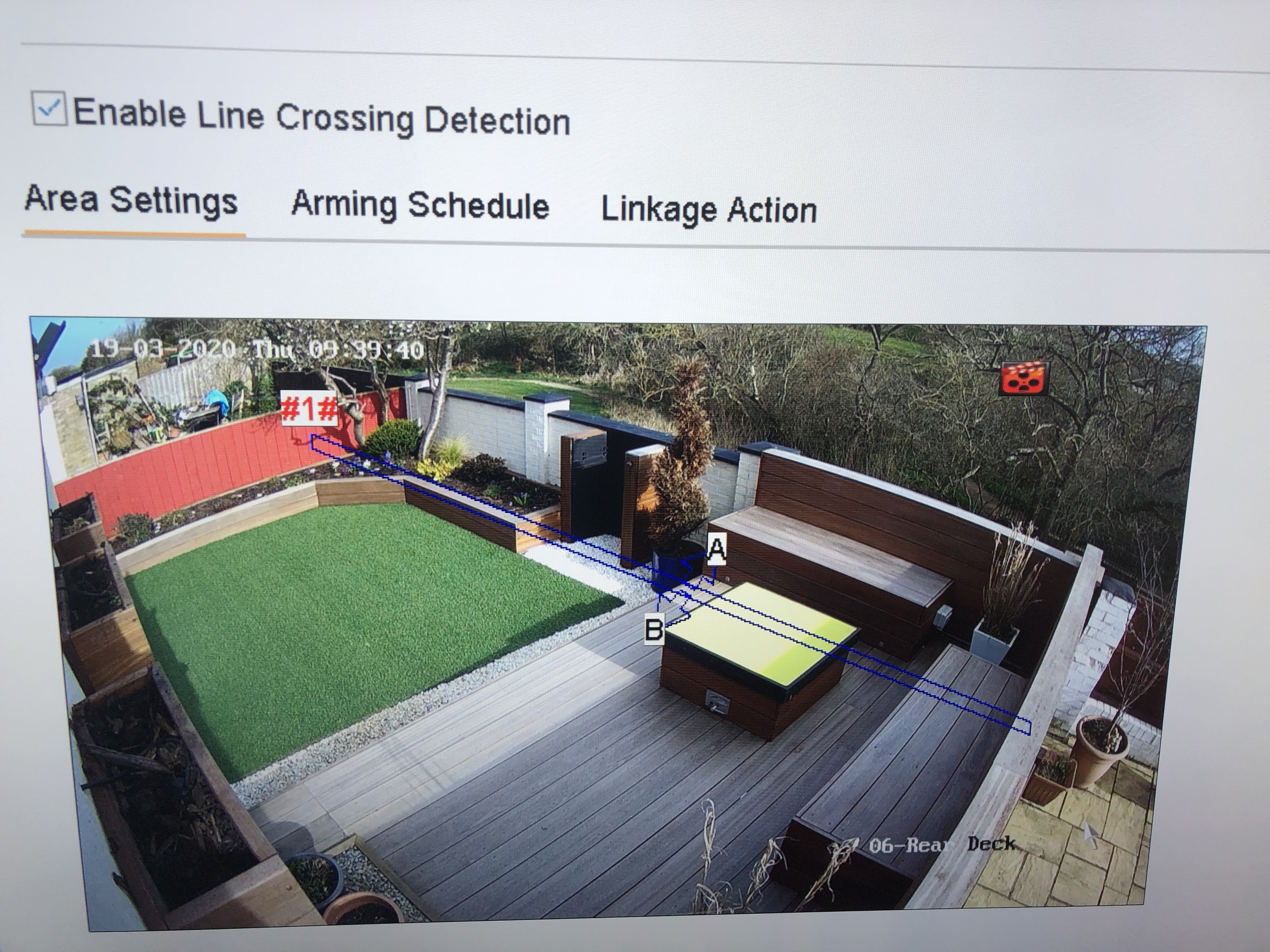

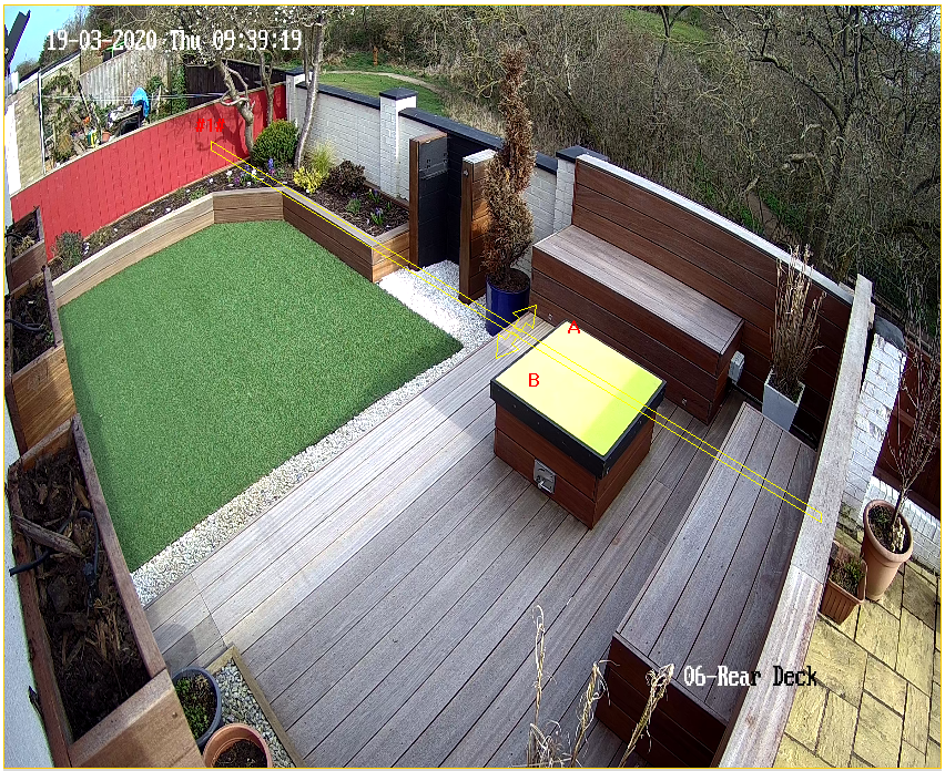

I came across an issue with line crossing some months ago and thought it was a one off with one of my cameras or the NVR. Unfortunately I've now discovered the same problem exists in other cameras with the G1 and G1+M firmware.
The issue is that the A and B direction on the line crossing gets reversed and does not behave as expected. I first found this with a DS2CD2385-FWD-I running V5.6.x firmware connected to a DS7608NI-K2/8P NVR running 3.4.104 firmware.
I've now found the same issue again. This time it's a DS2CD2346G1 (Acusense 4MP turret) with firmware V5.6.4 connected to a DS7616NI-I2/16P running V4.22.005 firmware.
I've attached pictures showing the issue. The NVR local GUI and Camera web GUI shows A above the line and B below whereas the NVR web GUI shows it the other way round. It seems to "flip" the A & B sides once you rotate the line passed a certain angle of rotation, but this isn't matched throughout the local, web and camera GUI so you end up with a mismatch.
So which is correct......
