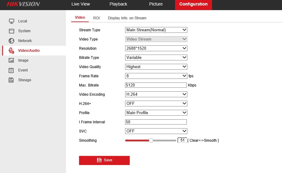

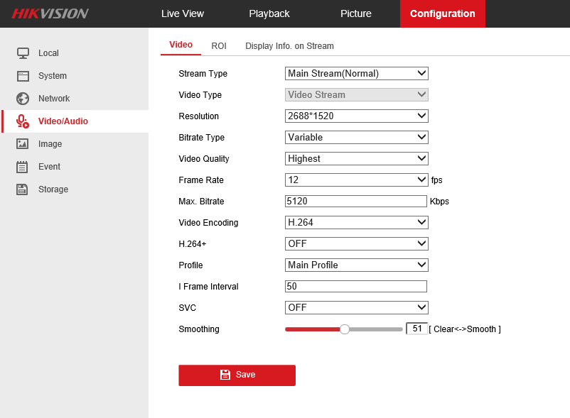

Can you post screenshots please of the video settings of both cameras?
