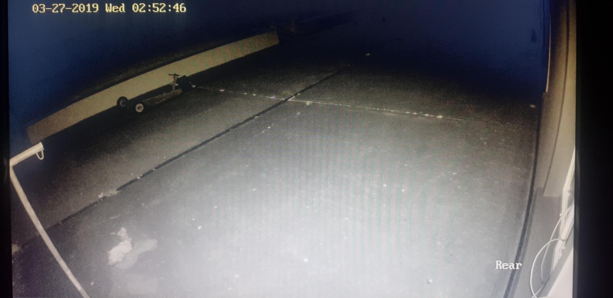

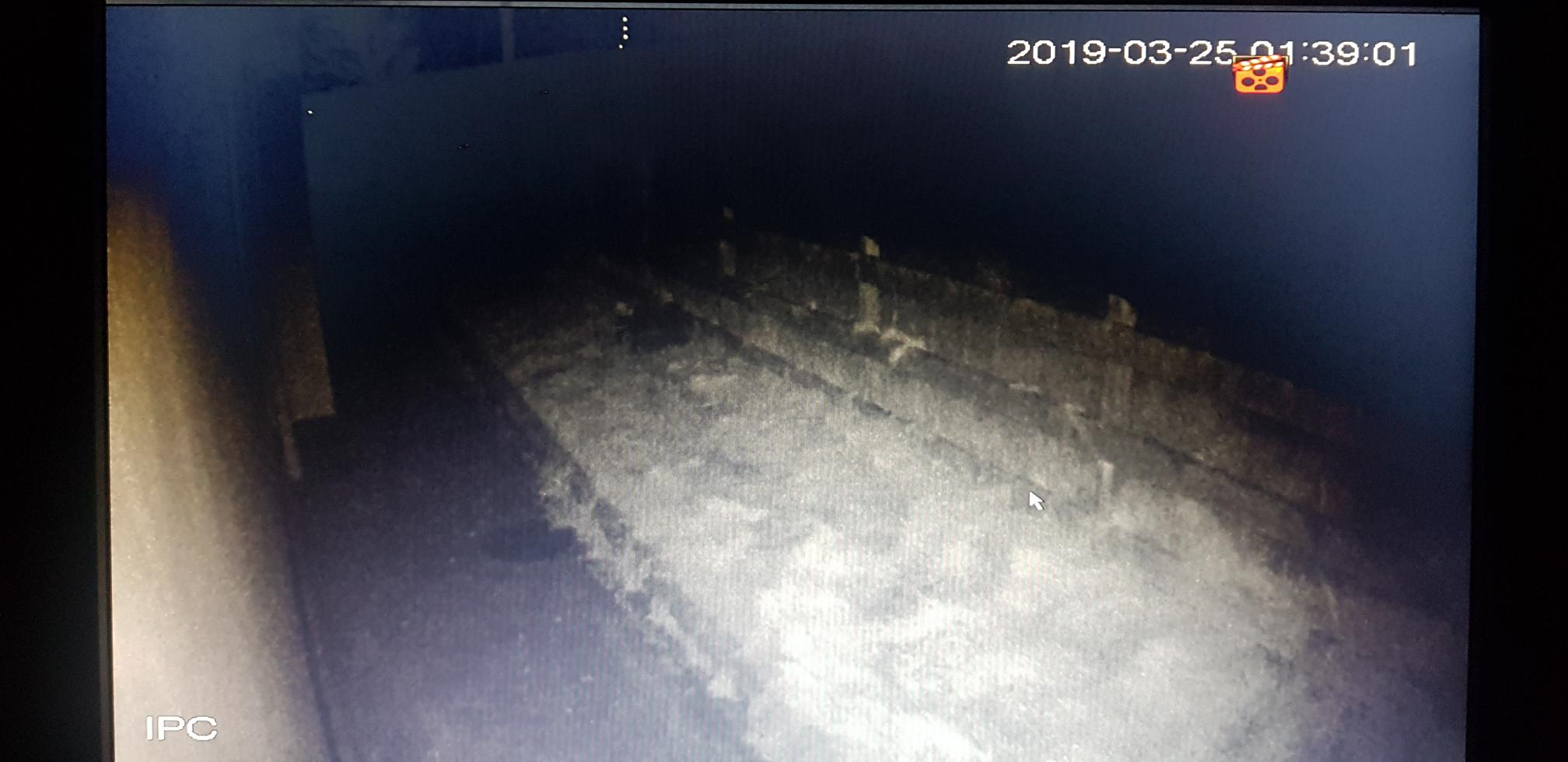

However I had a quick play with the system last night and I'm far from impressed. I didn't connect it to the internet yet but I just plugged 2 cameras into the NVR and connected the NVR to my TV via HDMI. The pictures inside were OK but not overly impressive either, quite grainy. But the night images were very fuzzy. Compared to videos I've seen of that system on youtube it's terrible.
Am I doing something wrong? Is it just not a great system?
For some more background - I have an absolutely horrible internet connection at this stage, about 3mbps down and 0.3 up. However I'm getting fibre installed in the next few weeks so I'll be on a 150mbps package. But i understand that the broadband issues will only affect what can be viewed remotely so last nights offline testing was definitely disappointing.
If I've been "sold a pup" then I'll be sending the whole lot back and any recommendations would be appreciated. If the system is fine and I've just not fine tuned the settings then any help or pointers would be great too.
Pictures below. Bear in mind that these are not screenshots, just photos taken on my phone of either the TV or the current monitor, so the lines etc are to be expected. But the grainy image is more concerning.

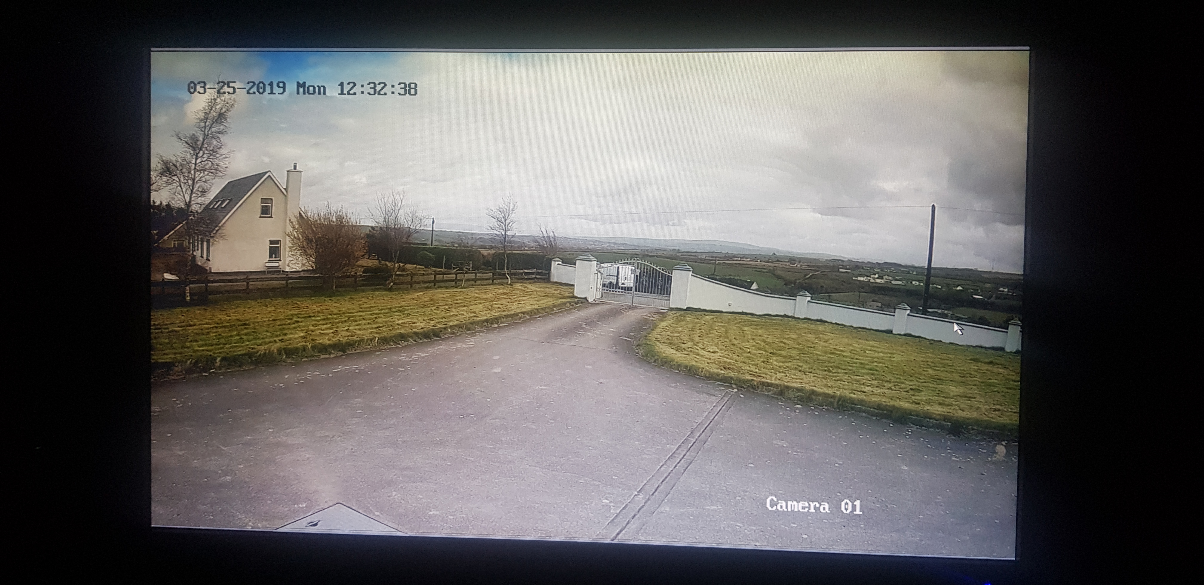

And this one is this morning in daytime. Still very grainy and not what I'd expect of a 4MP camera.

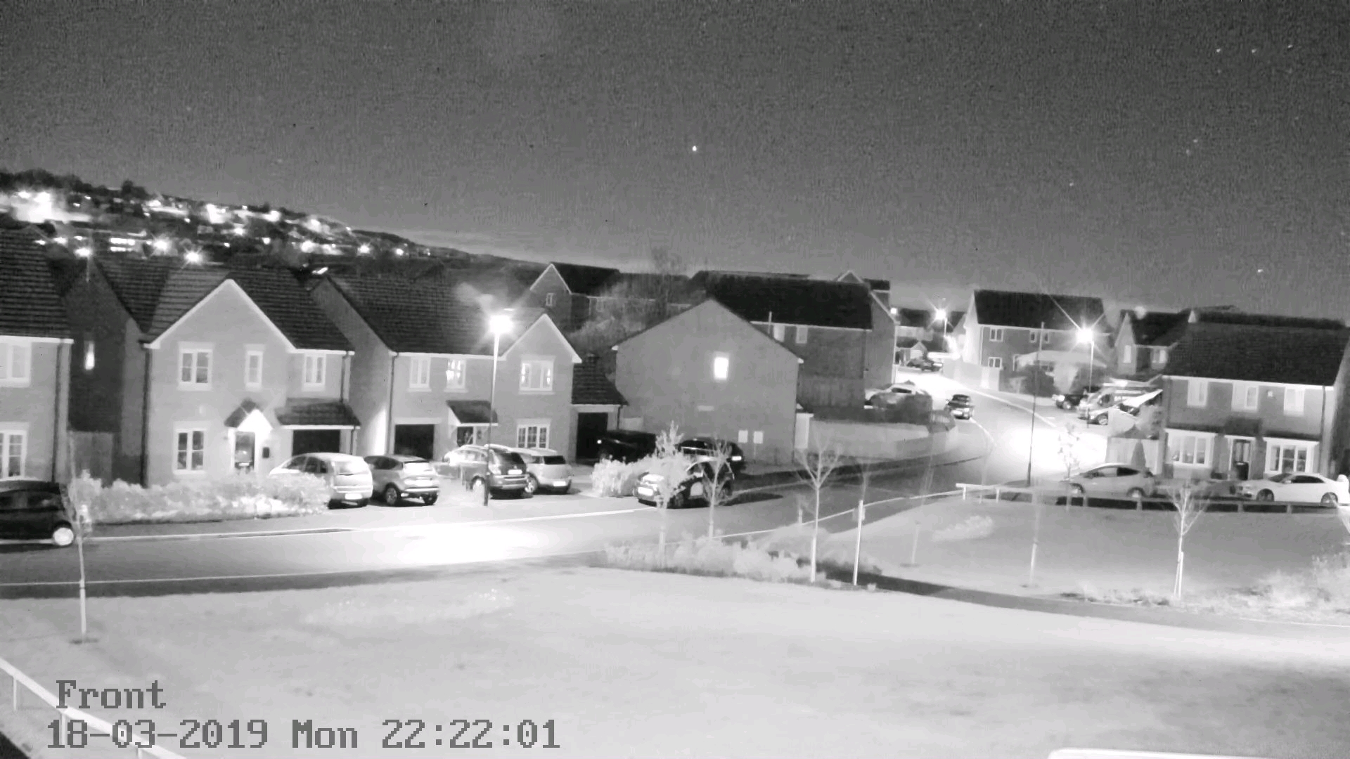

Heres one of mine from the other night , just popped latest firmware on then captured this with my PTZ...

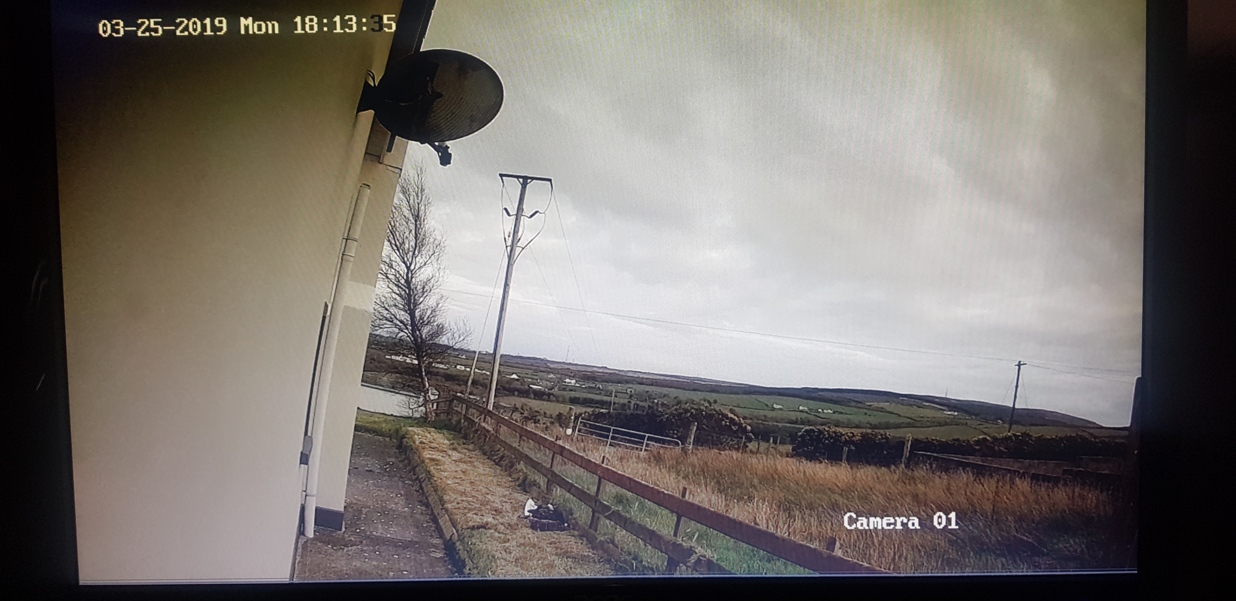

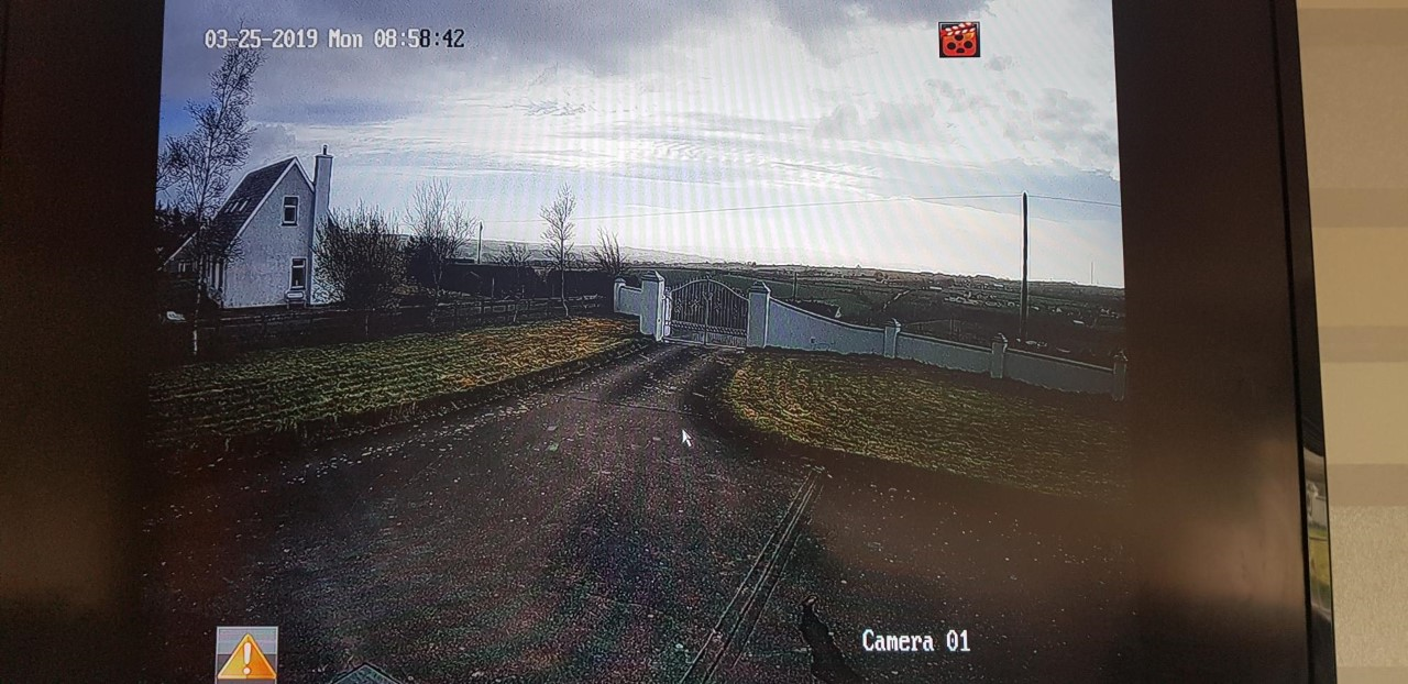

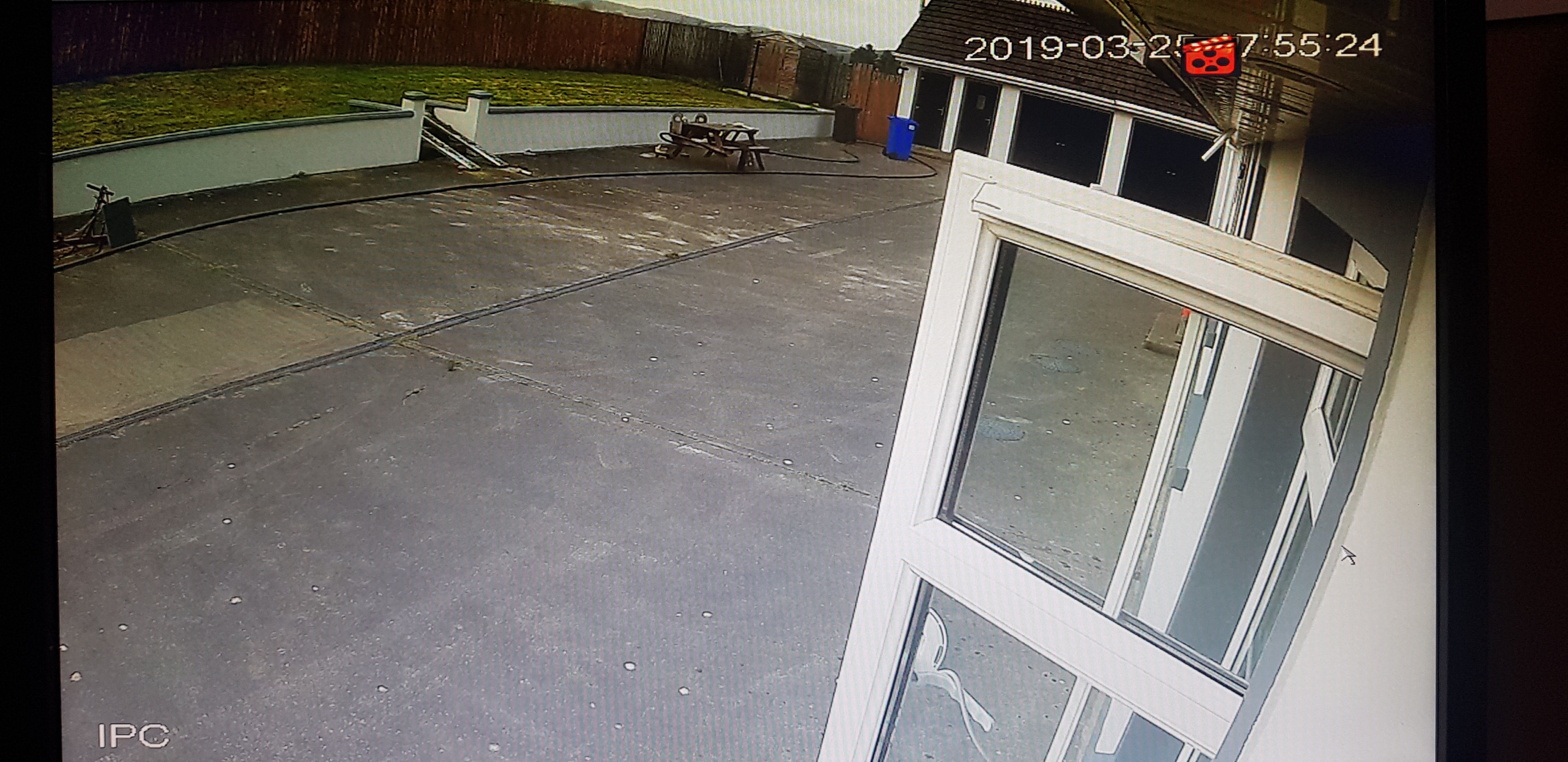

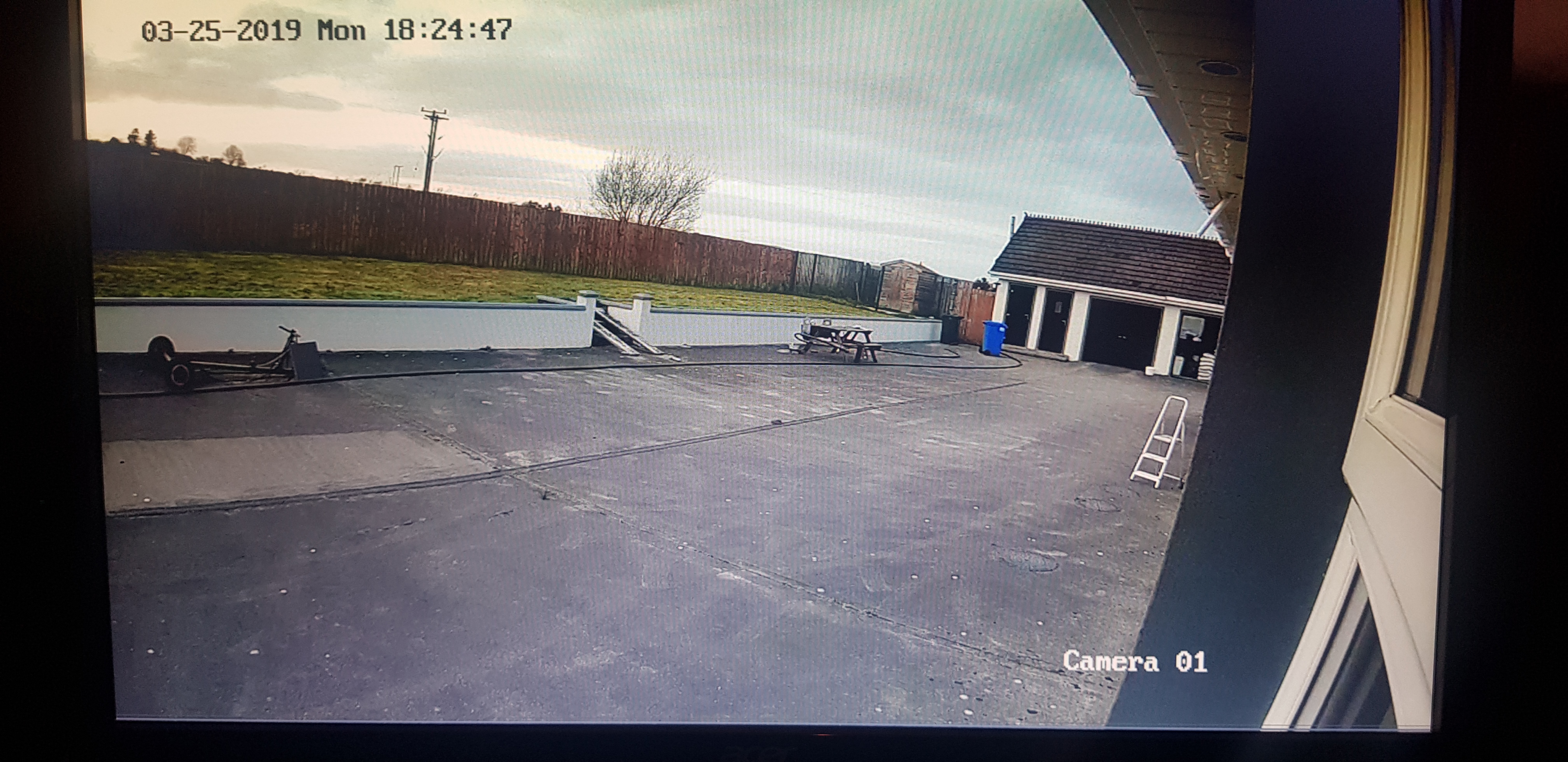

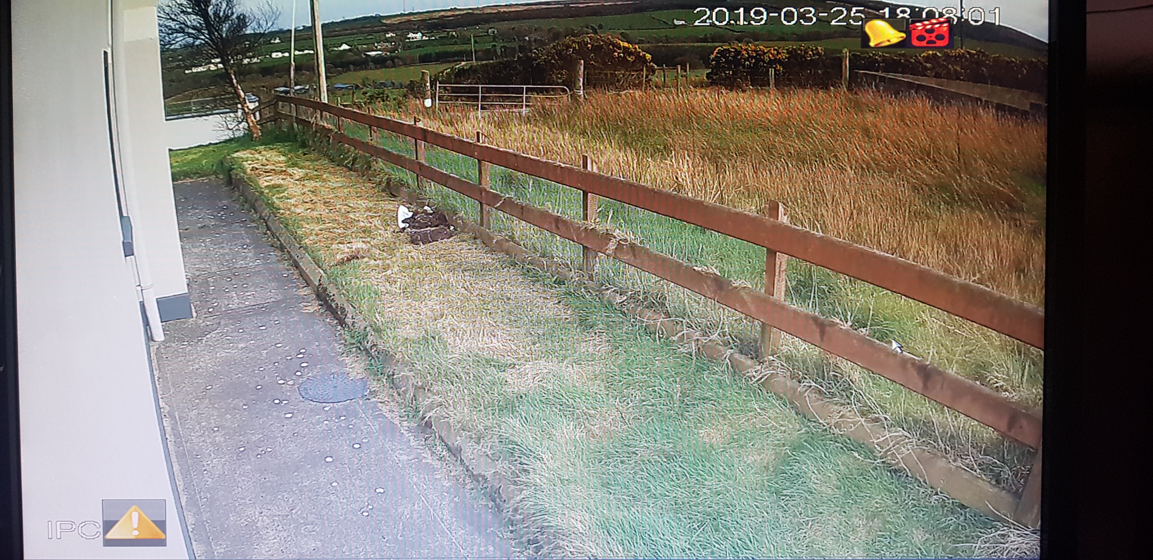

Some side by side pictures, using the same monitor, old system vs new system.
Old
New
Old
New
So not a massive difference to be honest. I'll do a similar comparison later when it's dark but even if they're as close in quality as these daytime pictures, there's no sense in spending £500 to have a newer system and the same quality of image.
I'd rather either keep the old system, or spend more for a real improvement.
Is it a case that my fuzzy image is because its pitch black? Your view there has a fair bit of light. Street lights, houses etc.
My fuzzy image had no ambient light at all as I live in the countryside and there were no outside lights on.
I did some night tests tonight and the results were much different.

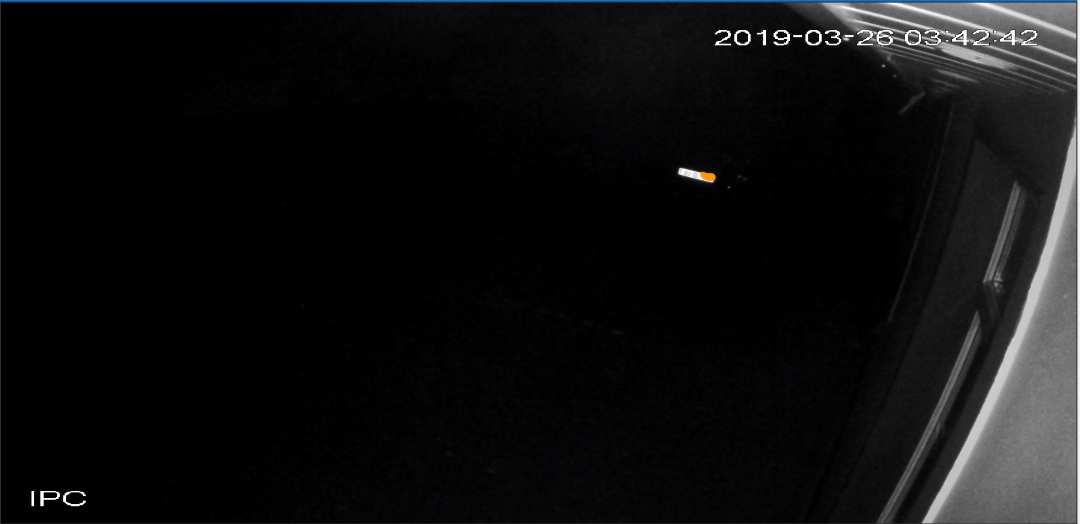

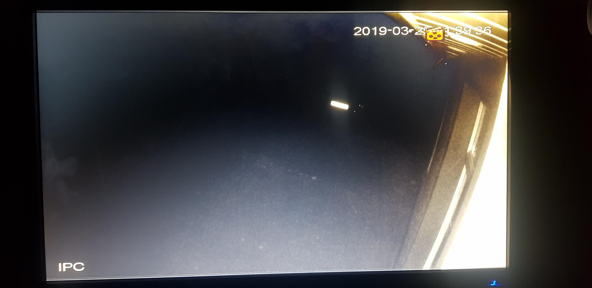

This picture is from my old system. When it's dark, it's just dark. Only thing showing is the reflection on the car license plate.

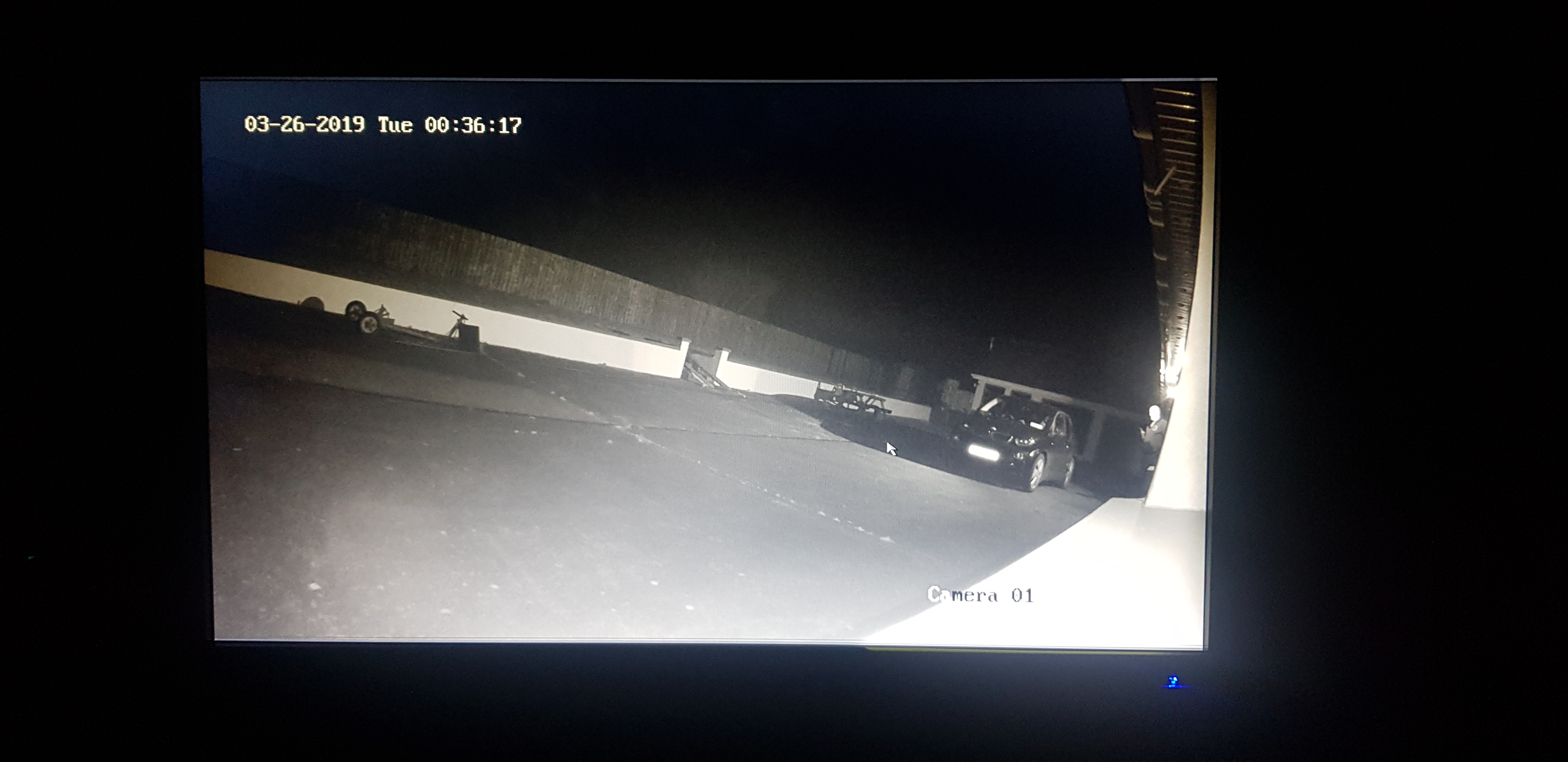

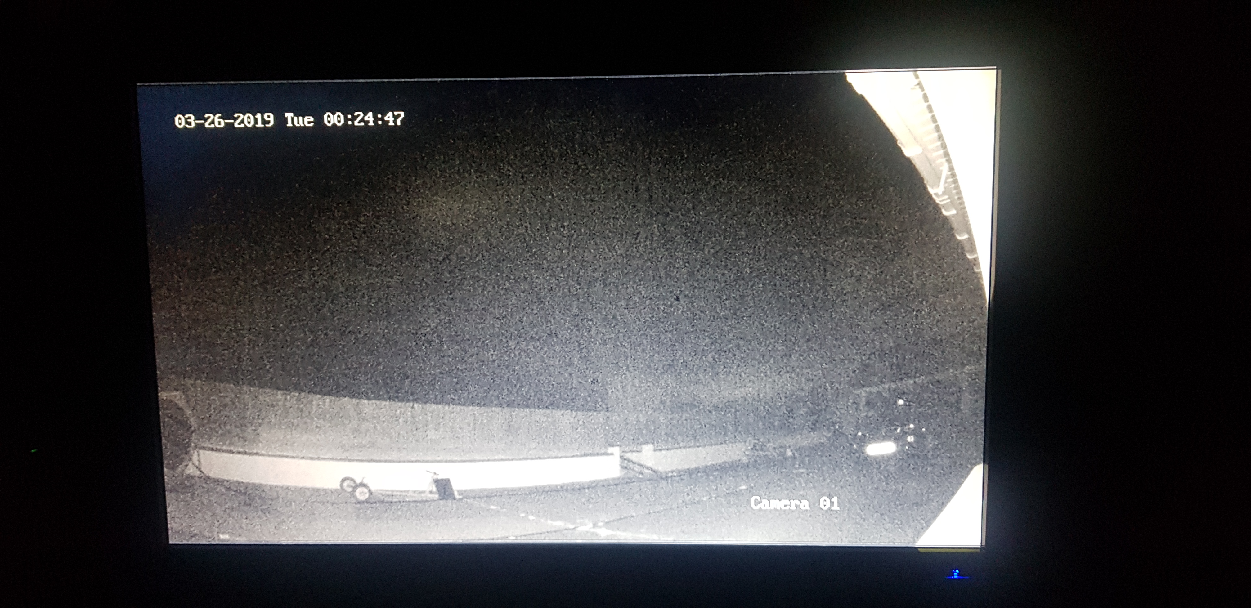

This is with the new camera. Grainy image, but even with no light at all I can still see the yard, fence, boat etc.
And when the outside security light came on the image was actually very clear.

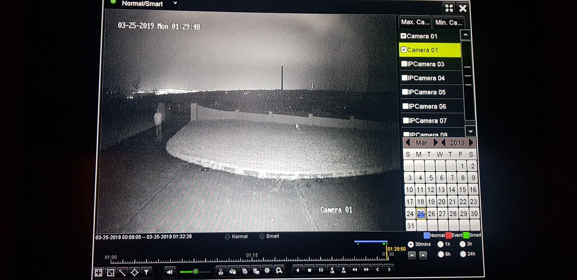

I also went back through and checked the recordings from the day. This looks a lot better than my side by side shots later.

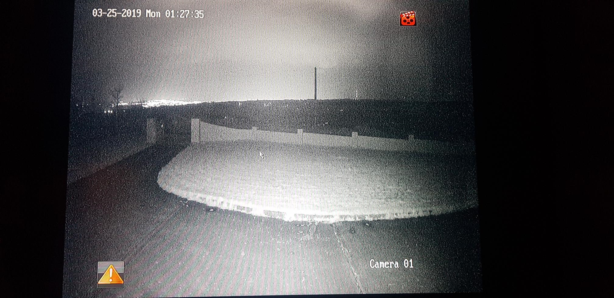

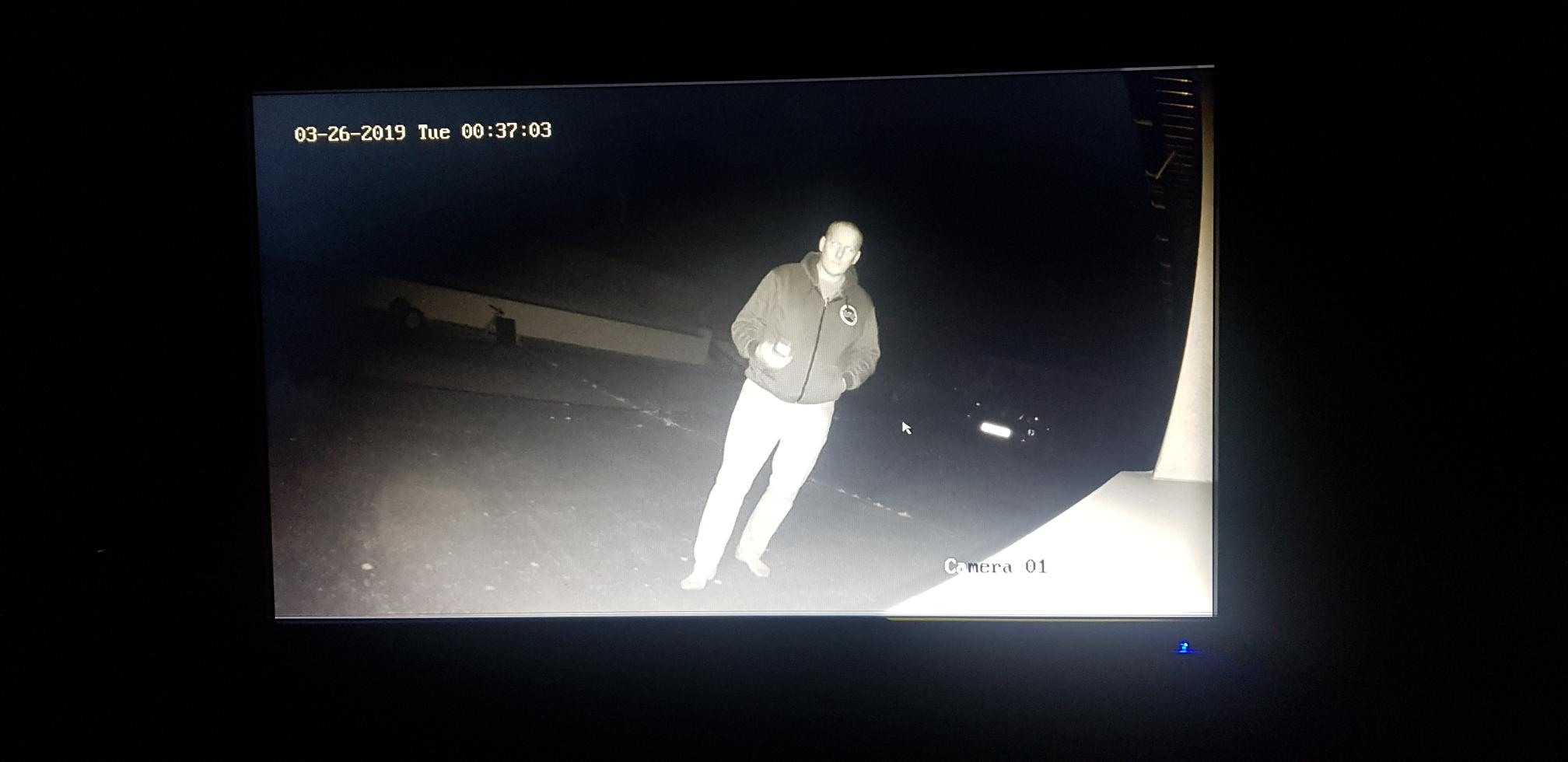

He said that the reason for the overly fuzzy night vision image is that the camera is pointed much too high, and as a result the IRs are pointing into the sky. For example these 2 pictures are from the same new camera with a bit of ambient light, but first time it is aimed high and the other I had adjusted it down a little. It's a different outside light on, the far end of the yard in the first one and the back door sensor light second time but a major difference in the image quality.

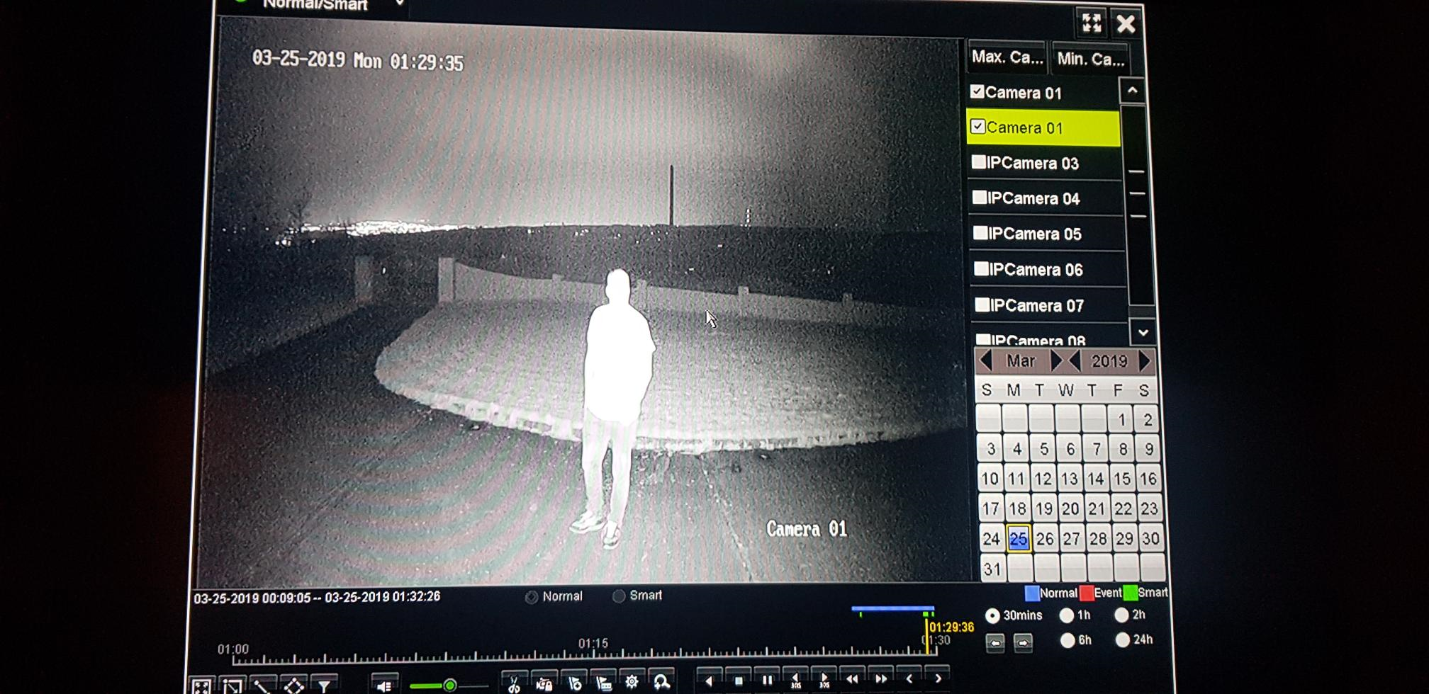

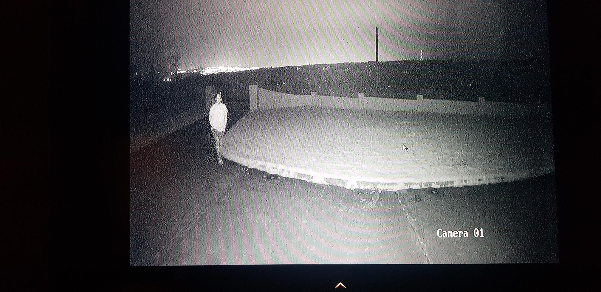

And here it is in complete darkness with no outside lights on. First one it is aimed too high, second with it lower down. The detail is actually pretty clear as I approach the cam. Again neither outside light is on at this stage.

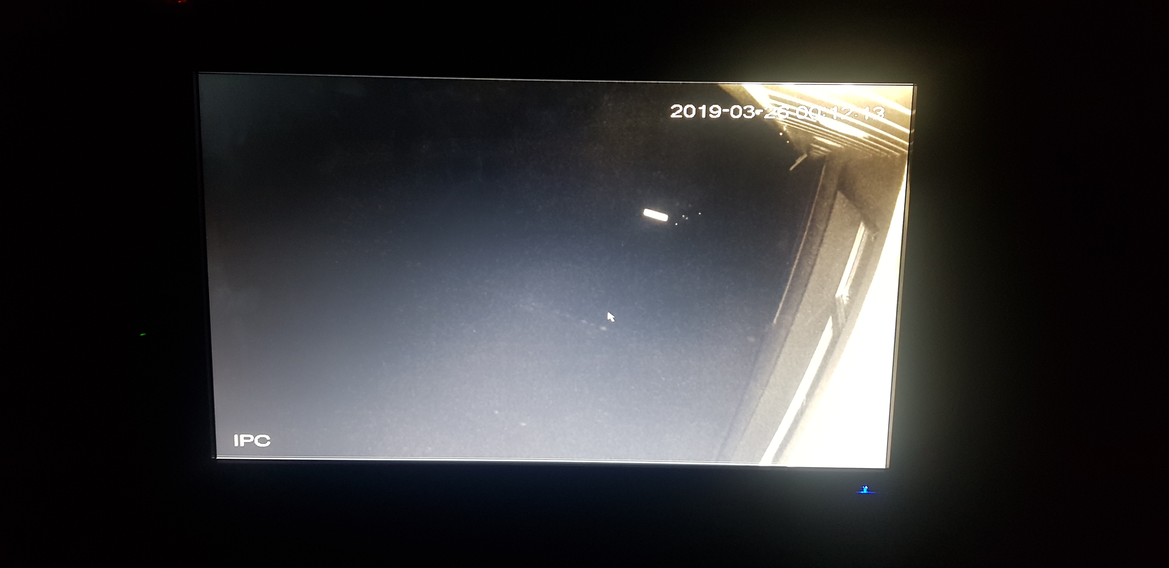

And compare that last image, pitch dark - person and rear wall visible, outline of the car - with this pitch dark image from the old camera: not as clear and nothing visible apart from the number plate reflection. (the side of house appears yellow there but that's just an effect of the phone camera picture).
So what's your thoughts @Phil and @pyrotenax ?
Have I jumped to conclusions? Is a little adjustment all that I need to clear this up to a good level?

First is the old camera - very dark, not great night vision, only the car plate although it can be read
Next is my first attempt with the new camera - too high, very grainy due to IRs pointing to the sky and too much of the building showing
Third is the new camera - lower down and the best quality so far, despite the glare from the window sill
Finally last night's attempt - probably a little too low as I can't see the garage at all but less sky and less building, yet the previous picture is probably slightly better quality with less grain.
So any ideas why the mid height image is better quality than the one from the most recent one, even though it had more building reflection and more sky?
At least I can safely say that the quality can be achieved, as the picture with me in it is definitely sufficient quality for me to accept. But I'm just lost as to how to best position it to achieve that quality.
