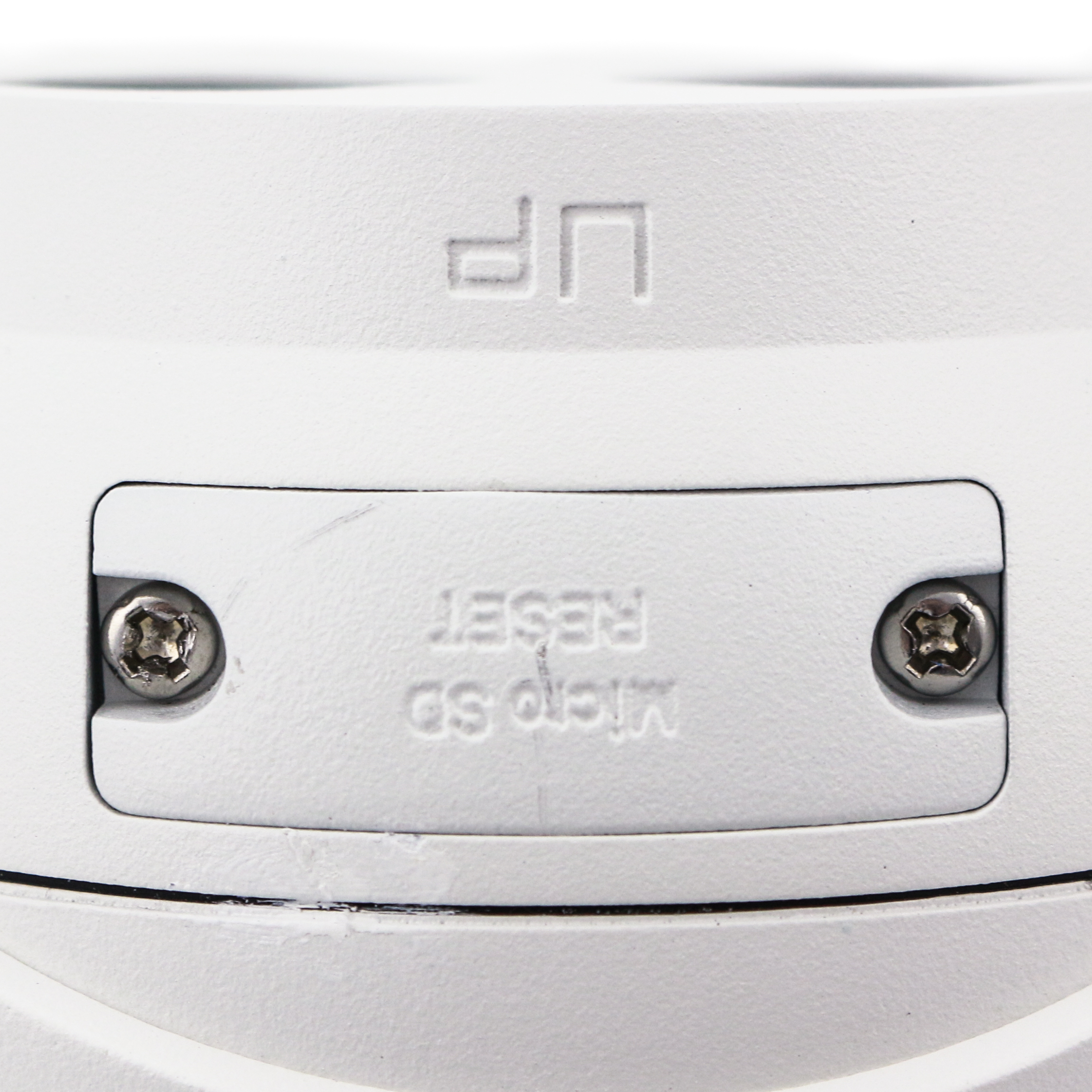

No, how do you do that?
If they are 23x5 or 23x3 Turret cameras then you can find the hard reset button under the MicroSD cover (shown below), you may have to rotate the turret ball quite a bit to access this cover.
2002
Once you have access to the reset button you will want to disconnect the camera from the power, then hold down the reset button, reconnect the power and continue to hold the reset button for a further 10-15 seconds. The camera will then reboot and after about 30-60 seconds the camera will either appear on the network as inactive (if you have the camera connect to a switch) or it will appear as active on the NVR camera config page (if you have the camera directly connected to the PoE ports on the NVR).
