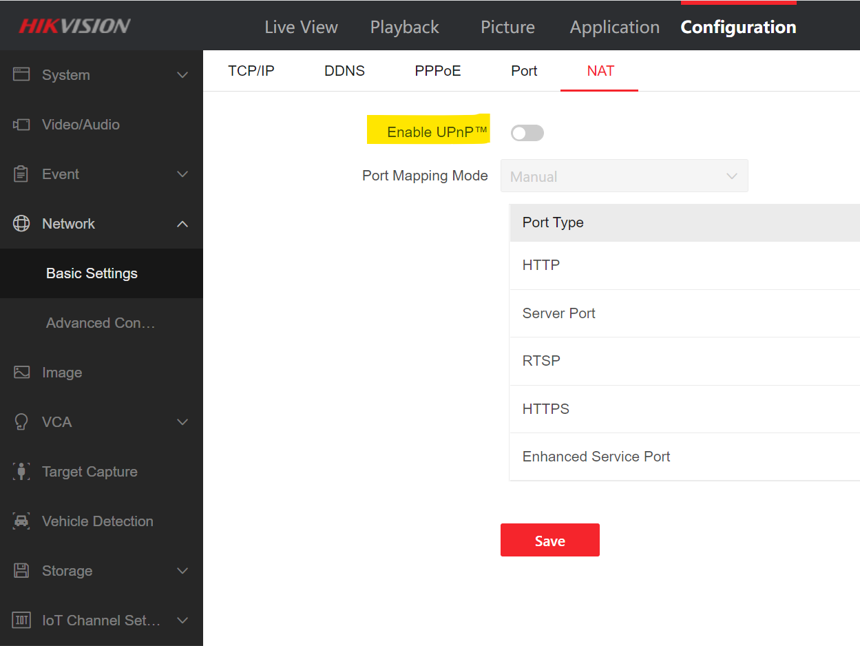

I think this was quite a common issue with iVMS-4500, which is no longer supported as Hikvision has replaced it with Hik-Connect, so you're probably best adding the NVR to the newer app if you haven't already, as you do not need to set up DDNS or port forwarding for it to work:
To get the camera showing again in iVMS-4500, you could try disabling and re-enabling uPNP in the NVR's web browser interface, which has apparently solved the same issue as others - go to:
Configuration > System > Network > Basic Settings > NAT
Updating the firmware may help too (and always recommended), this is where to find the latest version - V3.4.98 build171121
I don't believe that there are any major changes to be cautious of, but there are release notes for some of the versions in between if you check each in the above link, which explain some of the changes/improvements.
