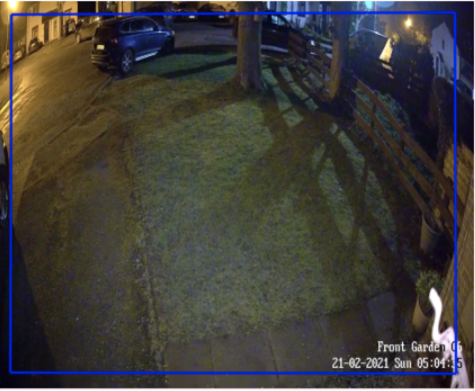

The colorvu led is on (low level) from dusk to dawn. In the image below you can see the level of ambient lighting I have, Intrusion detection will pickup hedgehogs crossing the lawn at the far tree. I also use High Light Compensation (HLC) to reduce the impact of car headlights, HLC also darkens the image.
I get good colour video and pictures of anyone close to the house, face is easily recognisable.
Since taking this picture the lefthand streetlight has failed and detection performance has hardly changed.

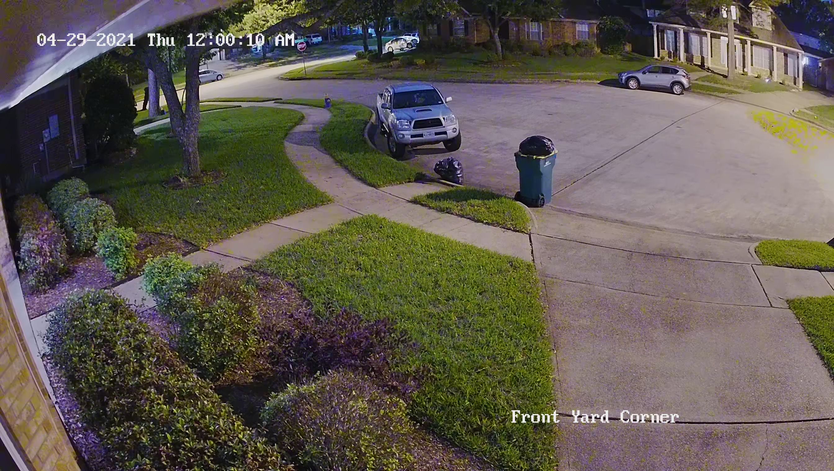

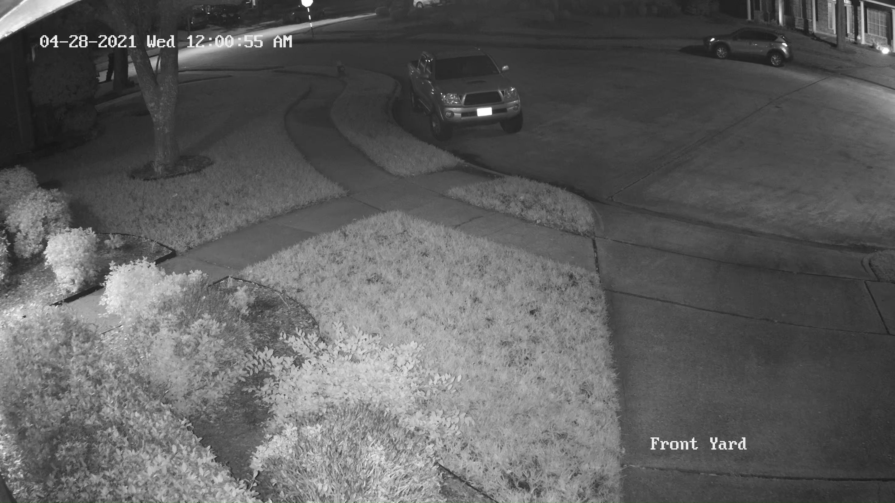

Andy, maybe these images will help. The first pic is from a 2355 5mp at midnight, with a streetlight about 100 feet to the right:
This picture is with an older 2347G1 4mp at midnight. Huge difference. I would assume the G2's are even better.

That is brilliant. Thank you both for your comments and images. The 2347 is impressive!
