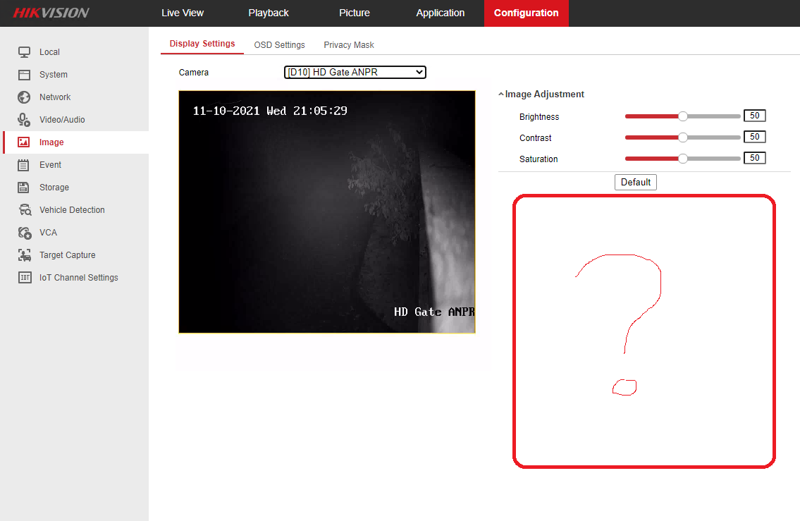

However back on the NVR I am still missing the detailed Image settings - see picture below? Not a big problem as I can log into the camera and adjust but annoying
Normally there would be settings like exposure and white balance etc? Cameras are connected over a 1GigE network - not via the PoE ports. Have I set them up incorrectly on the new NVR?
