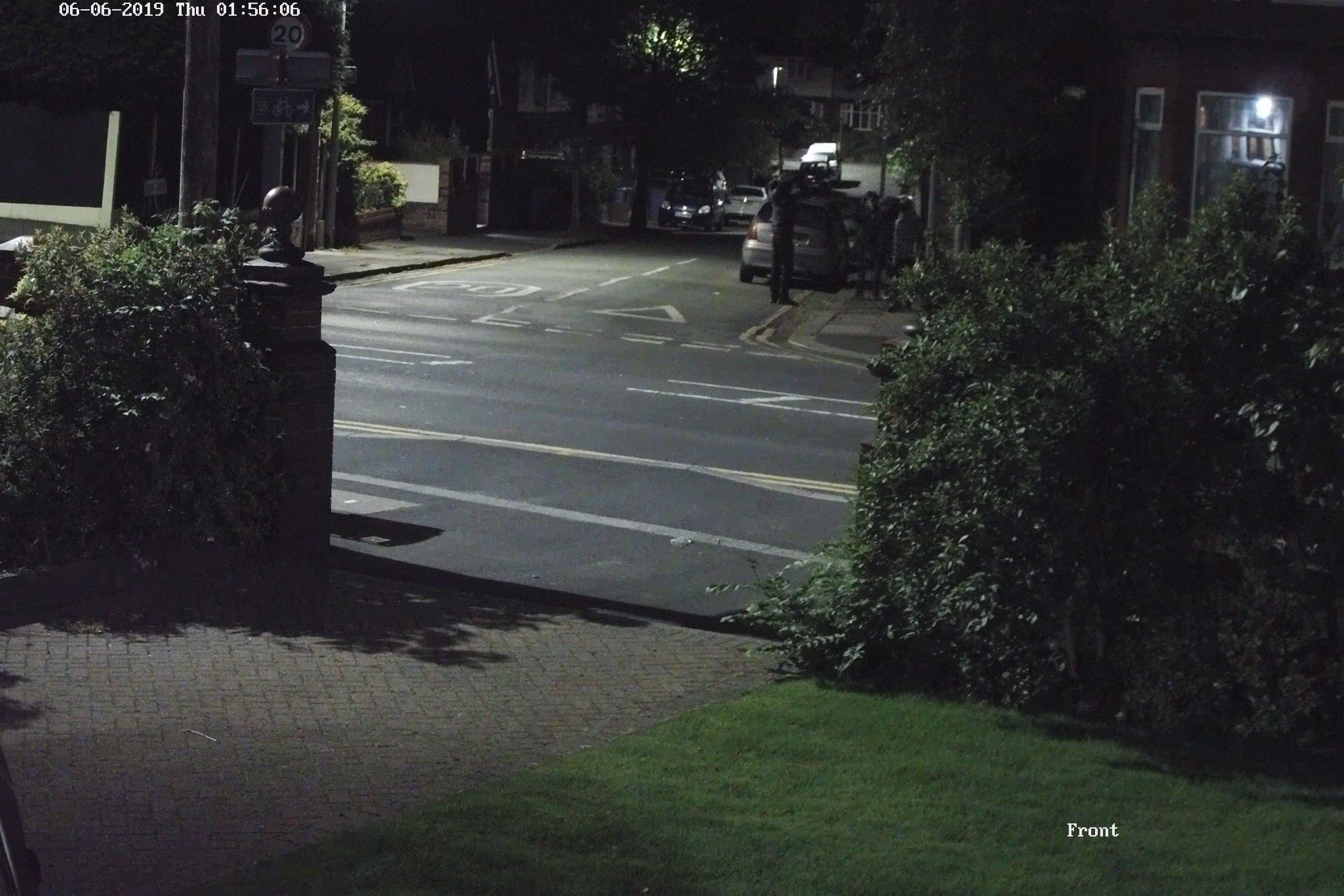

i have a need for an IP cam for low light night time to pick up facial images as we have a vehicle crime issue on regular basis.
i have hikvision kit currently. Unfortunately the location has bad street lighting , trees etc and i cannot project led lighting over a busy public road to that distance. ive measured out and need a cam that can cover circa 40 metres distance and a that range cover an area of 2 to 4 metres wide
i currently have a hikvision DS-2CD2755FWD-IZS dome on the target area zoomed in - specs are
  • 2.8mm to 12mm varifocal lens.
  • Image Sensor: 1/2.9" Progressive Scan CMOS.
  • IP67-rated for outdoor deployment.
  • IR 30 metres night vision: 0 Lux with IR.
  • Video Compression: H.265+.
  • Wide Dynamic Range: 120 dB.
i run the above camera in colour , and no IR, 100% gain , 1/6 shutter speed - which i think means i lose the detail and get ghosting.
if i switch to BW and inbuilt IR there isn't a dramatic improvement, so probably time to find something more suited with a longer optical zoom lens,( so im not relying so much on digital zoom and better CCD sensor.
The camera doesn't need to be hikvison, or have any smart features like intrusion detection or line crossing, just IP /onvif and so i can record onto a hikvision NVR on a 4 hour window every night..
The bad guys are usually hooded up, but as they walk up a hill i get decent facial pics in the day , ( good enough to secure convictions) , its just really poor at night. I'm in the UK.
