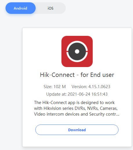

We will want to let you know that the problem has been resolved. Our engineers have released a new update to solve the restart technical issue affecting ERI-K NVR EXPRESS VALUE KITS. The new version, 4.15.1 of the Hik-Connect app, has been tested and is compatible with iOS14.6 search LAN devices. The new patch is available through the App Store for iOS users. Android users can access it through the QR code below.

From their website by this link:
Hik-Connect - for End user​
Android
4.15.1.0623(117) 2021-06-24 16:51:43
