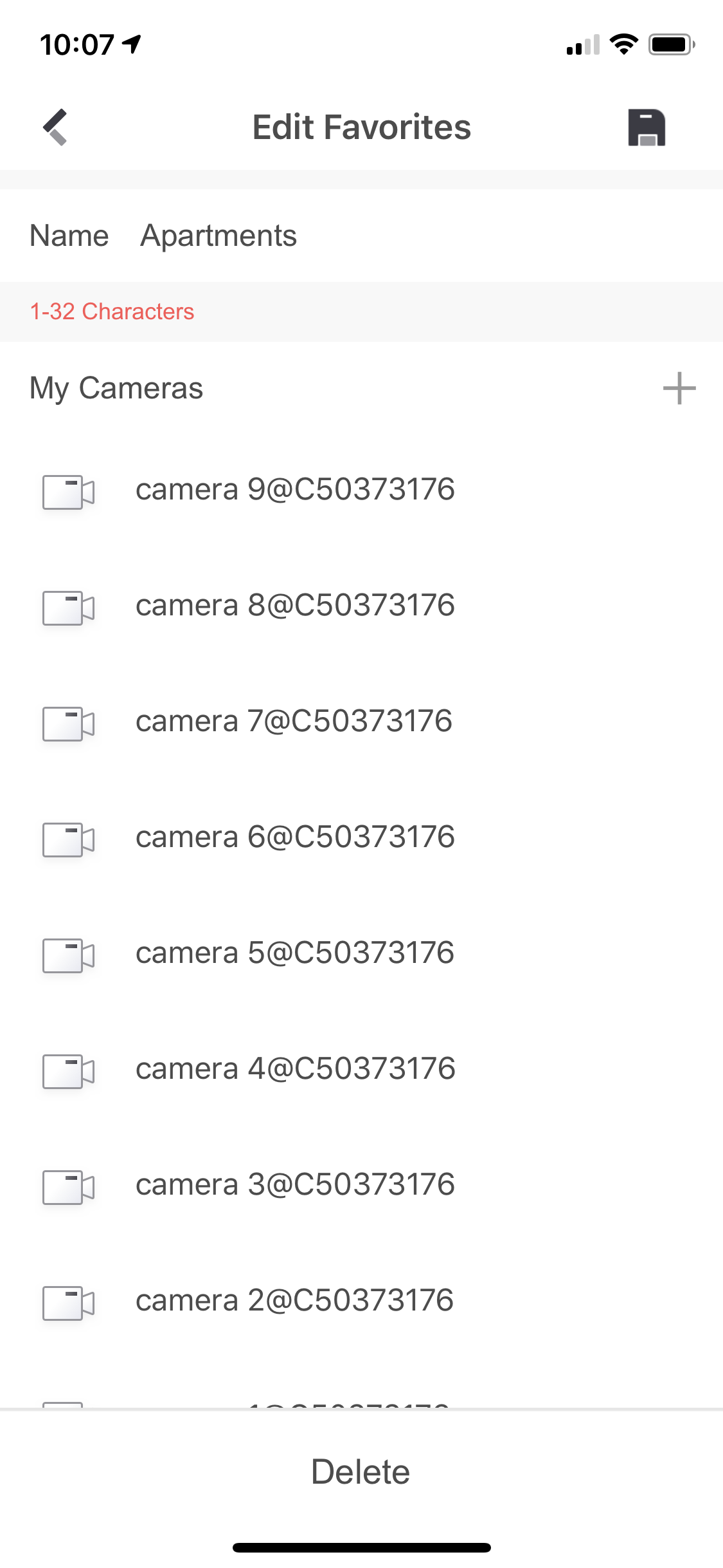

Hi,
I'm using Hik-Connect on IOS (the latest version).
I have a number of different Favourite folders set up.
When I click on any of the folders it brings me in to a list view of the cameras (it's an 'Edit Favourites' view).

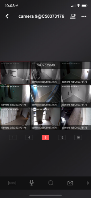

If I close and then click again on the same Favourites folder it gives me the 'Camera View'.
It's a real pain as to view my favourites I need to click in, leave and click in again.

Seems like it brings you incorrectly into an edit view rather that just a viewing mode...

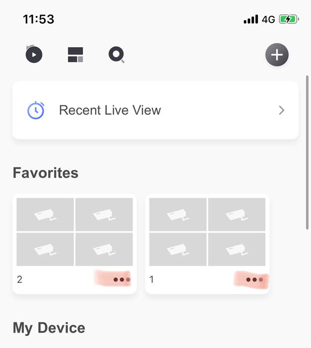

I have tested on my app, and it will jump to the edit page if I click the left bottom ‘…’, and will directly go to the favorite channel if I click the center point.

No, if I click center I get the edit mode.

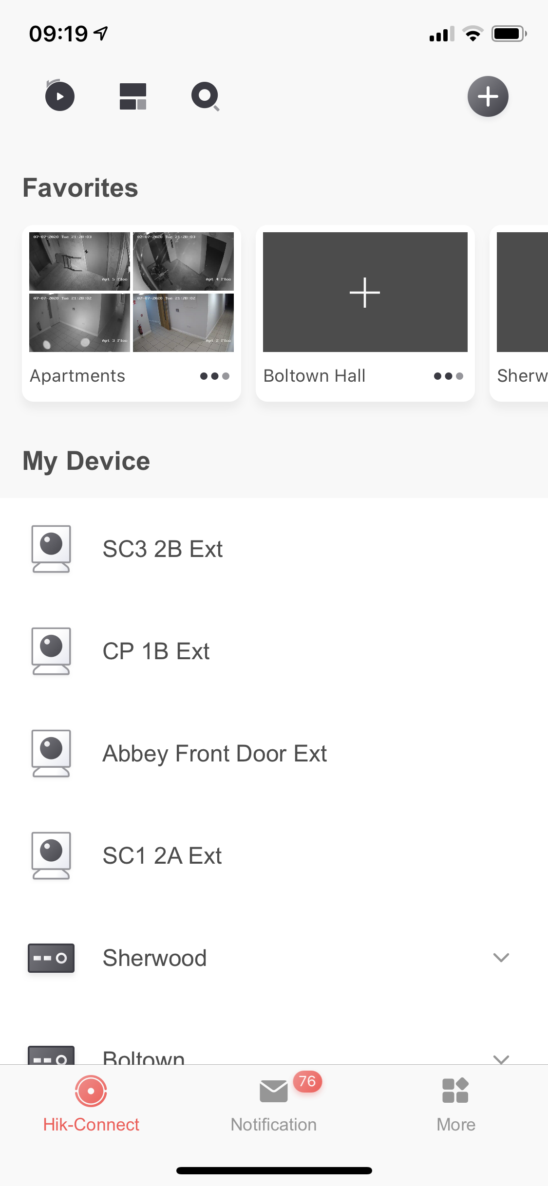

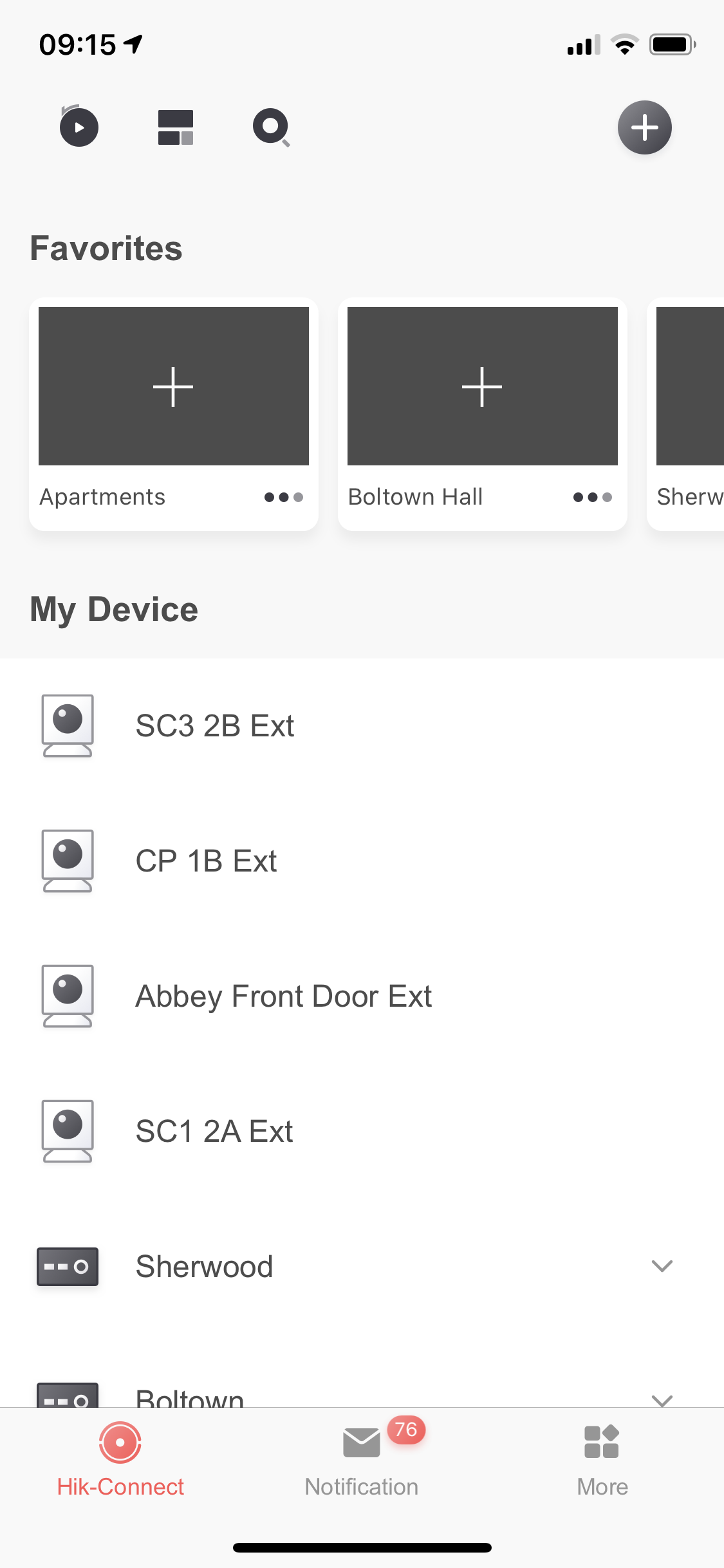

Also don’t see the thumbnails before I click the first time, only after I click in to edit and then exit. In the attached you will see that I have the ‘+’ and not the thumbnails.

justinowens
9
Here is the second time after I click in the first time. You can see the thumbnails now.
