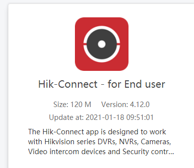

Are you running the current latest IOS App (V4.12.0)?
Available here:

I downloaded a version today V4.12.0.955687 on iPhone 6s
This version has the problem (all cameras show "The device is offline")
