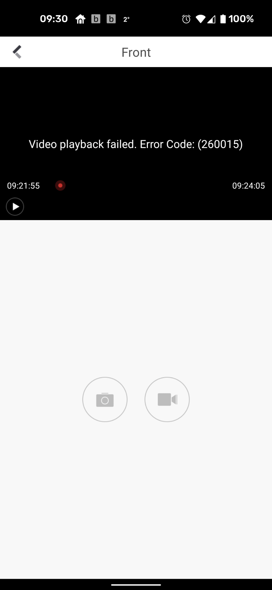

hi All,
Just purchased a hikvision DS-2CD2347G2-LU 4 MP ColorVu Fixed Turret Network Camera. I have it setup for notifications sent to the Hikconnect v4.11.0.1204 Android and i`m receiving them fine and it displays an image on my phone notifications, but when i press the option to play it goes to about 80-90% and then just stops and eventually i get a fail message , see screenshot attached.
The playback works if just run play on the camera via hikconnect , just the notification fails.
The only thing i can think is that when i originally tried it with the app it was working, and i`ve since been tweaking it over the week and updated the firmware of the camera. Could it be that at all? If so could i regress firmware version to the original to check. Unless there is something else it could be.
Thanks
