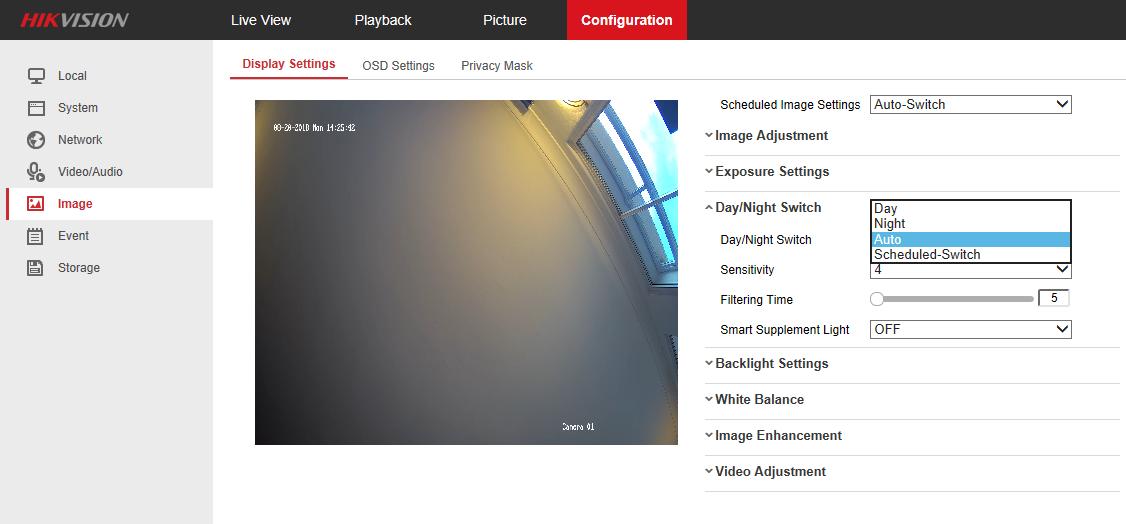

I have the 2385 turrets. I was wondering if I can turn off the night mode? Reason being. My streetlights stay on all through the night. I’m thinking if I can turn nightmode off would I get a better picture! That’s not black and white.
First day back after a week away.
Set to 'day' for colour all the time / no IR.

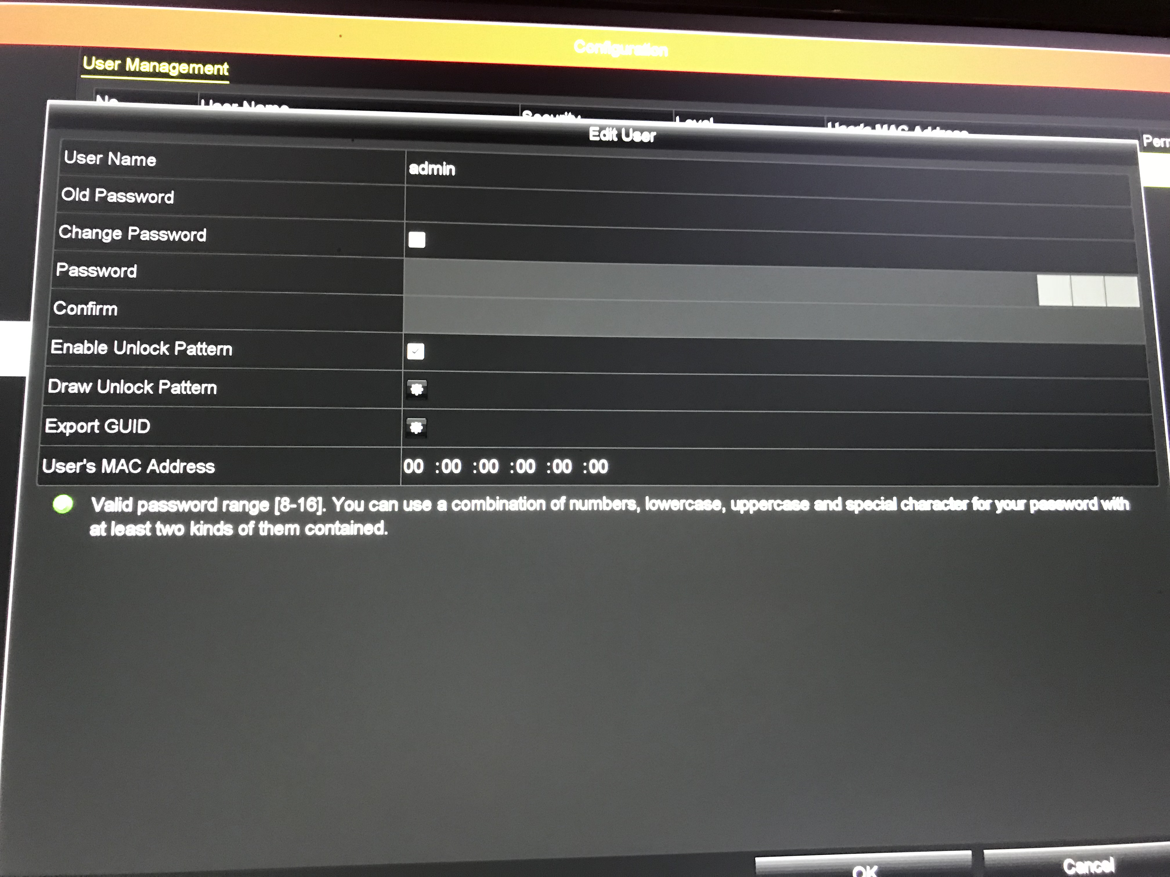

Ok mate thanks. I just put the ip address into web browser for my nvr. And I need a user name and password to log in online
Is this the user name and password I use to log in online with? It says admin is the user name. But I didn’t set the password either the installer did. Crap.

Assuming your NVR is connected to your network, and you have a PC on the same network, log into your NVR using Internet Explorer (not Edge).
Just type your NVR's IP address into the address bar, then login (user name is admin by default, password will be as you/your installer have set).
Then, assuming your cameras are directly connected to your NVR, follow the virtual host instructions at post #5.
This will provide you with a new column of links to your cameras from within the Camera Management area of your NVR.
You can then click those links to access each camera in a new browser tab and change its settings as per post #3.
