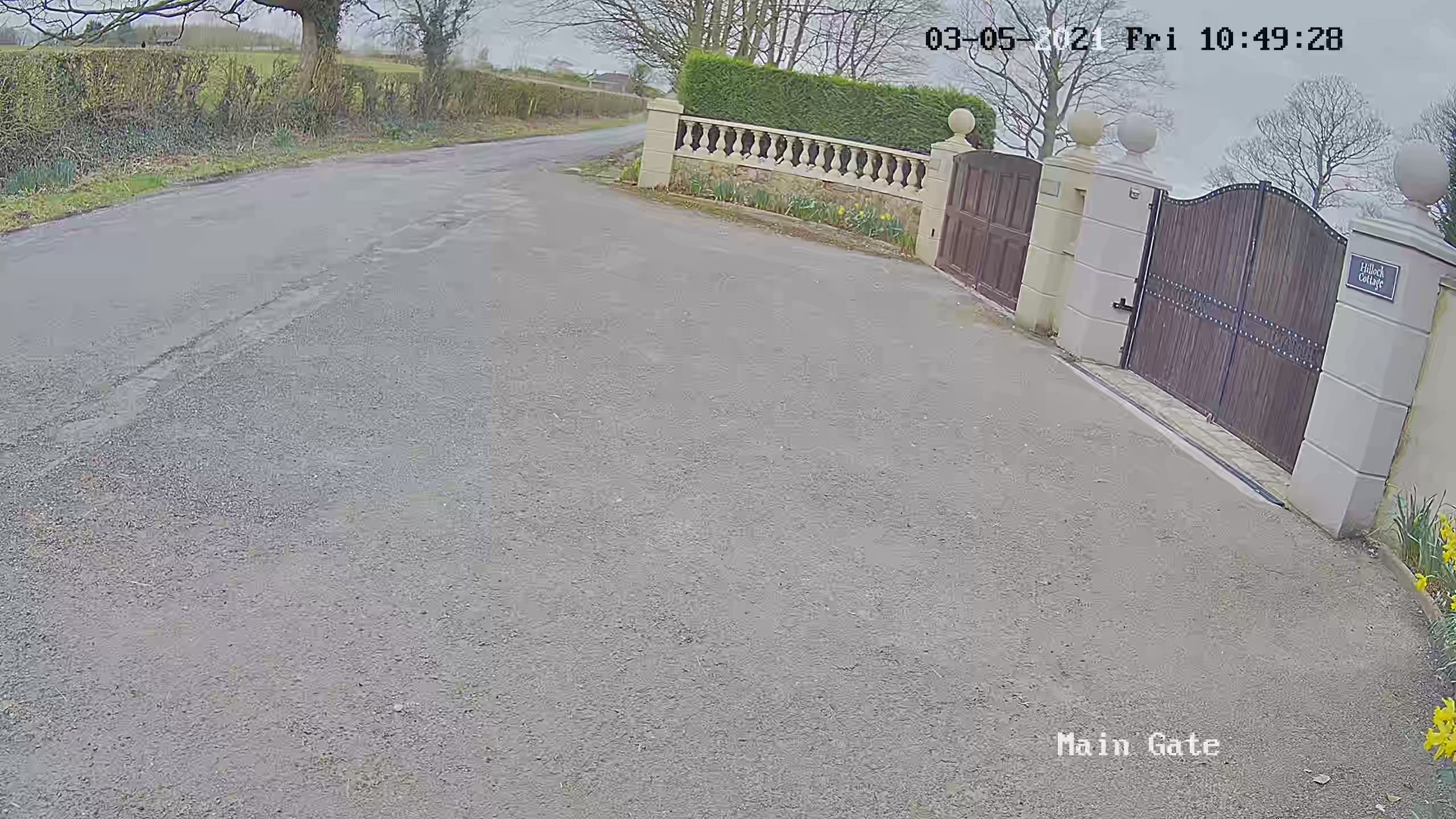

I have 2163G0 on wall near gate. Night IR is very poor (no street lighting) so am looking at 2546G2 given IK10 (it’s 1.6m from ground) and low light on G2 seemingly far better even tho 4mp not 6mp. It’s either that or I’m buying an ir illuminator.
ive tweaked exposure right down on mine which has improved it but nowhere near 30m of night view, even folk walking can blur at night, and fiddling with HCL, etc gave me minimal gain.
interested in your experience and will share mine if I make the jump.

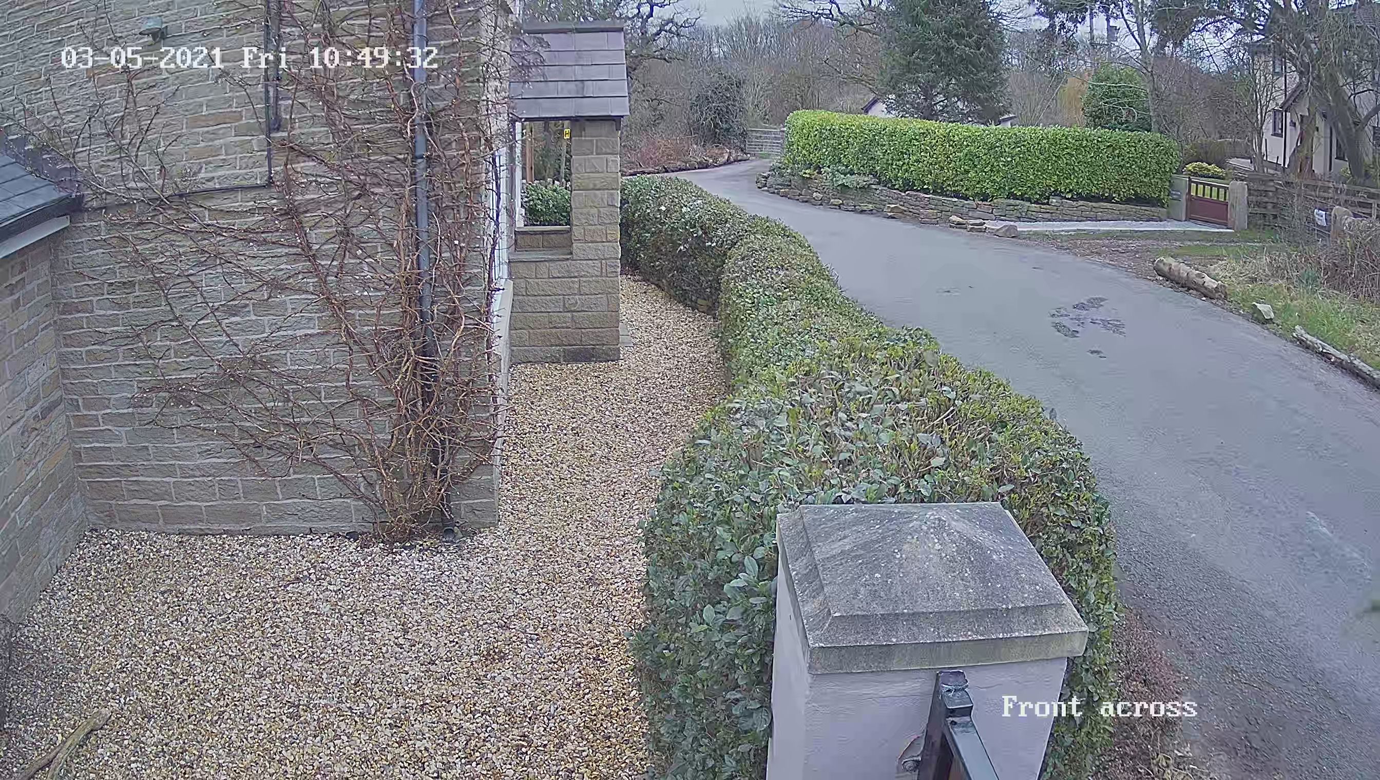

Good point on low light in the area however unfortunately the IR illuminator + camera is preferable given the camera location (see attached).
The annoying and interesting thing is that on the camera covering the drive/two gates is a 2163G0 with low-exposure set and at night i can just see the 2nd set of gates to neighbour, whereas on the other camera showing across the house in the opposite direction is a 2346G1 and i can see the far field gate!
Whilst i know the 2346G1 is 50m IR, I'm really disappointed with the supposed 30m on the 2163G0.
My thinking now is 2163G0 augmented with IR Illuminator or replaced with G2 mini-dome (needs to be IK10). @Dan any other options for G2?
And on the 2346g1 to replace with 8mb G2 turret (this is on a pole in a conifer on my property so less vandal access).
