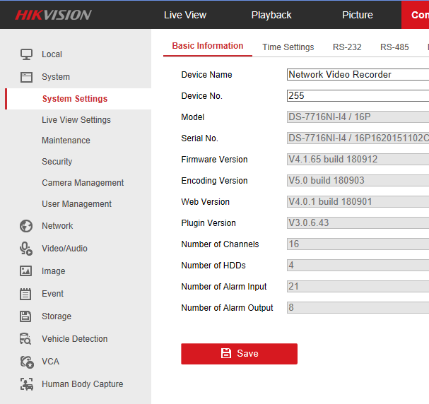

We are running V4.1.65 on a demo NVR here without problems.
(RAID not configured)
