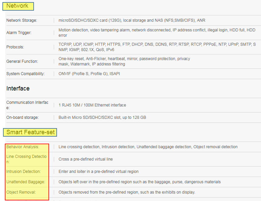

The best way to be sure the cameras come with the features you require is to look at the specifications or the datasheet for each product. Typically IP cameras have more functionality. Look under the Network>Alarm Trigger and Smart Feature sections.
The following is for a DS-2CD2025FHWD-I which can be found here: DS-2CD2025FHWD-I. Examples of analogue cameras can be found here: Analog Camera Turbo HD Camera HD720P Indoor Dome-List1-Hikvision
