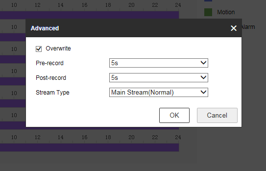

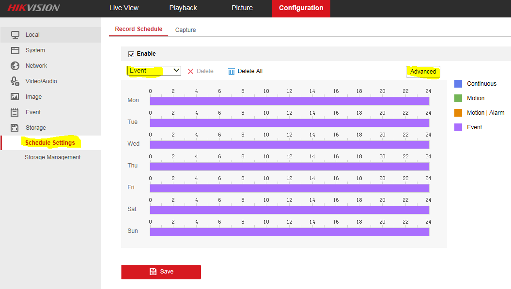

Hi, thanks for response - I do have an SD card in the camera. I do see some setting that specify record 5 secs or after event. But I don't see how these cod be Ftped..... I think it maybe via an event

Yes I tried that but I couldn't get it to FTP. I'm pretty new to this stuff so it may just be me... I'm a bit of a newbie..... really appreciate all your help

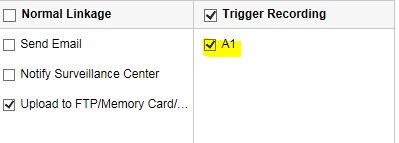

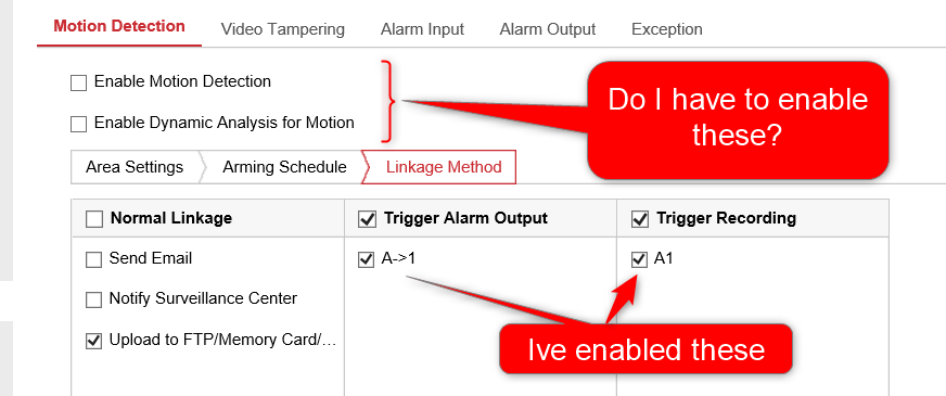

Does the vehicle detection have an option to select like this under linkage method?

Thanks for the reply and follwing thsi up with HikVision. I have enabled these see below. Im not so familar with these setting as I managed to spam myself with images accidentally - I some how sent thousands of images to my FTP server. So I have been a reluctant to mess with them too much
