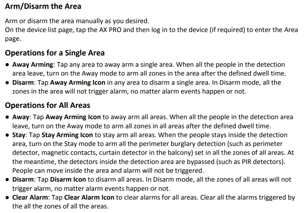

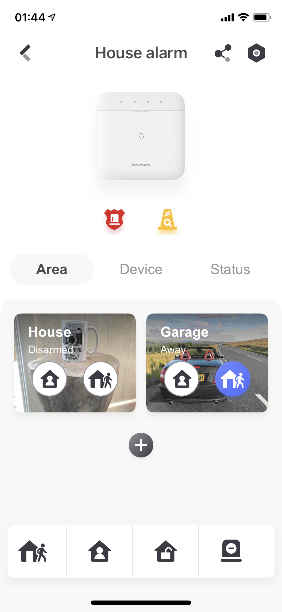

For each of my zones - there are two 'buttons' - one to set the system to armed if I'm at home, and one to set the system if I'm away. What's the difference in terms of what the system actually does between both options? I can't see anything that's configurable to perform a certain action different ways depending on whether you are home or away - has anyone figured out the difference?
