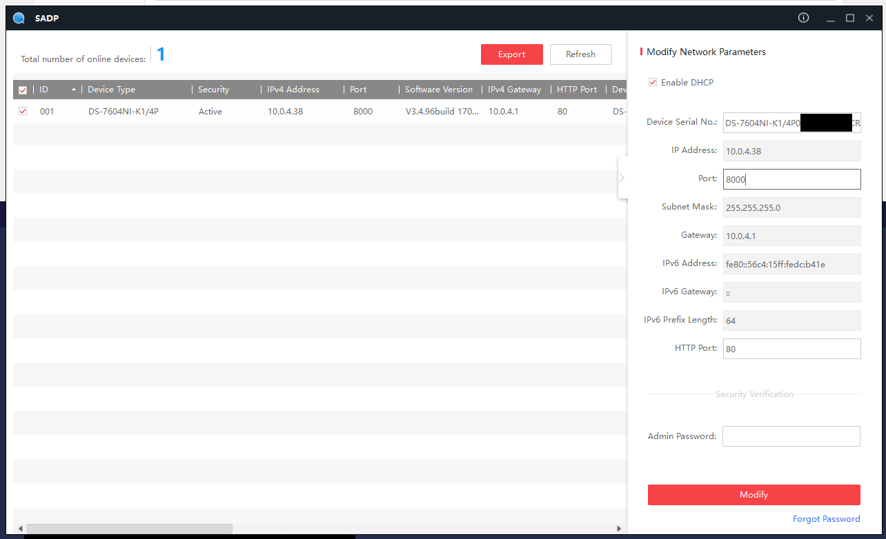

If you install and run the "Latest" version of SADP on your PC it will reveal the camera's current credentials:

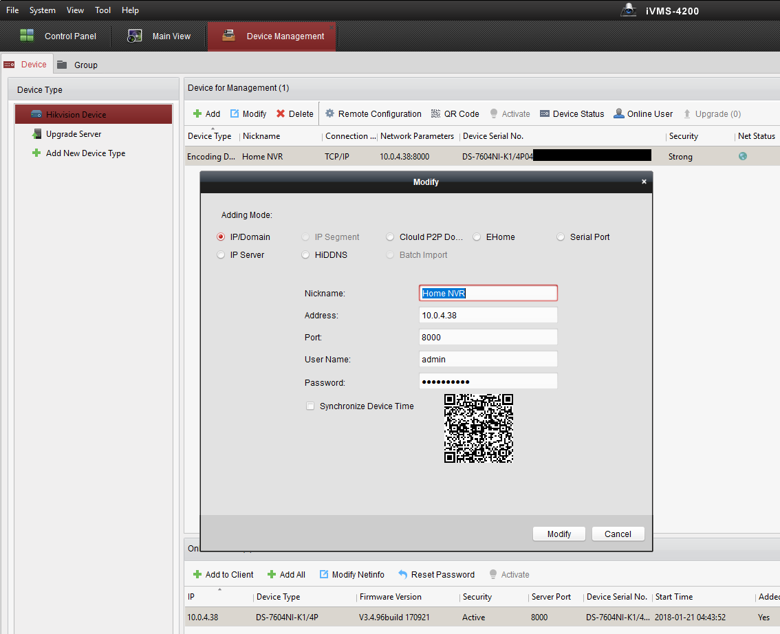

For iVMS-4200 you'll need to go to Device Management, select your camera, select Modify, and edit the IP address.
NB - to fix your camera's IP address so that this does not happen again:
In SADP, select your camera (put a tick in the check box at the left end of the row), untick 'Enable DHCP' at the top of the fly-out at the right-hand side. You'll need to enter your camera's password and click 'Modify' to save this change.
DHCP = Dynamic Host Control Protocol - it is the setting that allows your router to set a device's IP address. Handy initially, when you perhaps don't know an available and valid IP address, but once established it's best to fix the IP address, otherwise your router will re-issue and change at will each time it is restarted.
Thanks, Phil. Did like you said - iVMS seems to work fine!
