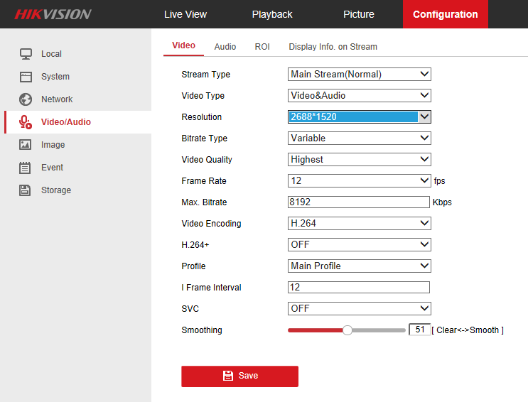

How do your video stream settings compare with the below please?
Are you using an NVR and/or IVMS-4200 software with the cameras?
(can conflict / overwrite settings)

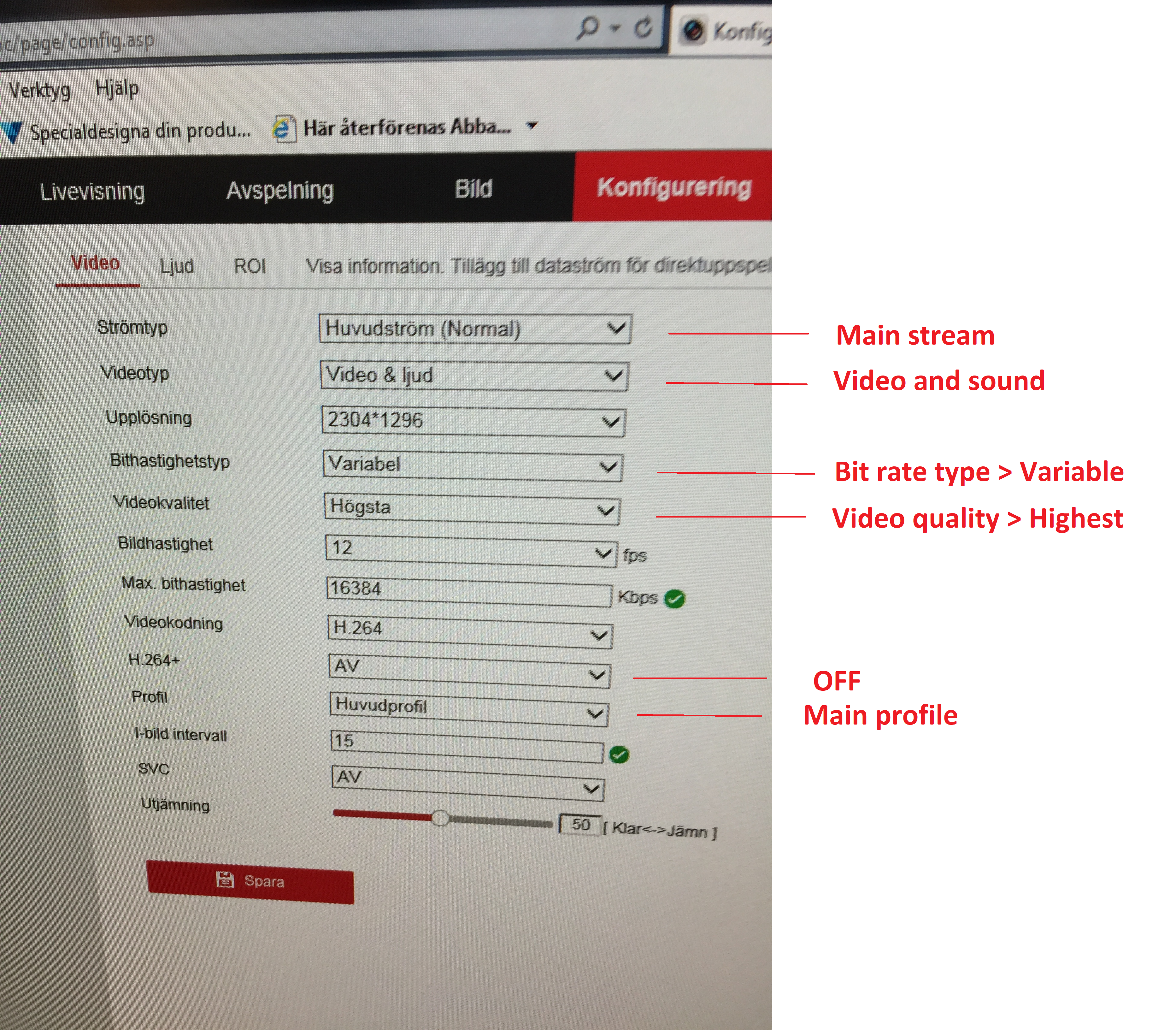

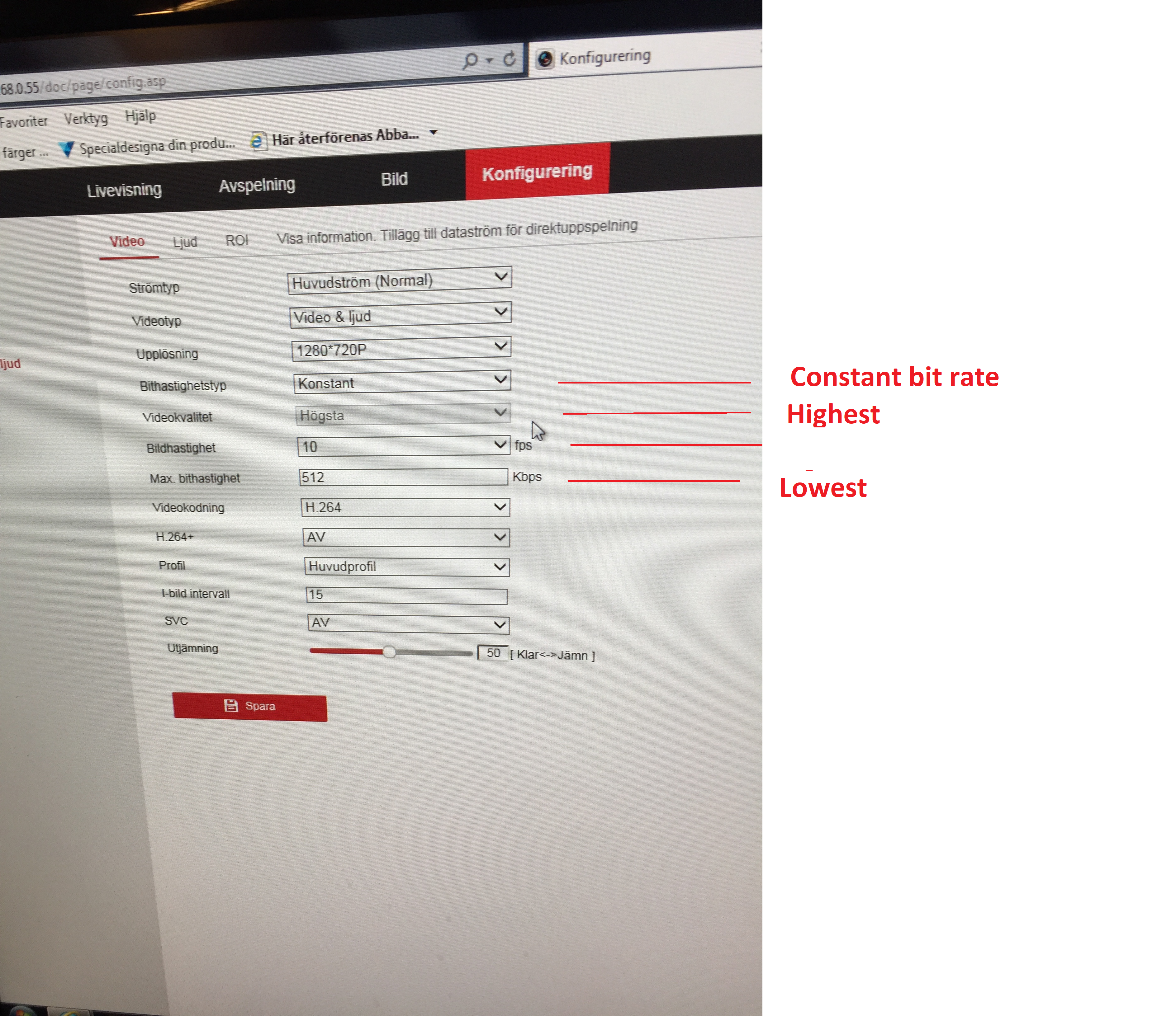

Hi,
Sorry for late answer. My settings are similar to yours, please see attached pictures. I set high resolution and max bit rate also high, according to picture named "Before.png". In this state the video from the camera is very good quality. Then, after checking live view or anything, after like 5 minutes or so the settings have been reset to 512 kbps and low resolution ans it looks like crap. Also frame rate has been set to 10 fps. I do not use NVR or iVMS app. I do use an EZVIZ app (H&L Cam) via Hik-Connect but did not change any settings in it during this test so it should not affect. I have my camera connected via LAN cable about 7-8 meters to my router, bandwidth should not be the problem. Is there any possibility to activate some debug or trace log in order to report to HikVision? Then it would be possible to understand why the software thinks the settings shall be reset.
//Björn

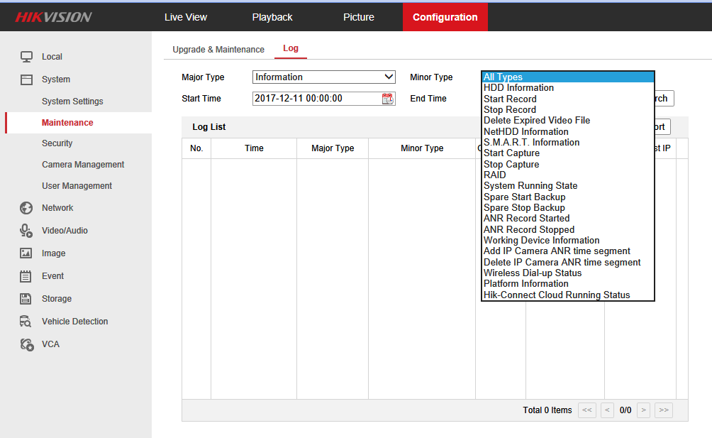

I guess Step 1 would be to rule out the App you are using - maybe uninstall/ don't use that for a few days; keep checking your camera from your PC browser and see if it still resets the settings.
The cameras do have a log feature. You need to install a microSD card to use it:
(screenshot from a different model of camera to yours)

Hi,
I executed the logging according to your description above. I also isolated what triggers the "reset" - it IS caused by the mobile app. This is the way to reproduce it:
-Set for example 1920x1080, 18 fps and bitrate 16384kbps.
-Stream live view in mobile app with setting quality=High-Def. This works, camera keeps it's settings.
-Change (in mobile app) to quality=Basic and stream live view. Still works, camera keeps the settings.
-Now switch back (in mobile app) to High-Def. Now the camera resets to 1280x720, 10 fps and 512kbps
So it seems that the setting of lower/higher resolution in the app causes the reset and then it never goes back to the higher settings.
In the log taken I see a message (translated): Remote function: Changed settings.
I guess that is caused by the resolution change in my app. You know if there is a way to block remote settings to the camera? One way is to always view in app using Hi-Def but we are a couple of users so thats not a perfect solution.
Best regards Björn
