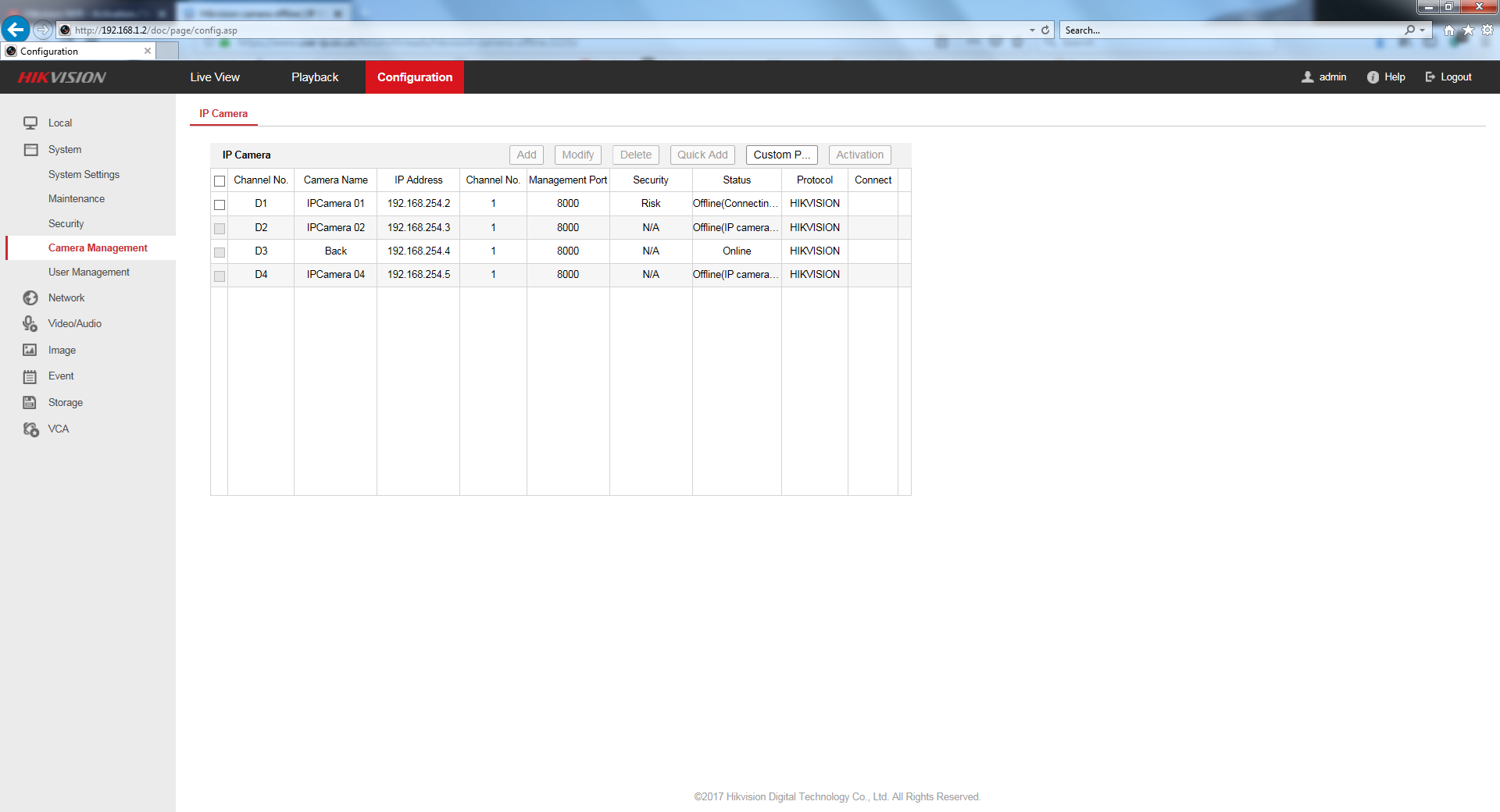

Can you attach a screenshot from the NVR's 'Camera Management' page please?

Thread starter #7

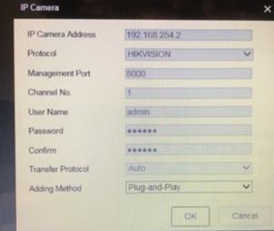

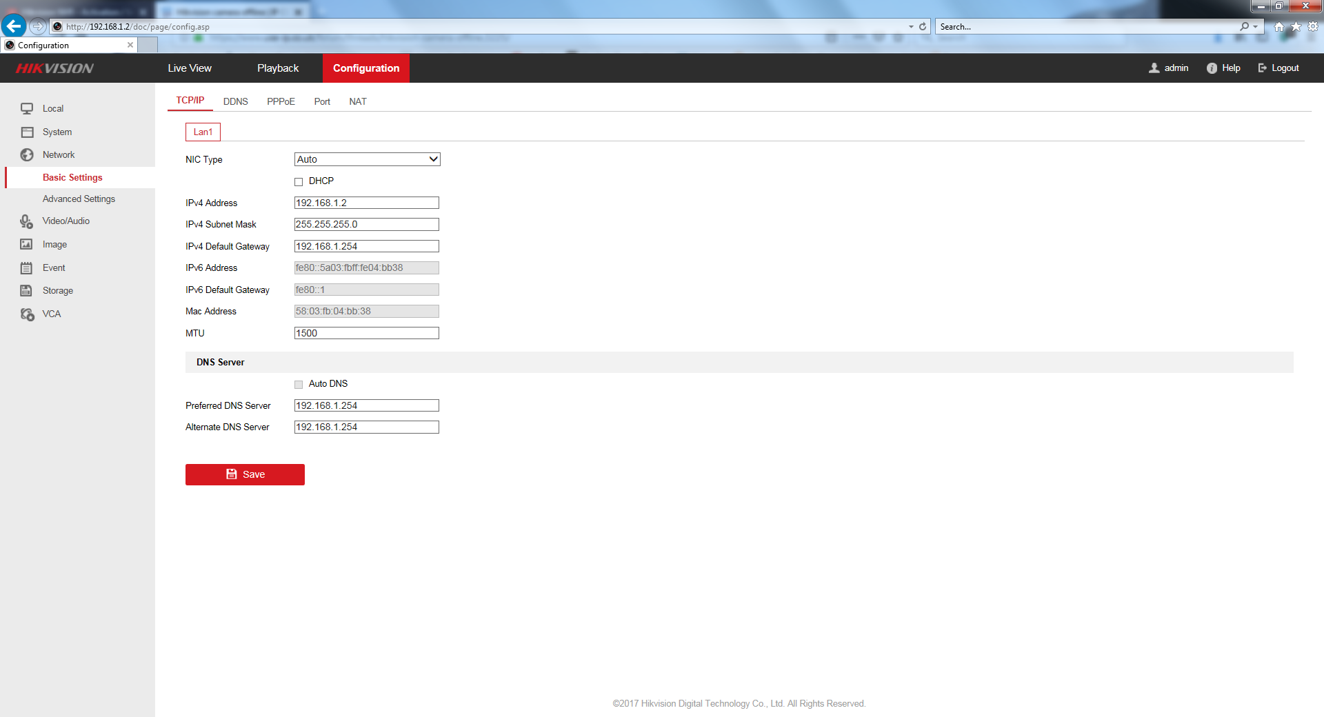

this is camera itself / if I change password then message appear " password error " those dots as a password are not my password
1990

Your settings look reasonable.
Some sort of problem with the cameras connecting to the NVR e.g. their passwords.
I think I'd disconnect the cameras.
Reset the cameras.
Reset the NVR.
Start afresh.
Plug in one camera at a time.
With the cameras disconnected you can reset the NVR from Configuration -> Maintenance.
For the cameras, you'll need to connect each to your network with a separate POE/PSU source and use SADP to access and reset them.
