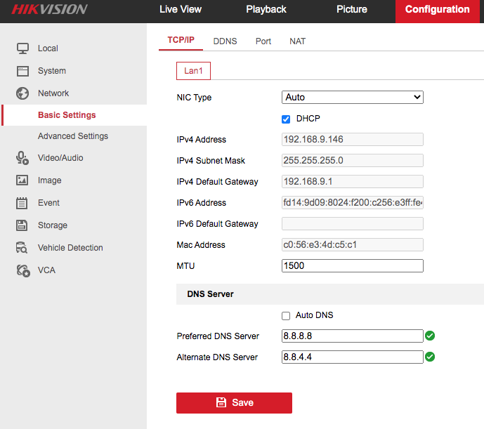

@devs maybe an app layer dns resolution problem. try setting the nvr / camera dns to 8.8.8.8 and 8.8.4.4 (google dns).
I've just tried the following David, (it didn't resolve unfortunately) have I entered the information into the correct area within the NVR?
looks good to me, is your router set to google dns? maybe @Dan or @Phil could help?
did you setup the platform access (config> network> advanced)?

Hi Dave, I just reset the NVR and setup Hik Connect again and its all working great! Really appreciate your help. Have a good weekend! ;)
