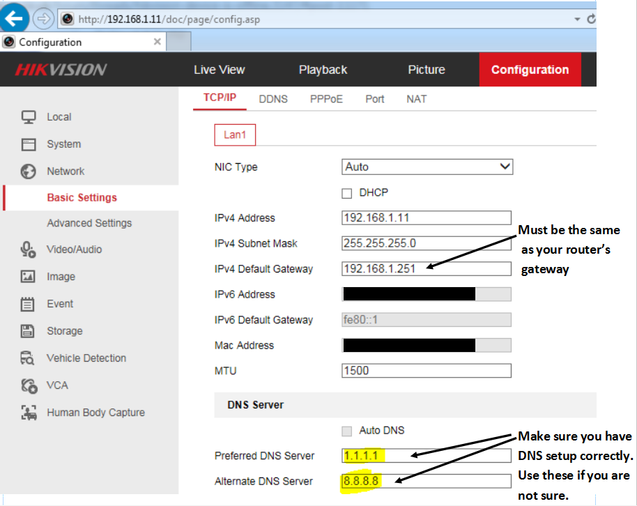

The most likely causes are that you:
  • Have not enabled Platform Access.
  • Have not got your Network Settings configured correctly.
    • You need the correct IPv4 gateway address for your router entered in Network Settings.
    • AND, you must enter DNS settings.

First check your network settings:
2220

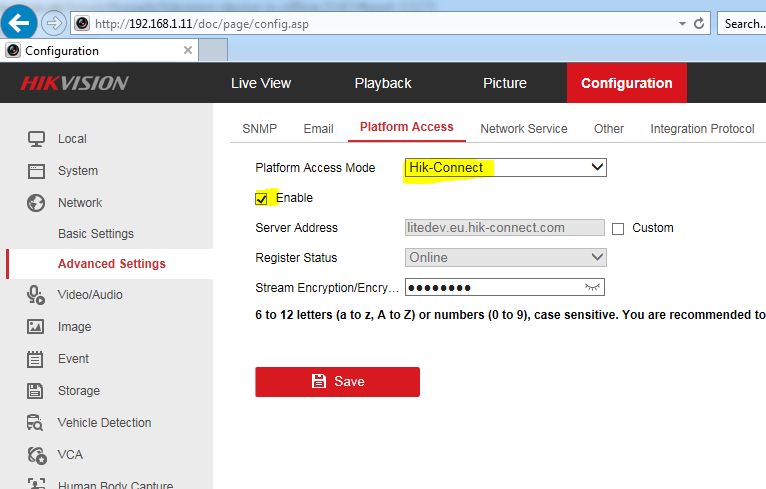

Next, setup Platform Access. There are many server addresses, 'litedev.us.hik-connect.com' is fine. Don't worry if the Register Status says offline, we will get to that.
2221
Probably the biggest issue is with adding the device to the Hik-Connect portal. If it's not added, you won't see it as online.
Log into Hik-Connect on your PC and try to add your DVR using 9 digits from the serial number toward the end. A fictitious example of a serial number would be: DS-7616NI-I2 / 16P1620181216CCRRC00633721WCVU - use the 9 digits in bold that correspond to your serial number. It normally starts with a C and ends with a number. You should fine this 9 digit number printed on the side of the box your DVR came in. Once the Hik-Connect portal finds your device, add it and the Register Status on your DVR will report online (may take a reboot).

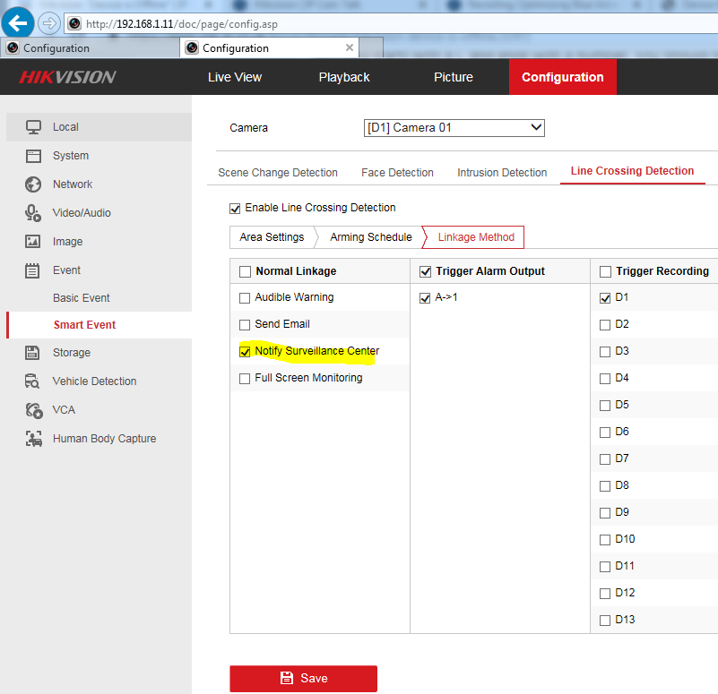

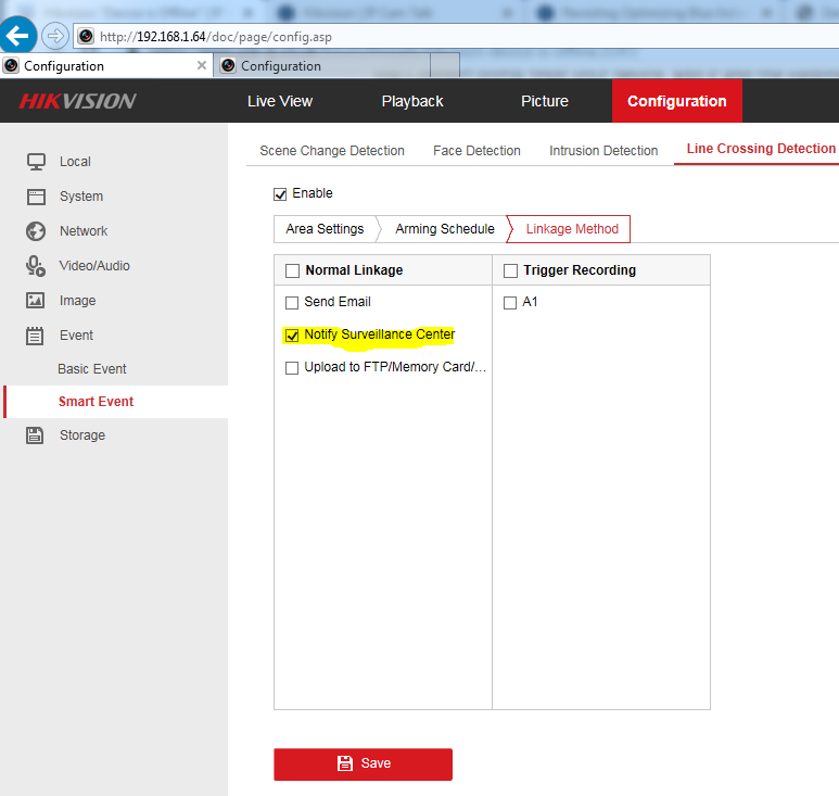

A few things that need to be enabled that are not obvious. Notify Surveillance Center enabled on both NVR and the cameras is one of them. Let's say you want to setup Line Crossing alerts to be sent to your phone.
On the camera, under Configuration>Smart Event>Line Crossing>Linkage Method make sure Notify Surveillance Center is ticked.
2224
On the NVR: Configuration>Smart Event>Line Crossing>Linkage Method make sure Notify Surveillance Center is ticked.
2225

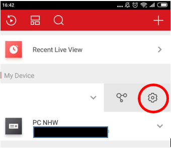

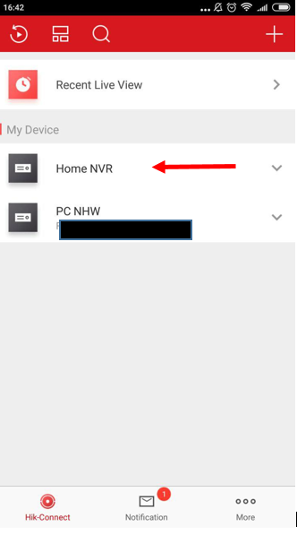

On your phone (I only have Android to post captures from). Open the Hik-Connect app and slide your finger from right to left toward the edge of the screen. This uncovers the NVR settings.
2226
Click the cog.

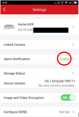

Make sure Alarm notification is enabled.
2228
2230
Log out of the app when done and back in. Now test the alerts. Keep us posted.
