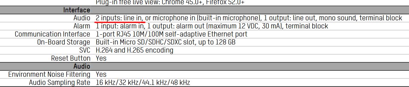

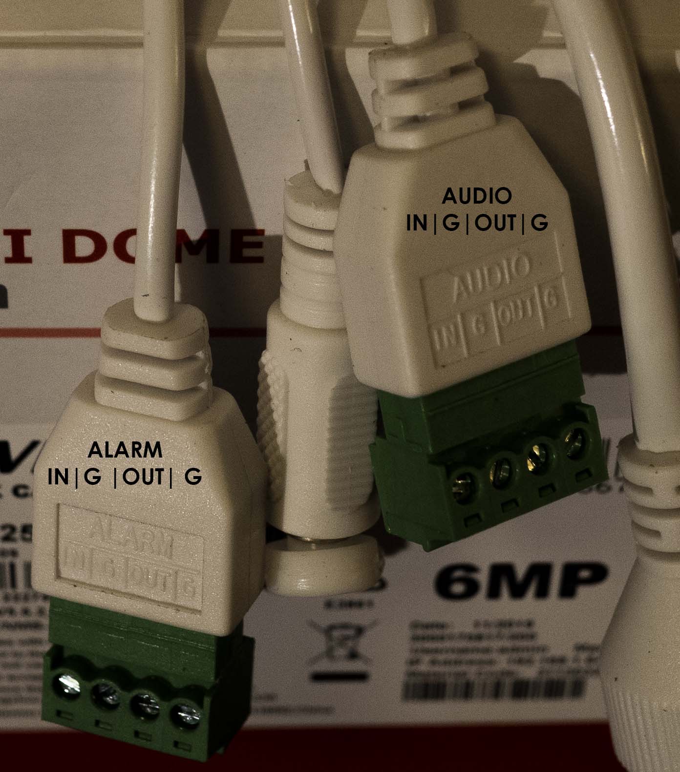

I took a picture to try to work out what the terminals are and this is quite concerning because the datasheet states 2 (see after the first image) line ins but terminals only seem to show mono. We need stereo because we were going to use the cameras to record stereo feed from the mixing desk :)
So have I misunderstood what the green terminal connection are are are the datasheets wrong?
