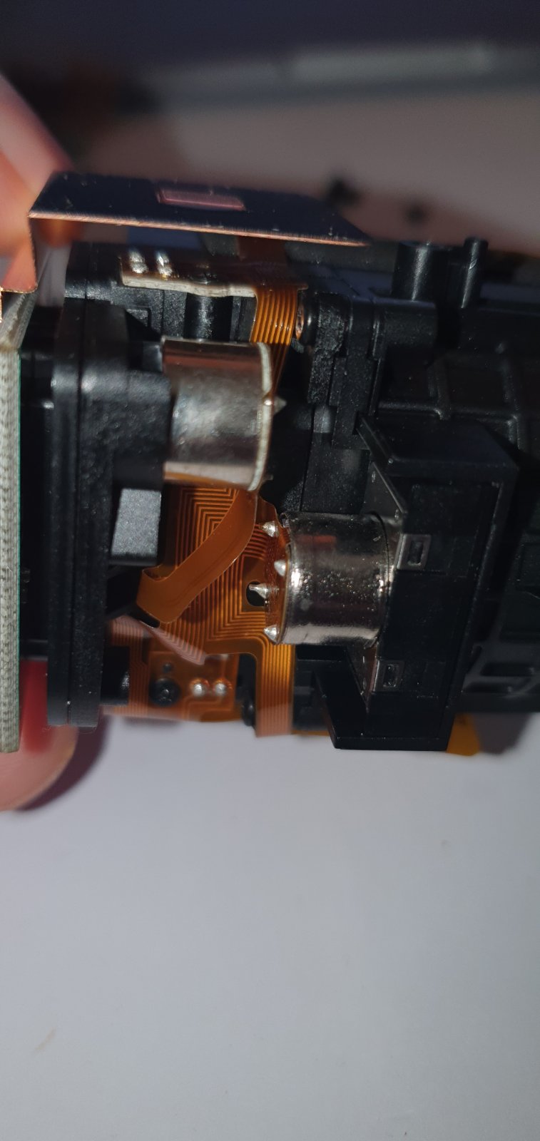

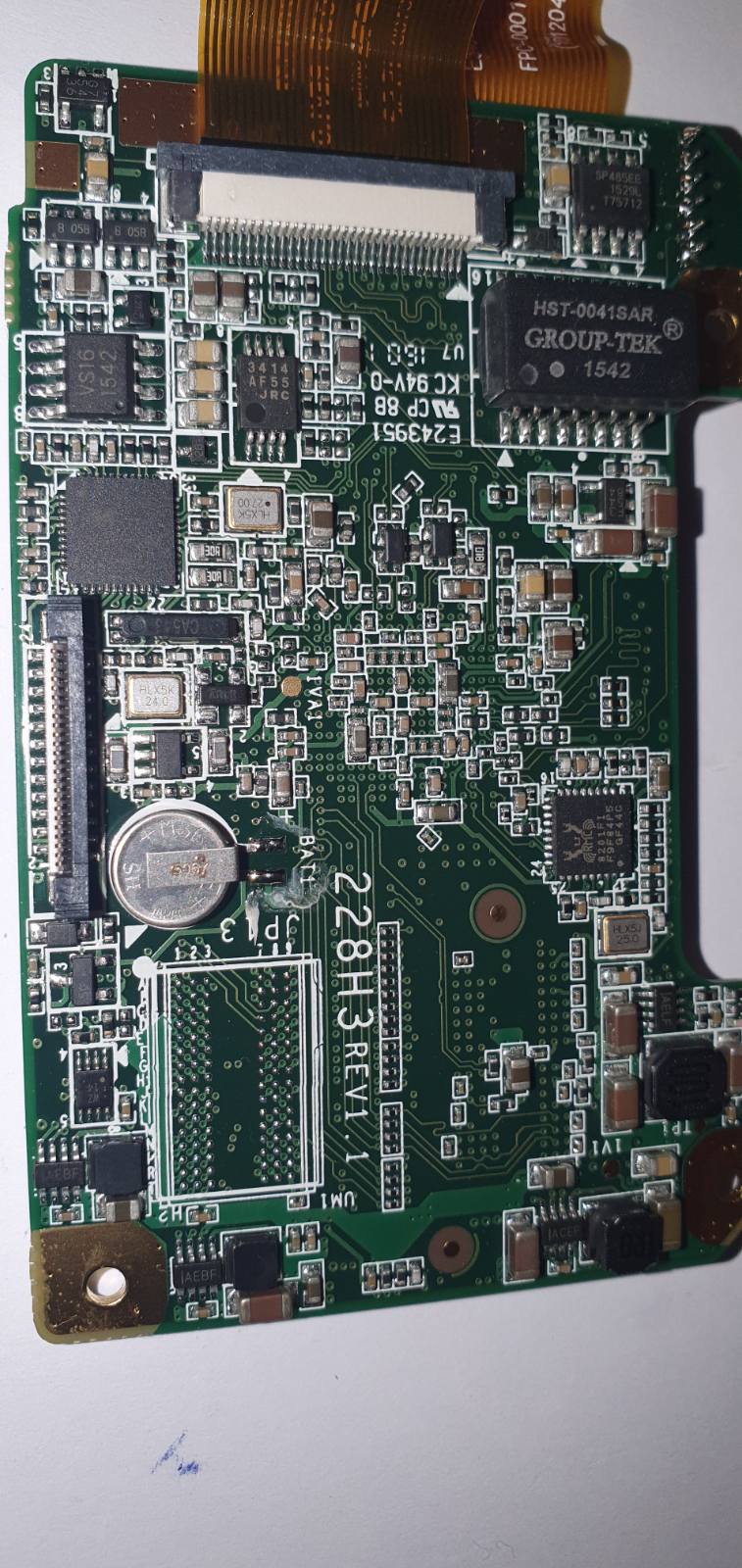

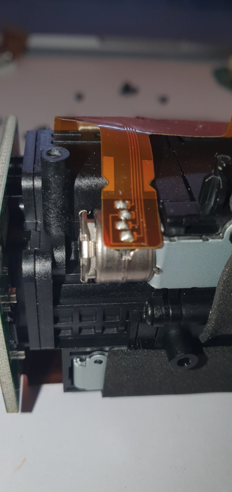

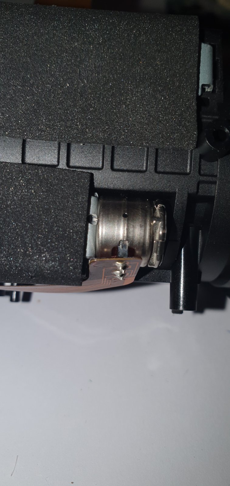

As the camera is out of warranty, and I consider myself good in electronic, I have disassembled the camera and I can see the small motors controlling different functions of the camera. Like the zoom and the focus.
When I test these small motors, they are working fine. So my guess so far is that the board, controlling them is faulty.
At this stage, will try to test the components on that board or try to find a replacement for it.
