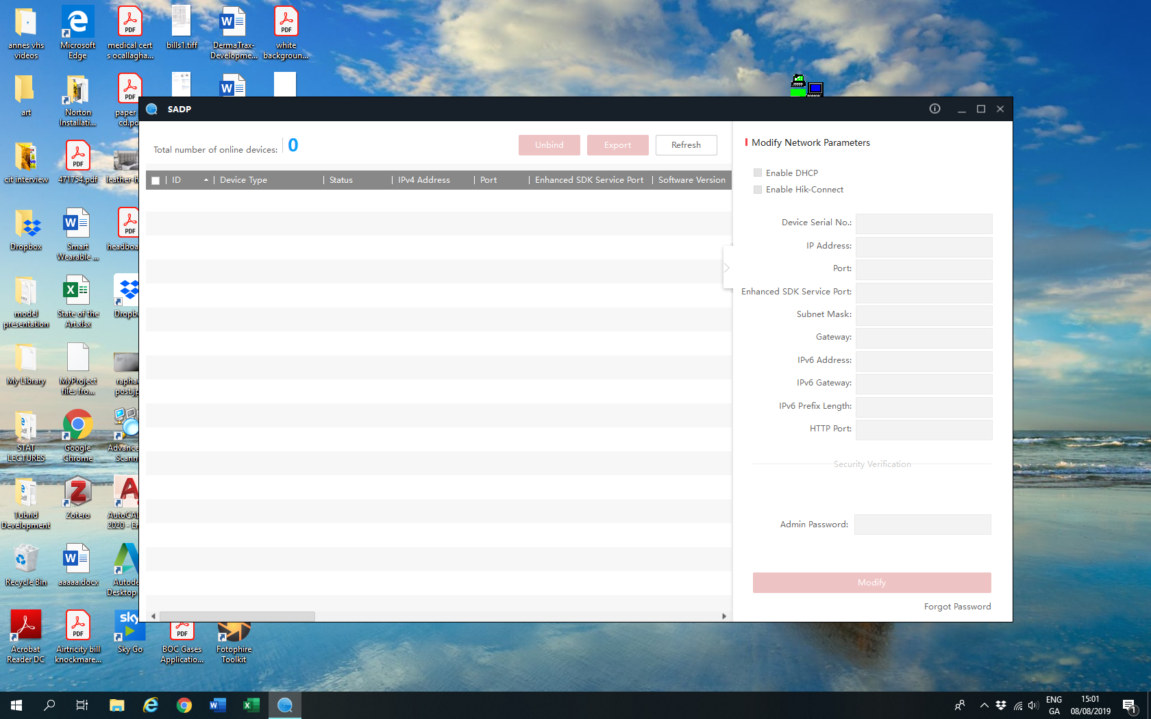

Can you please run Hikvision's SADP utility on your PC and send us a screenshot?
I'd like to confirm IP addresses and firmware versions.
Thanks.

You can find the latest version of SADP here:
HIKVISION UK PORTAL
Please download and install it on your Windows PC.
I assume the PC is connected to the same network as your DVR?

Yes, im downloading it as we speak on my pc which is connected to the same network
suzanneocallaghan
18
3
Thread starter #6
2483
When i installed the sadptool, it reported an error: failed to install the npf service. I dont know what that is

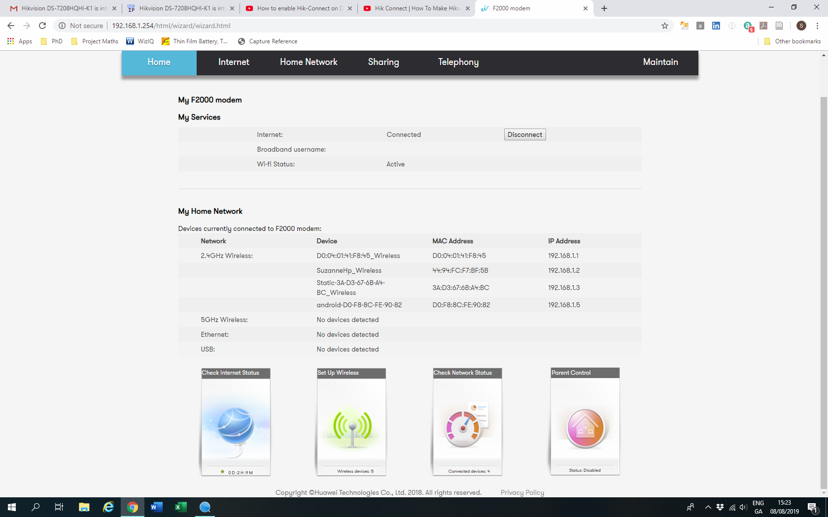

SADP was meant to reveal it.
Can you login to your router and see the DHCP assignment?
See what IP address your router has issued to your DVR.
Phil
Administrator
Staff member
3,270
83
#14
Your NVR is not listed.
The list shows no devices in the Ethernet section.
Only x4 wireless devices.
Please check how your DVR is wired to your router/network.

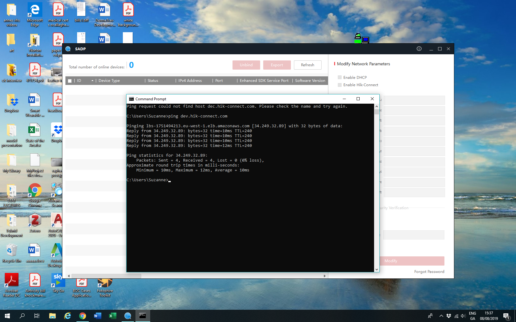

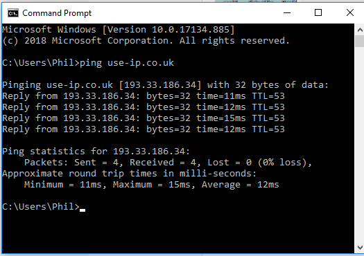

You have only pinged their web portal.
Same as pinging our website/server:
2487
I doubt that your DVR is wireless.
It needs to be wired to your network.
Your router needs to provide it with a 192.168.1.XXX IP address.

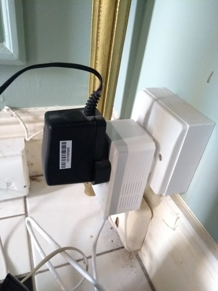

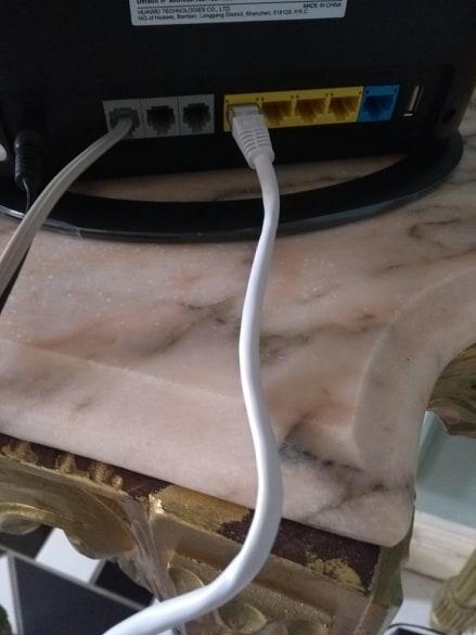

just checked and there is only one LAN connection to my router which is plugged in to a tp-link, which also powers the router. DVR is located in the attic. dont know how they could have connected it other than wirelessly? There is a wired connection into the back of the tv, hdmi, i think

The 'TP-Link' may be a Powerline device, which uses your mains cabling as a network connection.
You may have another similar adjacent to the DVR in the loft.
Check the model code of the TP-Link, to see what it is / does.
suzanneocallaghan
18
3
Thread starter #20
wow, ure right phil, it transmit data through shared power line. didnt even know it existed. Im installing sadp on another pc to see if we can get dvr data
