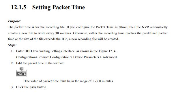

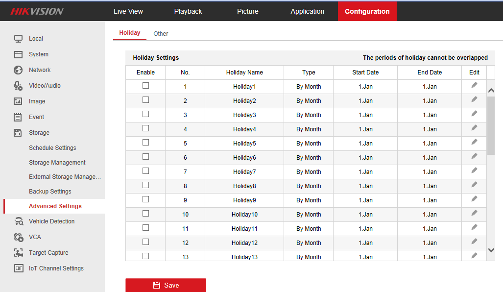

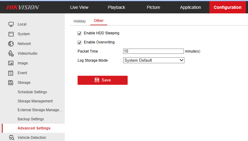

Are your Advanced Settings for Storage normal?
Just been through the logs and nothing jumps out.
with regard to the other settings all looks as above except my Packet Time is blank??
that is odd. I’ve changed it to 10 as above, but assume from above info it would of defaulted to 1Gb.

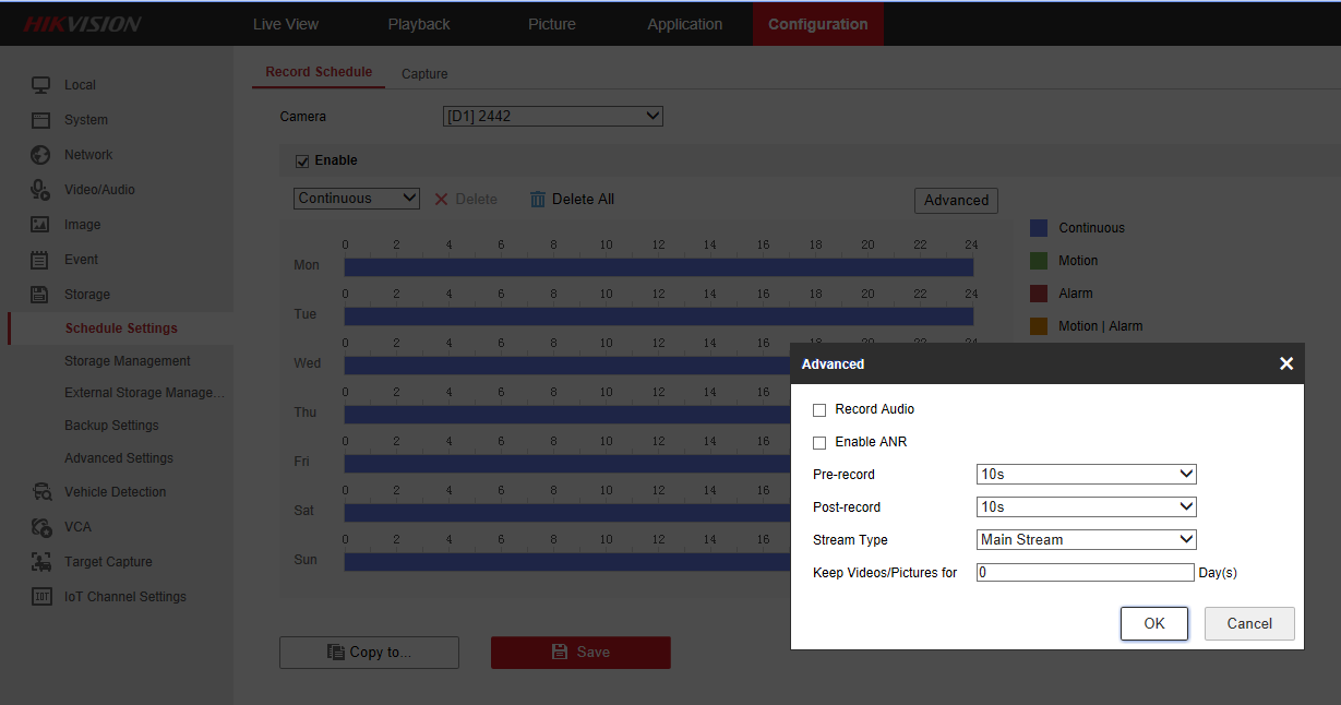

Think I’ve found the issue and what a fool am I !!!!!!
under the record schedule, advanced it’s got a value in the keep videos/pictures for 2 days!!!!
Don‘t remember editing it, but I suppose I must of.
So I’m forcing it to delete the videos.

just out of interest and for completeness:
Does a value of 0 equal keep video until its overwritten by drive capacity limits?
I have now just put a value of 30 in there to keep for 30 days.
Yes, 0 equals just keep recording until the drives are full.
See #5 above, if there is a tick in the box to "Enable Overwriting" then it will overwrite the oldest recordings and in effect keep the HDD(s) always filled.
That is how most people run it.
