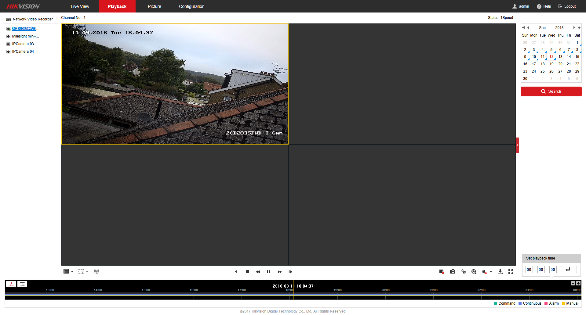

We have a demo 7604 here in the office that is updated to the V3.4.101 firmware and we are seeing the same thing as you, the snapshot feature does not appear to be available anymore, you can still clip a section of footage or tag a moment on the timeline but snapshot does not appear to be an option.
It is still possible to snapshot from a browser, and if you can't access via a browser and you desperately need a snapshot you may have to export a short video clip, load it on a computer and then screenshot the moment from the playback that you require.

Yes thanks Dan, I have the web browser version set up and have got it working so that I can get screenshots that way. I am new to this, but it seems to me that it would make a lot of sense if the feature was available directly on the unit itself as well, with the fancy smart search/line-crossing etc. facilities!
