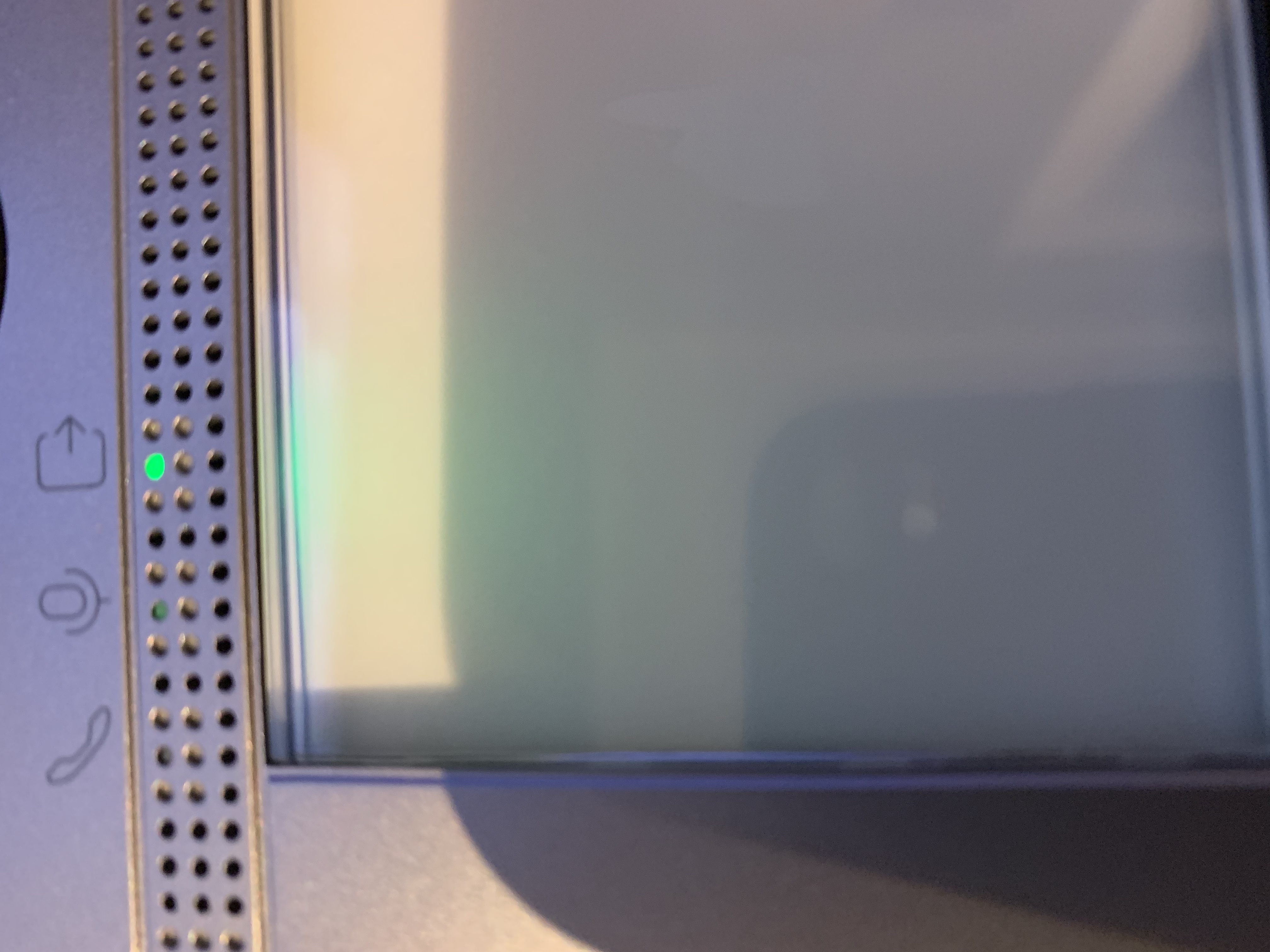

Could I ask a question for anyone who has or installs the outdoor station 8113. I've one that has a constant green light on the door open sign as below, my 6113 does not have this constantly illuminated only when the relay is operated, I've watched online test videos of the 8113 albiet not on the same version of software as mine (videos are older) and no one else has the same issue.
Things to note;
Everything else appears to work and the door will open on card, call the indoor station etc but the green light never goes off (Other then if I reboot it)
It's not running the latest software it is running the V2.2.11 build 201126 however note if I upgrade to the next version I will not be able to roll back if I want to as the "software change thing on the intercom version 1 and version 2" and my 6113 is not a (B)
I've not installed any cable for the door contacts or sensors.
Photo of the constant green light

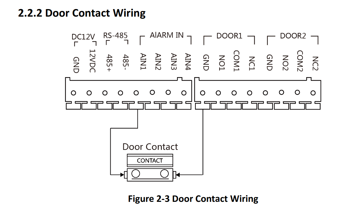

It seems this green indicator reflect the Input1 status. By default, Input1 assigned to the Door status. Door contact should be connected as shown on the scheme from User Manual. I can't disable it through the device web Interface, probably this can be done with the Hik-Connect app, so I just connect Input1 to the ground with short wire.

@Cool2000 thankyou for the time take to respond to me, I thought I’d tried this but not sure if I corrected correctly so I will give it a second try. Do you have one of these and had the same issue and resolved it the same way?
I also have a 6113 same family of foot station on a separate property which is very similar other that the fact it’s not a (B) model so running the slightly different software and it’s not had to have the contractor wired this way and the green light is only active when the card is presented.
I have DS-KV8113-WME1(B) model with 2.2.43 build 210407 firmware and this shortcut connection definitely switch green LED off.
Wonderful again thanks for replying, look forward to trying this weekend. Strange I don’t have to do that with my other unit the 6113 which is from the same Villa family
