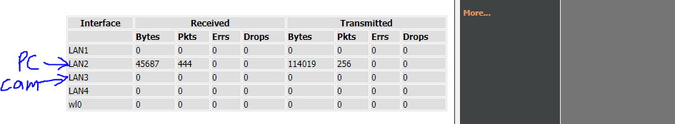

I've followed the initial steps, have it connected to a 12V/1A transformer, and plugged in to the router via a network cable. The instructions state that I simply have to connect the camera to a computer and go to 192.168.1.64. However, I get no response whatsoever. The infra-red lights on the camera light up, but the router's port activity light, at the port where the router is plugged in, shows no activity. I've set up the camera on an isolated router and connected to one desktop, but I'm receiving no activity on that port.

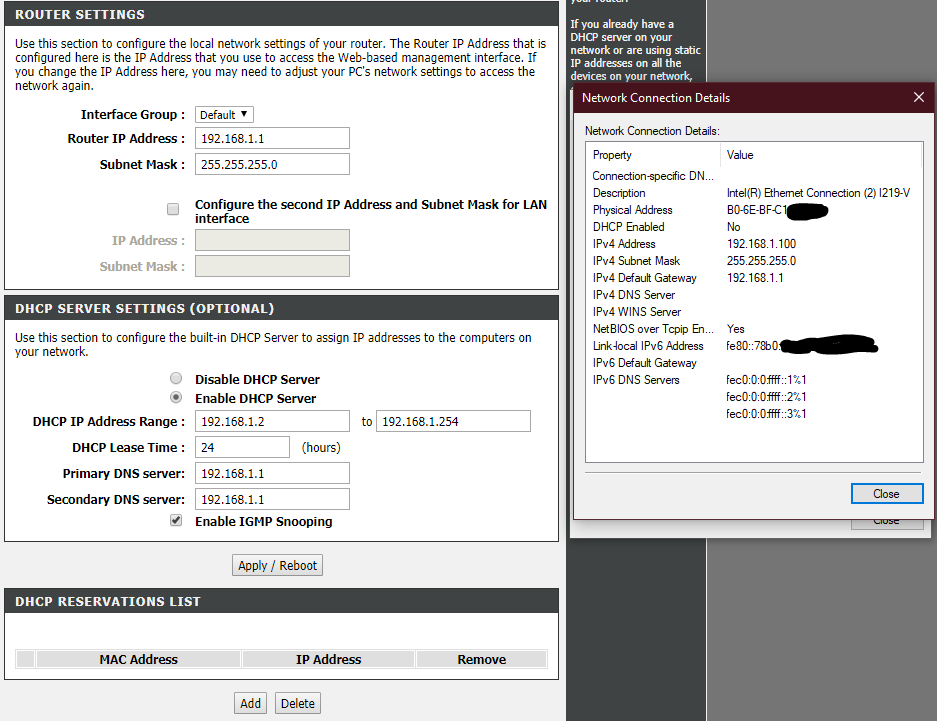

I've also configured my computer to be set to 192.168.1.100, and connecting it to the camera directly, as one forum suggested, as well as leaving it on automatic. That had no effect. If it's a router issue, here's the router settings:
