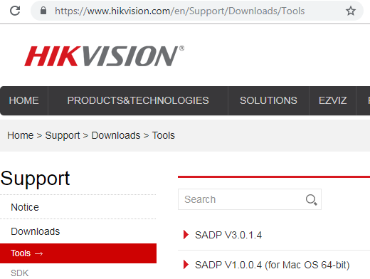

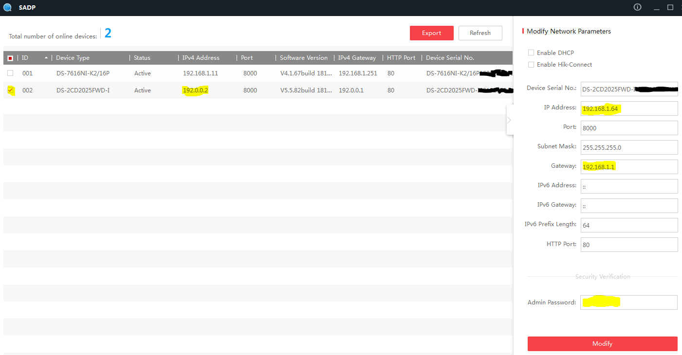

  • Download Hikvision's SADP tool. SADP will detect the DVR even if it's on a different address range.
Install and run SADP
Tools - Download - Hikvision
The second device is a camera set to 192.0.0.2 (In your case select he DVR).
Select it and configure the desired settings on the right. You need the admin password to make the changes.
After the reboot you will be able to access the web GUI to view the settings and the live stream. Keep us posted.
