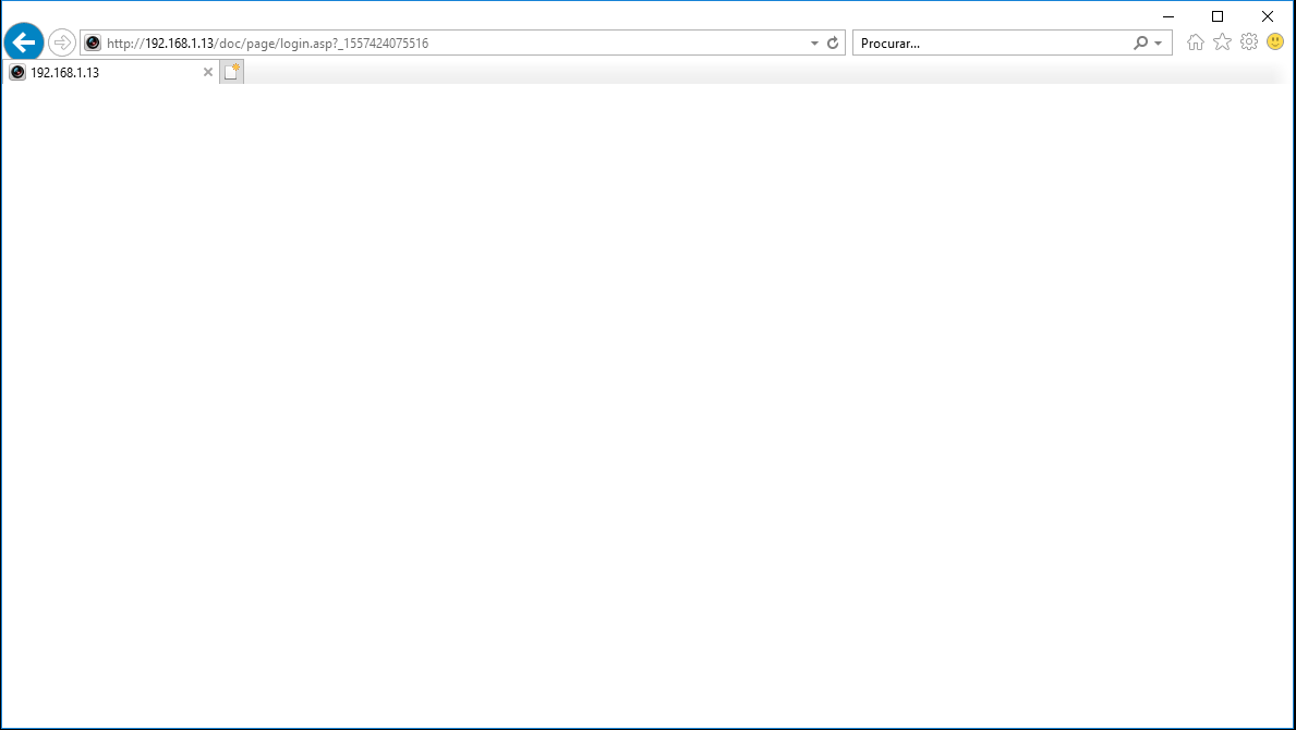

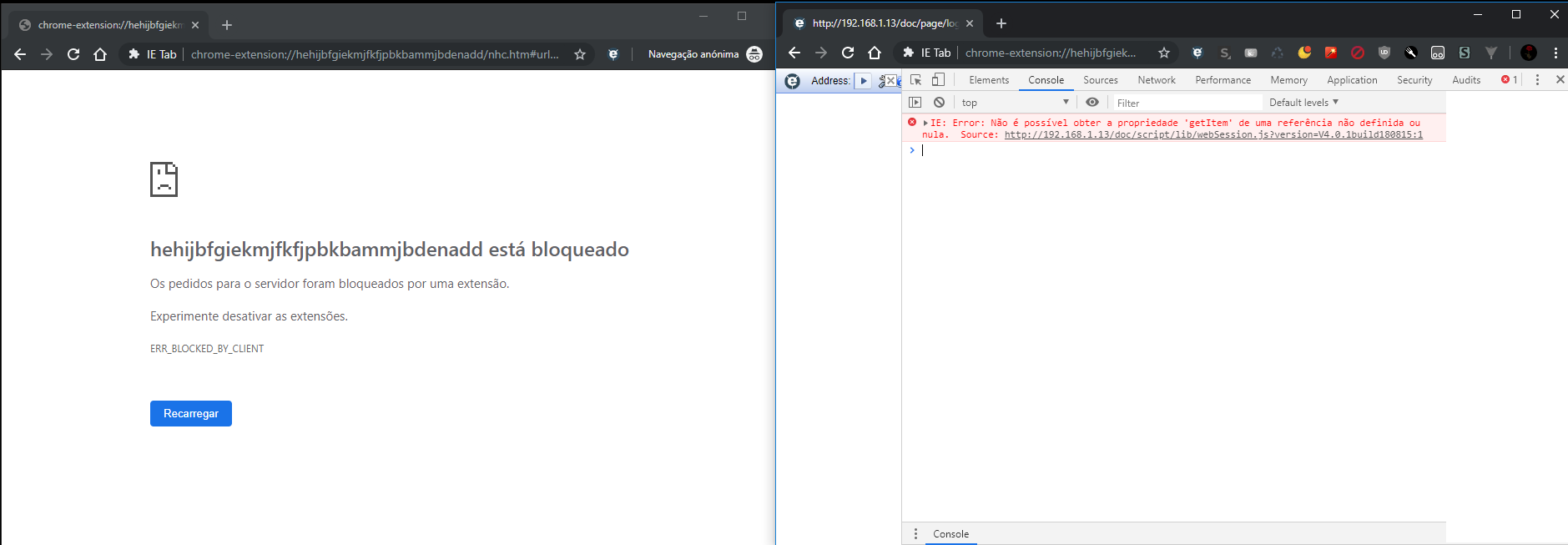

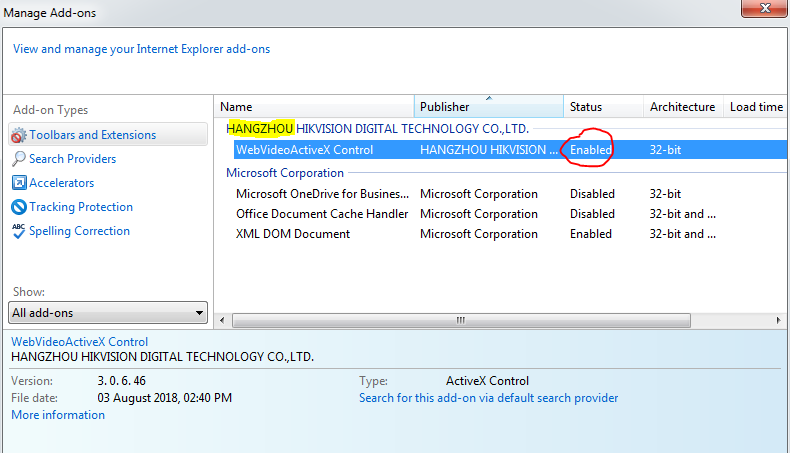

Hello, so i was trying acessing by google chrome and after installing the extension and Webcomponets it dont works.
In google chrome i get this error:
"IE: Error: Error: This is not a property claim. Source:
http://192.168.1.13/doc/script/lib/webSession.js?version=V4.0.1build180815:1 "
If i try to open in internet explorer the page stays white.
Tested in other pcs and it worked.

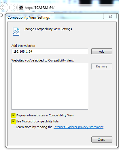

In IE11 check your Compatibility View Settings are ticked.
2178
A few things you can check:
Is the WebComponents.exe plugin enabled?
2184

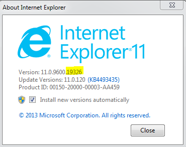

Are you on the latest version of IE11?
2183

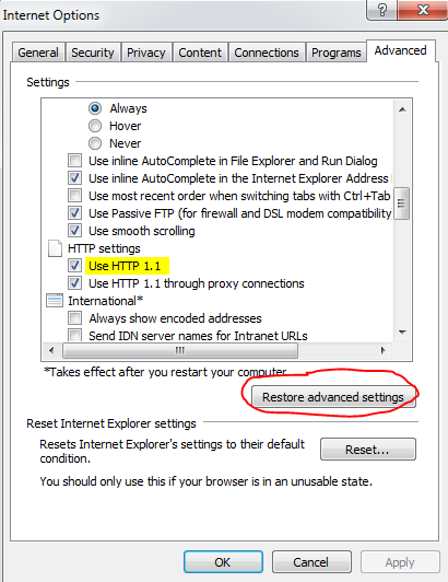

Check if Use HTTP 1.1 is ticked. As a last resort you could try Restore advanced settings
2185
