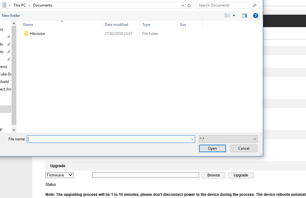

anyone else having issues updating to this release
download the zip file
extracted and digicap file is in folder
log into camera and cant see the file at all
as per pic
one camera has updated but the other three wont
also my 4k camera on front gives same error
must be having a dumb moment
that worked as above
BUT how did i manage to update one 5 k camera using the folder method last night :)

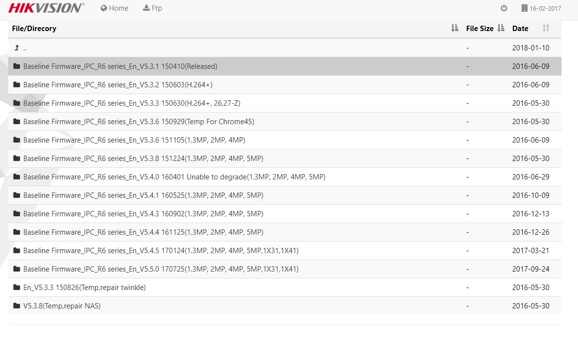

v5.5.5 has been removed from the Eu site, v5.5.0 is the latest. Have managed to find it on the Australian site Hikvision Australia
