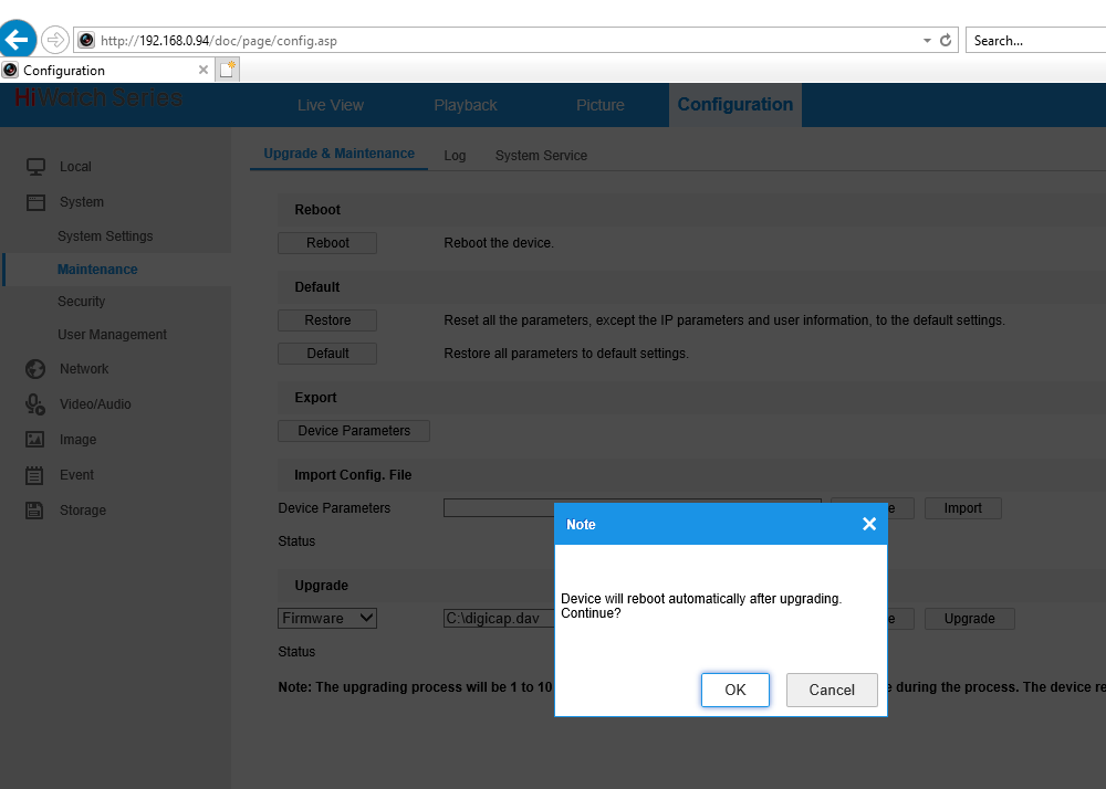

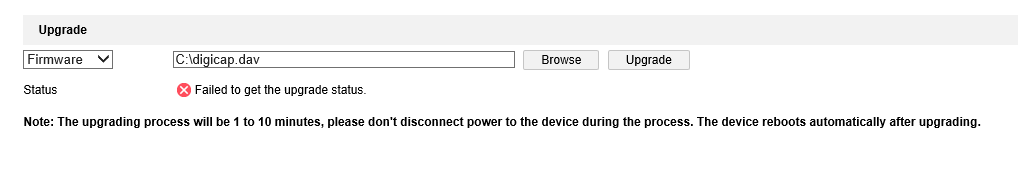

thanks for the info , bnut dont seem to get it to load
connect via web page
maintenance page
D:\Temp\digicap.dav
Failed to get the upgrade status.
must be doing something wrong ??

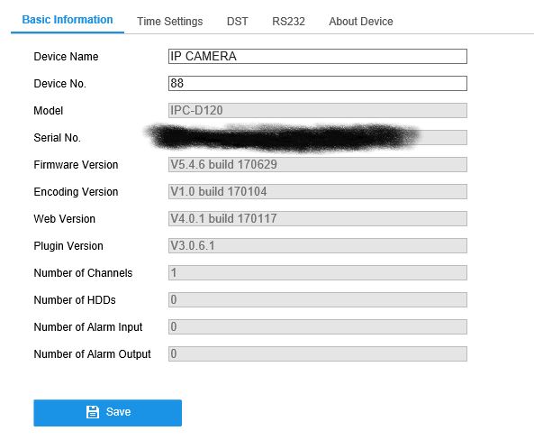

Device Name IP CAMERA
Device No.
Model IPC-D120
Serial No.
Firmware Version V5.4.6 build 170629
New Version
Encoding Version V1.0 build 170104
Web Version V4.0.1 build 170117
Plugin Version V3.0.6.1

all the above c:\digicap.dev connected via ie 11
and rebooted the camera as well and tried again
still the same error
