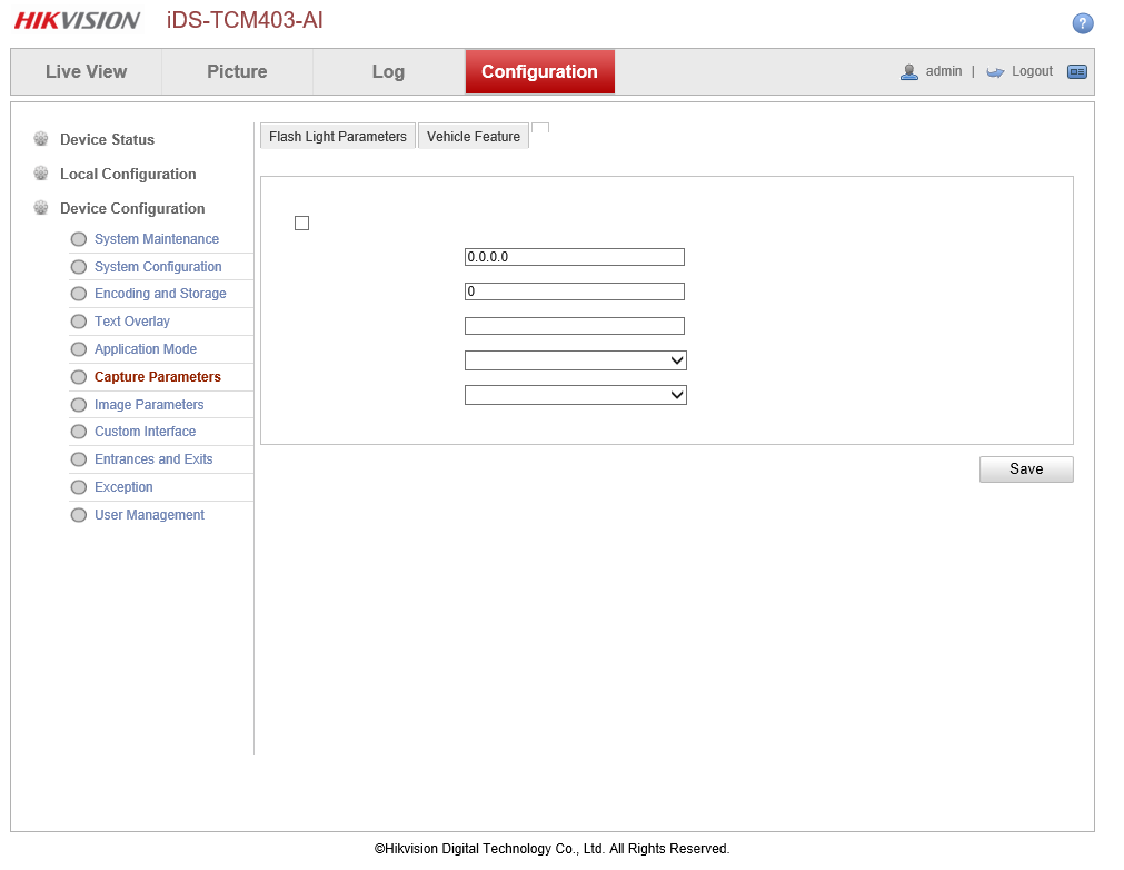

Well I put the latest firmware on and it worked for about 5 minutes, then the Live View goes monochrome, then it goes completely black (apart from the white overlay text). Tried rebooting and power cycling, it again works for a few minutes then displays the same symptoms.
Put the "old version" on from that folder, same issue! I've also got a new tab on the "Capture Parameters" config page which has no text in it, and just looks a mess in general:
Does mess look like:
Yes! Clear cache sorted it out - thanks!

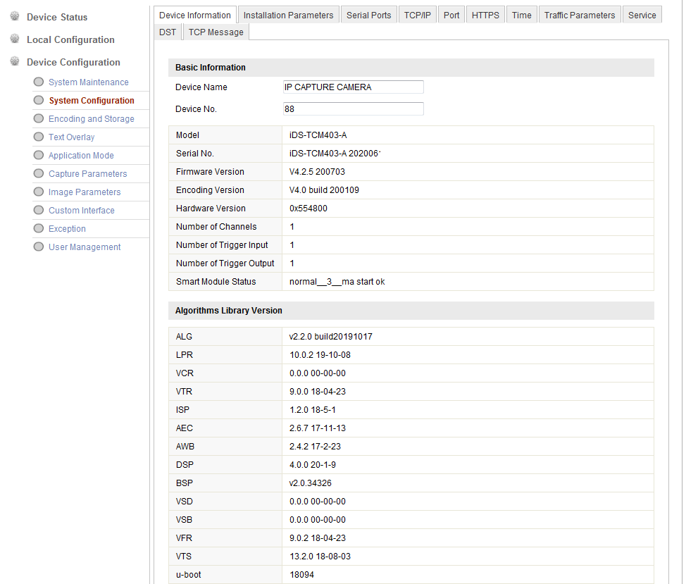

Hi guys,
We are having the exact same issue with a customer who has a iDS-TCM403-A.
The camera worked fine until updating the firmware, now it works for about 5 minutes after rebooting then switching between monochrome and black.
We tried powering it with PoE and 24v without success. It seems like updating the firmware broke the camera.
We are in contact with a technical engineer from Hikvision. I will get back to you when I have more information.
Hi guys,
So it looks like the technical engineer from Hikvision fixed the issue by flashing a new special firmware to the device (remotely). So it was not a hardware issue.
Unfortunately the zoom and focus function as well as vehicle type detection are not working with the new firmware, we are still in contact with him.
This is what the settings page looks like now:
