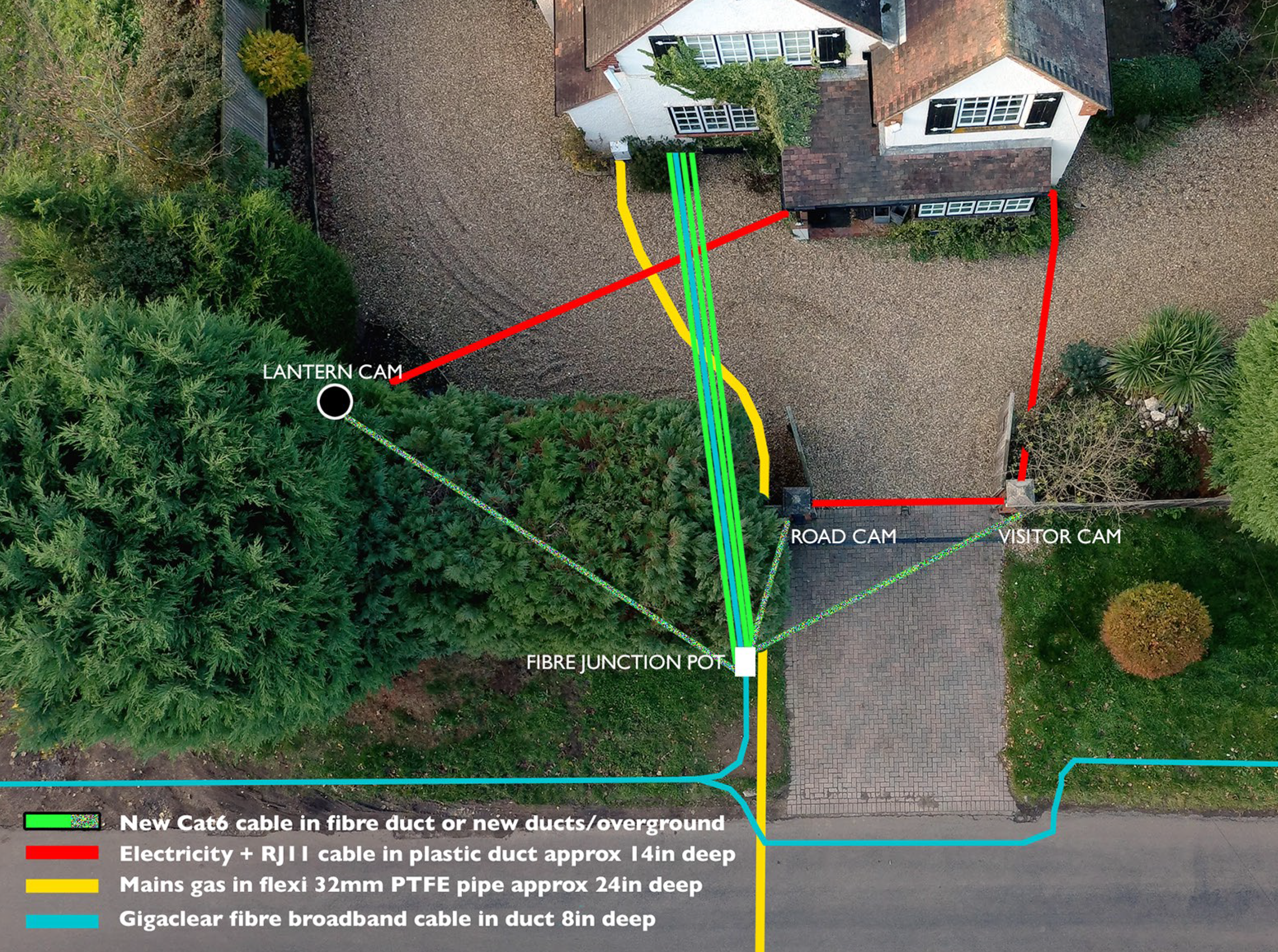

I use the Hikvision DS-KD8003-IME1 for my electric gates with Cat6 burial grade gigabit copper core cable running underground in a duct to my house where it connects with my main indoor station (to which other indoor stations connect wirelessly). As a gate opener, doorbell and voice intercom, it works flawlessly. But don't expect the camera in the gate station to deliver any worthwhile video recordings (which makes the whole system an epic fail imho) - even after you go to the trouble of masking up the motion detection zone.

My LAN is a mesh system so any device can plug in anywhere. My 8003 comes through the wall and plugs into a passive switch connected to one of my mesh nodes. It is then available to my PC, phone, etc.
The first - sometimes only - indoor station (these are mini 7in or 10in monitors for wall mounting and they need a power point) is configured in the system setup as the master indoor station and any addition indoor stations are configured as indoor extensions as they get their data wirelessly from the master station.
I'm told that the master indoor station can talk wirelessly to the door station (camera/intercom) but I wouldn't risk that so my master indoor station is ethernet wired to another passive switch attached to another of my mesh nodes. I have three other indoor extension screens which operate wirelessly and although they get data from the master unit, they aren't mirrors, ie they operate independently with the same functionality as the master indoor station.

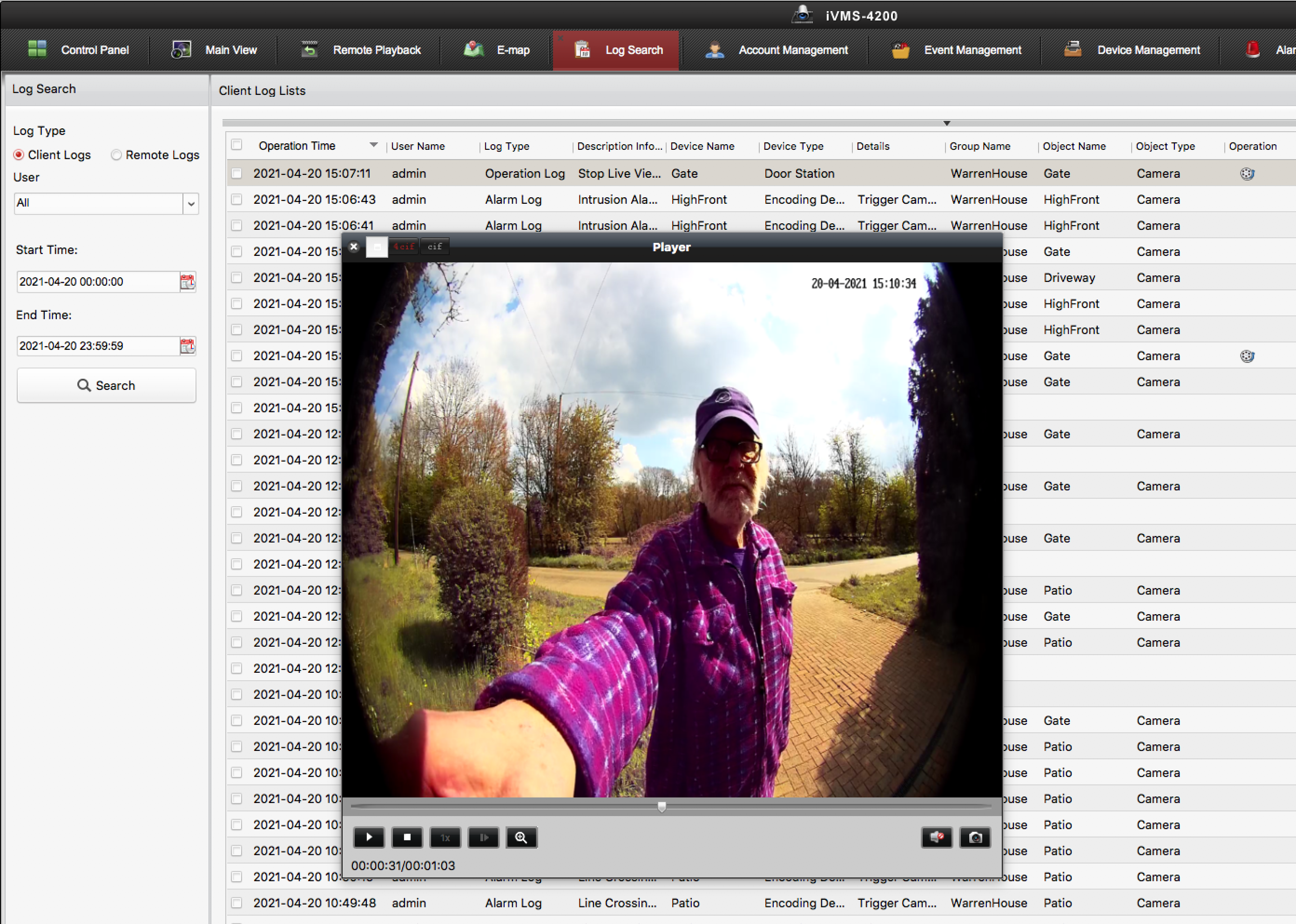

My experience of video from the 8003 is jaundiced by the belated discovery that nothing Hikvision works properly, or at all, on my Macs. But the only way I could record video was by hitting the record button during live view of the gate camera (which does have an SD card slot but almost zero SD card functionality). If you can live like that, you can record continuously. But the motion detection functionality didn't work at all - although it may work if you have a) an NVR; b) a Windows PC; and/or c) a storage server or separate disk partition dedicated to the task.
As it happens, the audio quality from the intercom is excellent and even on a Mac, the system does save a tiny, grainy snapshot of anyone who presses the intercom button. The live view when seeing/talking to a visitor at the gate is OK but low resolution, ie the main stream is 1920 x 1080 which doesn't look great on my 5K iMac and the 720 x 480 sub-stream is just about enough for the indoor station screens - unless you make the mistake of buying the cheapest KH6320 screen or fall into the trap of thinking that the most expensive 10in screen will deliver a superior image.
