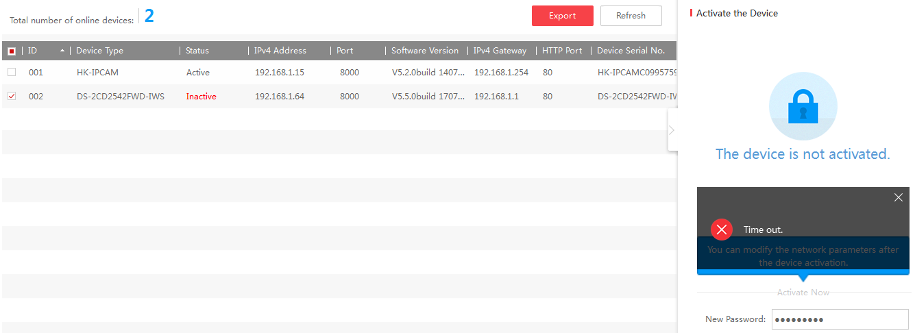

I went back to very same setup I done first time but nothing worked there either.After bit of searching I installed SADP tool to try to activate the camera.And here Im facing another problems:
When plugged into POE switch than SADP wont see the came.
When plugged into the socket and connected to a router then SADP sees the camera but it occasionally disappears and come back again.
When plugged into the socket and connected to a router then SADP sees the camera but can not activate (see the picture attached).
(The second camera in SADP is connected to the same POE switch and its working fine - but its not Hikvision camera)
This is my second day trying to fix this with no success.I have hard rested camera couple of times aswell.Please if anyone can help me with this.

just noticed your ip gateway on new camera is different to your working camera ?
should be 192.168.1.254

Hi amcross.The camera is back where it was fist time (very same setup as when it worked).I tried factory reset several times with no success.
I noticed that too but can't change it because can't connect to the camera.Could this be cause of my problems?.I tried to assign static IP to my laptop but I still couldn't access the camera via browser and I also wasn't able to access any website so I reverted back to dynamic IP's.
