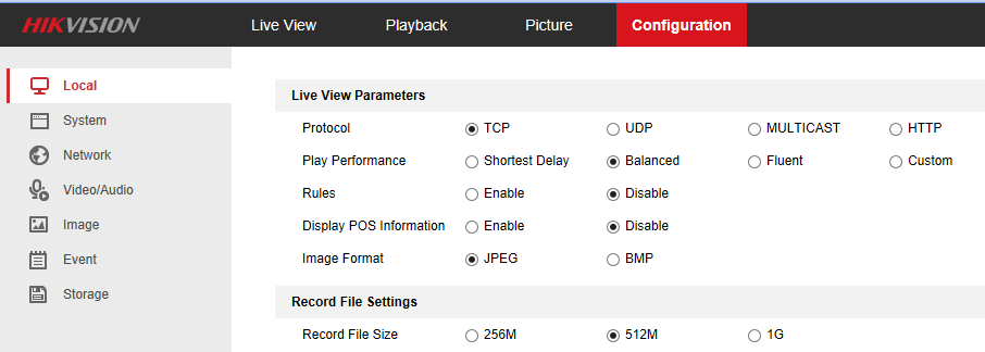

Sorry, I was in a hurry yesterday and did not explain well.
You can enable Rules and you should then see detections on-screen:

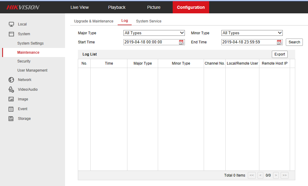

Also, you can check the log (of the camera or NVR where you have configured detection) and make sure that detections are actually happening:
2020
Once you are confident that everything is functioning normally on the device/locally, you can then proceed to diagnose/resolve problems with the App/notifications.
right that makes sense . thank you .
can i ask those images / screen shots you have just sent me . where do i access that because my nvr menus look nothing like this ?
By using a browser on your PC to access the configuration area - preferably Internet Explorer.

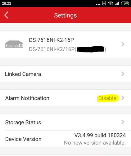

In your Hik-Connect app:
Swipe left on your NVR name to access it's settings.
2023
Check you Alarm Notification isn't disabled like below:
