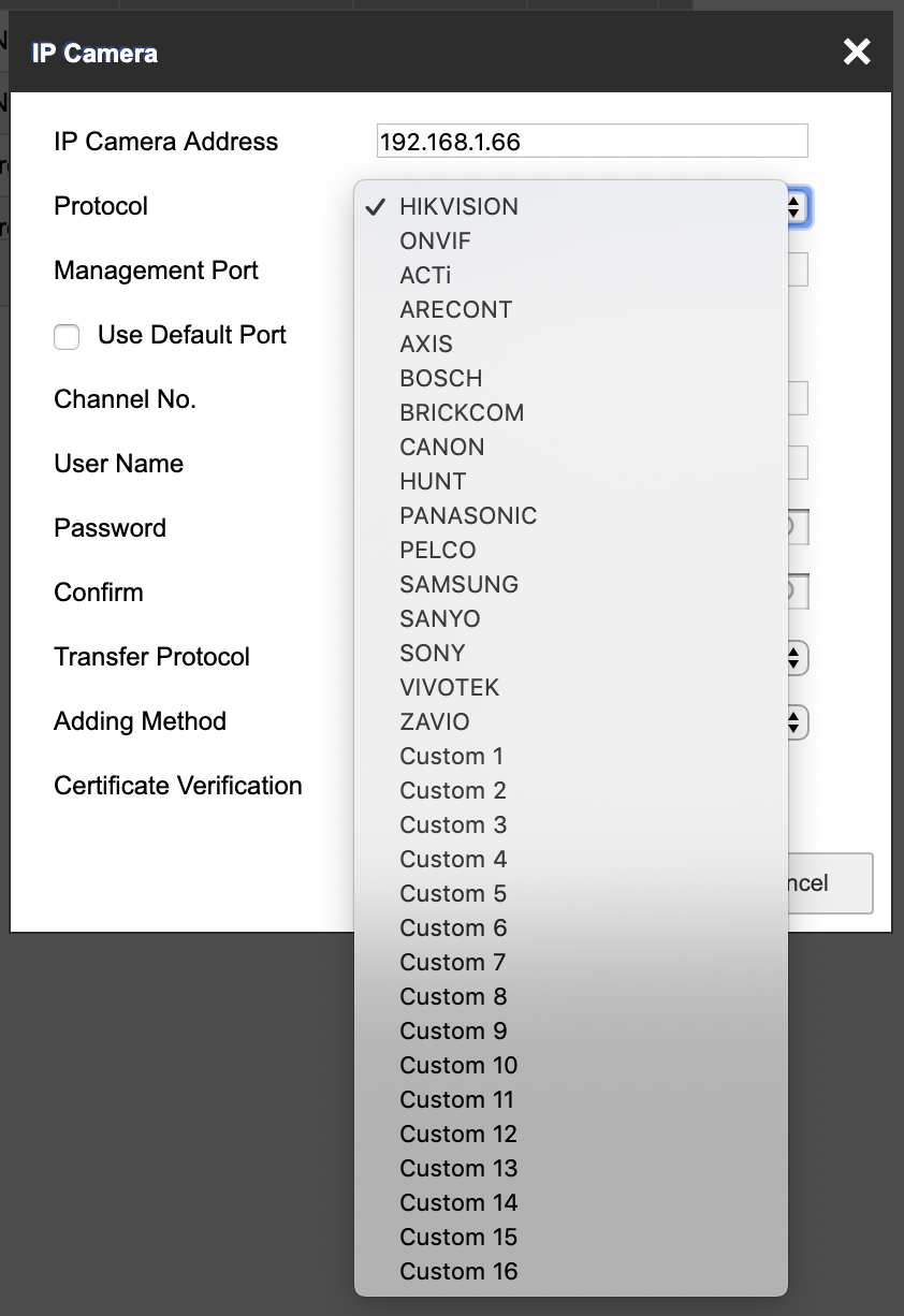

Is it possible to add cameras from other vendors on the PoE ports of the NVR?
Hikvision NVRs will support connecting 3rd-party cameras directly to the PoE ports, certain brands are supported fully but as long as the camera supports ONVIF you should be fine. The process of connecting a 3rd-party camera directly is slightly trickier though as the 3rd-party cameras will not support the auto-assign/Plug & Play feature of the Hikvision cameras, this means you first have to add the 3rd-party camera to your network using a PoE switch or Injector and then change the cameras IP address to match the subnet IP range of the Hikvision NVR. (e.g. 192.168.254.xxx)
Once the address has changed you can disconnect the camera from the PoE switch/Injector and connect it directly to the NVR, with it now using the same subnet the Hikvision NVR should detect the camera quite quickly.
You also need to make sure you change the protocol of the channel the 3rd-party camera will be using (see below) because if this remains as the HIKVISION protocol no 3rd-party camera will connect even if you change the IP address.
