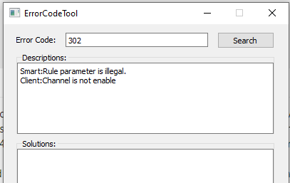

The error code tool doesn't provide any useful clues:

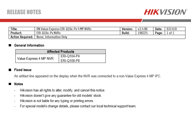

The last issued firmware seems to be: DZ_K75_ML_E_STD_V3.4.96_190225
There is not much in the release notes other than:
Still, it might be worth a try.
