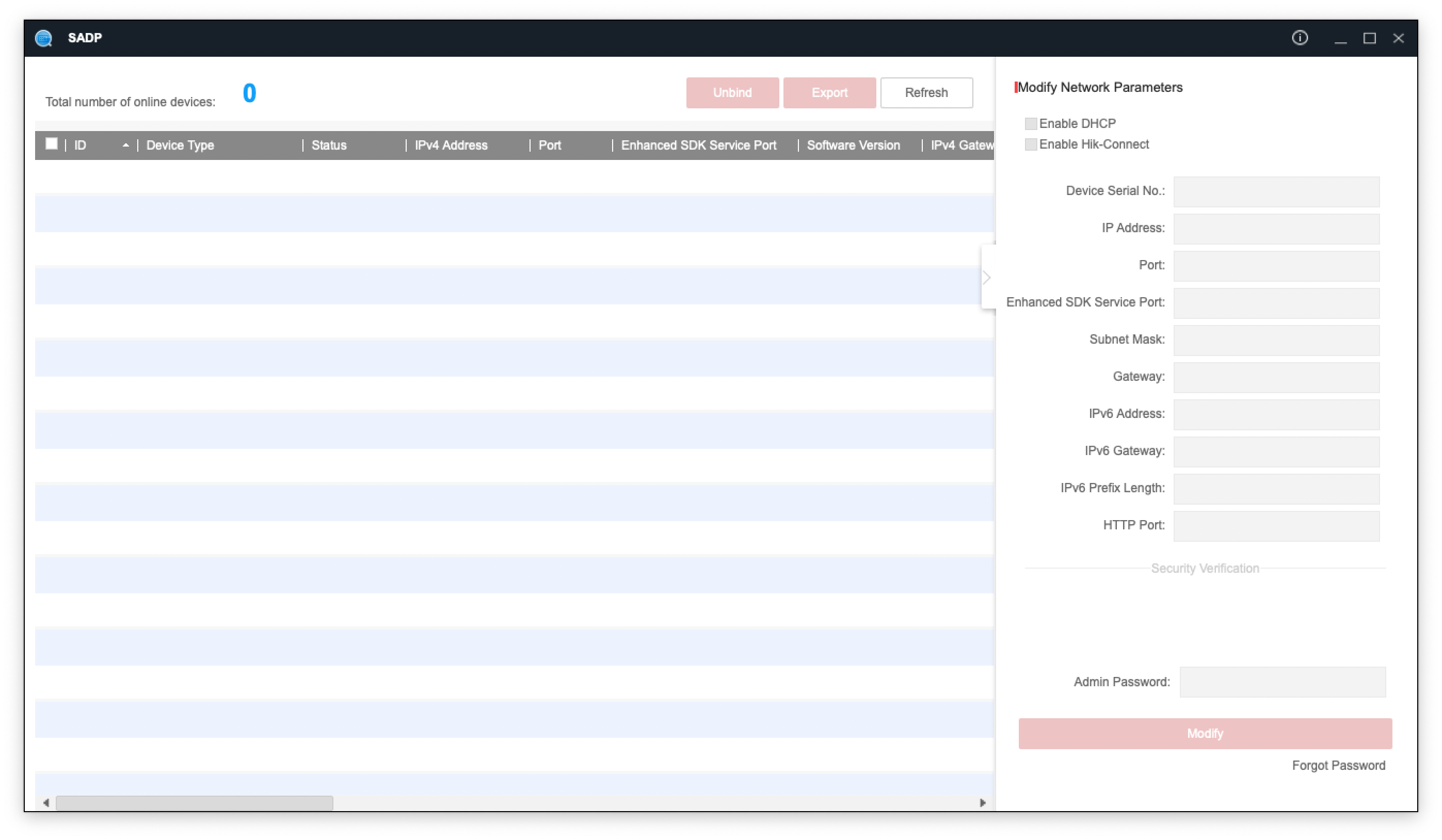

Do you have the Hikvision SADP Tool installed on a PC on the same network as the camera? If not can you please installed SADP via the earlier link and then post a screenshot here of what SADP shows you.

Thank you for your reply! SADP tool shows nothing!

Ok, then I'm afraid your only option will be to take the camera down and hard-wire it to your local network to make it visible to SADP again. My thoughts are that you either had DHCP enabled which may have allowed the camera to change IP addresses during the reboot or possibly the WiFi mode has been disabled during the reboot, but whatever the issue it is unlikely if it is not visible on the local network that there will be anything you can do without taking the camera down.
