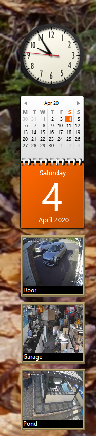

I thought I would post here in case anyone else is trying to get a snapshot from the Hikvision DS-7604NI-K1 / 4P(B) NVR.
The URL is slightly different than posted above.
http://<username>:<password>@<address>:<httpport>/ISAPI/Streaming/Channels/<channel>/picture
Use 101 for channel 1, 201 for 2 etc.
So an example for channel 1, might look something like this...
Using this URL and a custom desktop gadget I am able to view my cameras from my desktop.
Just been pointed at this thread (no pun intended) :) and wondered if you can point me in the right direction as per this thread?
