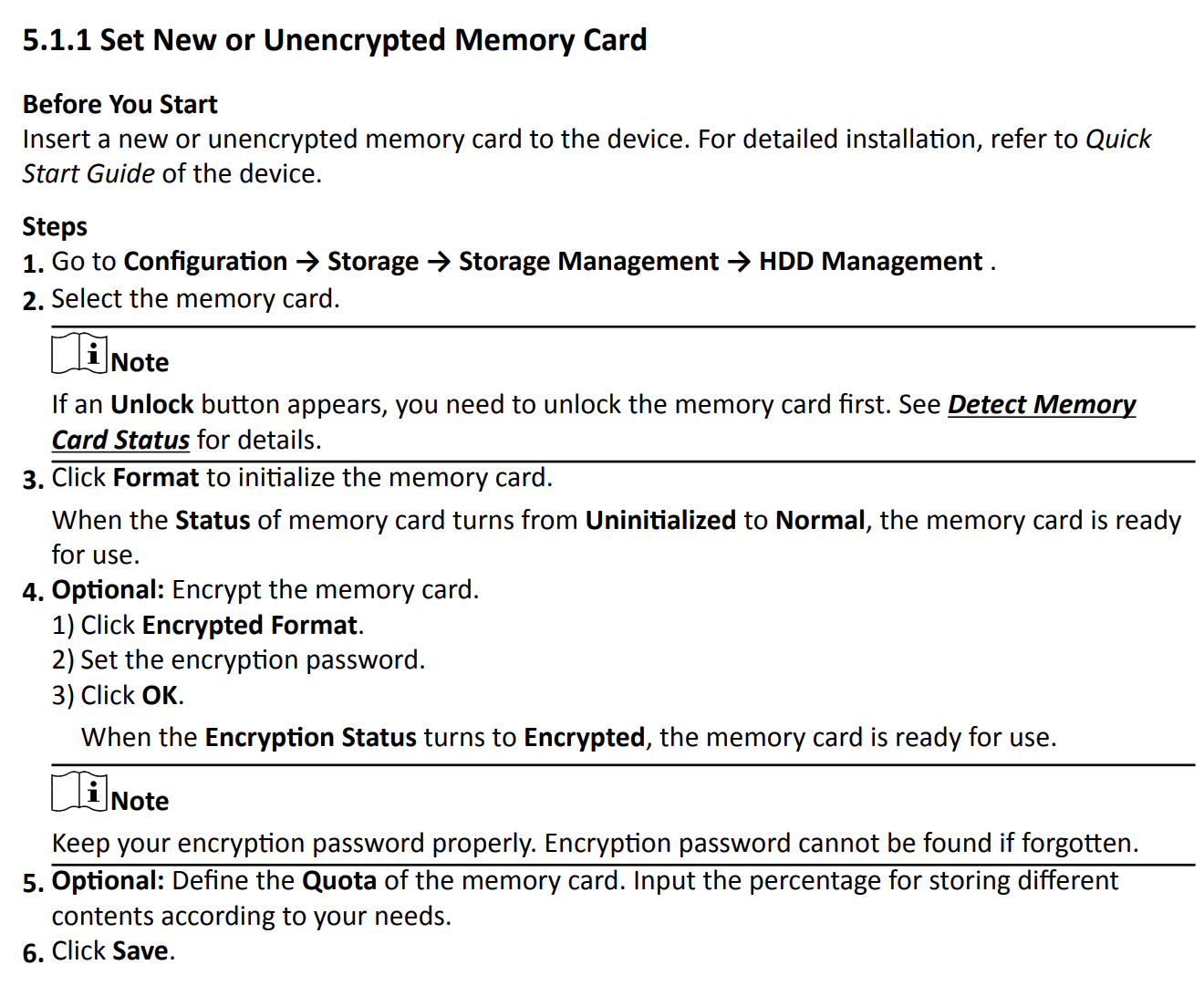

I did think some of the latest models would support this feature, but @mattiomc was looking at a specific PTZ model and I checked the datasheet and user manual for that model and I don't think it supports this feature. If the encryption feature is more important than the PTZ function then we would recommend a newer Hikvision model like the 2125G0-IMS, 2185G0-IMS, 2346G2-I(U), 2383G0-I(U), etc...
The storage encryption appears to only be available on those 2 HDMI (-IMS) model and select models from the EasyIP 2.0+ and EasyIP 4.0 ranges, so if any of the above models don't interest you you will have to have a look at each products datasheet to see which ones offer this feature under Network Storage.
