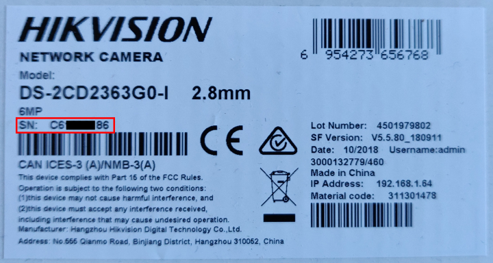

This nine-digit code is shown on the label attached to your Hikvision device AND on the product box (important to know it is also on the box label if you have already put the ladders away ;)).
It is clearly marked on the label as 'Serial No.:'

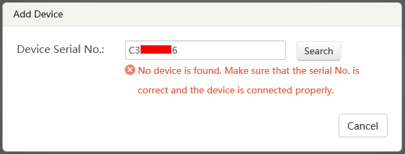

BTW - if you see the below error message and are sure that you have entered the serial number correctly, then HikConnect is actually informing you that it cannot find your device online.

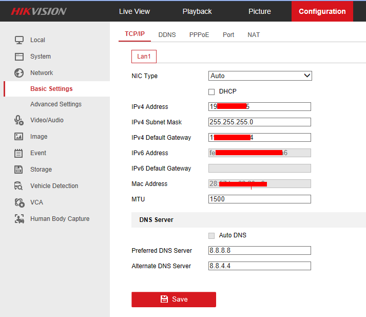

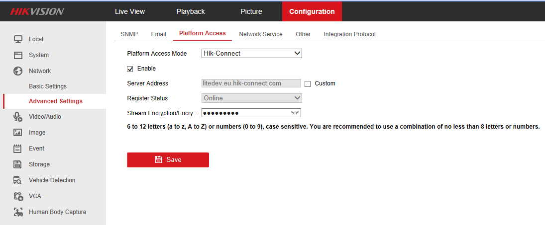

This is commonly due to either Platform Access for HikConnect not being enabled, or the other favourite is that the Network DNS settings for your device to use have not been entered.
"No device is found. Make sure that the serial No. is correct and the device is connected properly."
Platform Access should be enabled and look like this:
Your DNS settings can be safely set to Google's DNS servers, as per the last two fields in the image below:

hi i have taken the sticker with the sn on it of of the camera and i never had a box because i bought it used on ebay i have found the long serial code but i dont know how to find the short one could u help

Thread starter #5
The last nine characters:
