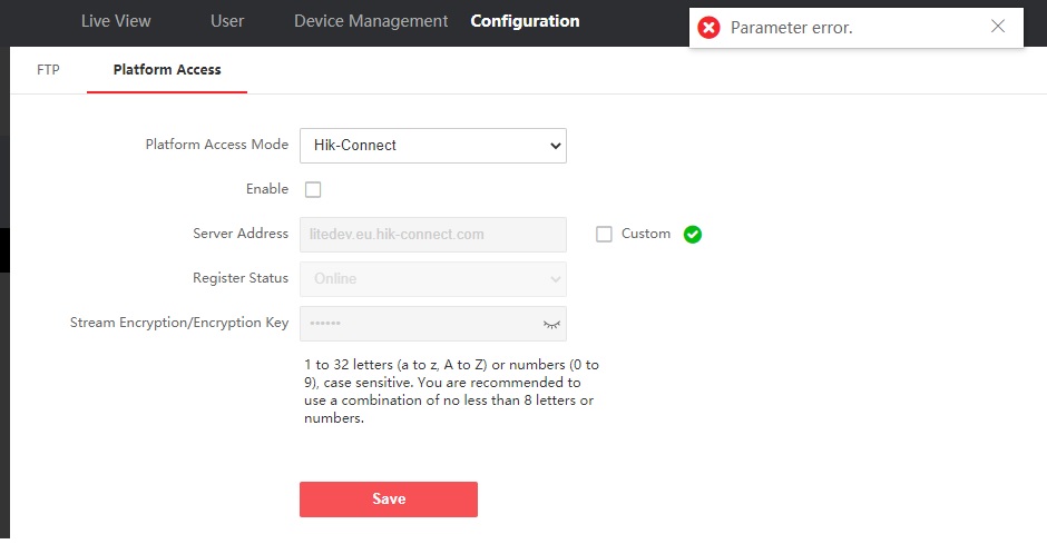

The only thing i noticed is when you go into the DS-KV8103 on Hikconnect you cannot enable notification (unknown error 380047 operating failed) but this was previously this way when it was working
I just get a message from HIKCONNECT after the intercom timeout to say "The call request has been cancelled"

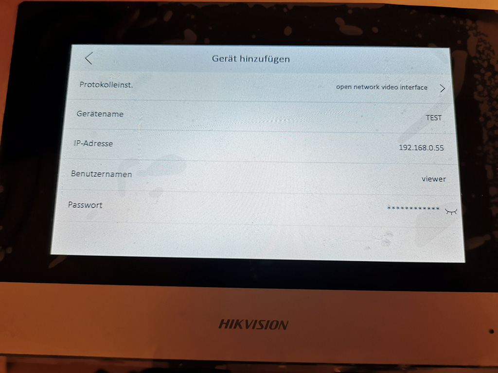

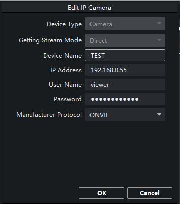

i am using the DS-KH6320-WTE1 (but they should all the same) model as indoor ... it can use other cameras to show on display... this is really nice.. theoretical. hik claim that it has the ability to use any onvif camera. i already hook it up on a usb-ttl interface to see the debug log. its clearly a firmware bug.

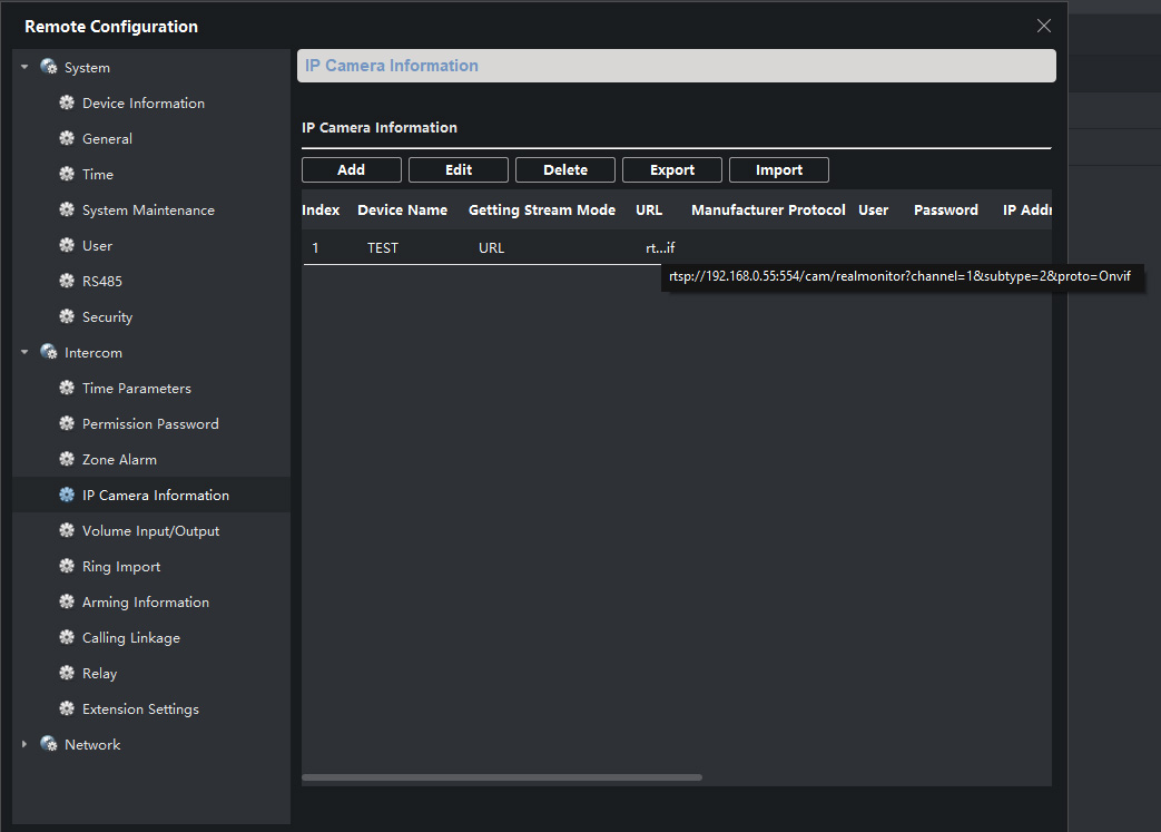

1) if you add the onvif camera in the menu, it seems that port is set to "00", but you can not change it manually.
see here:

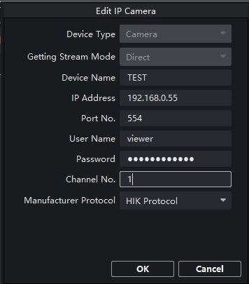

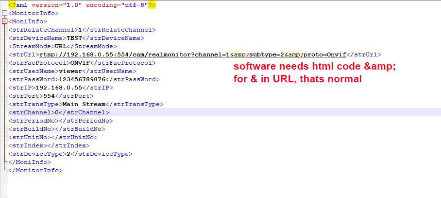

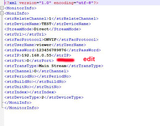

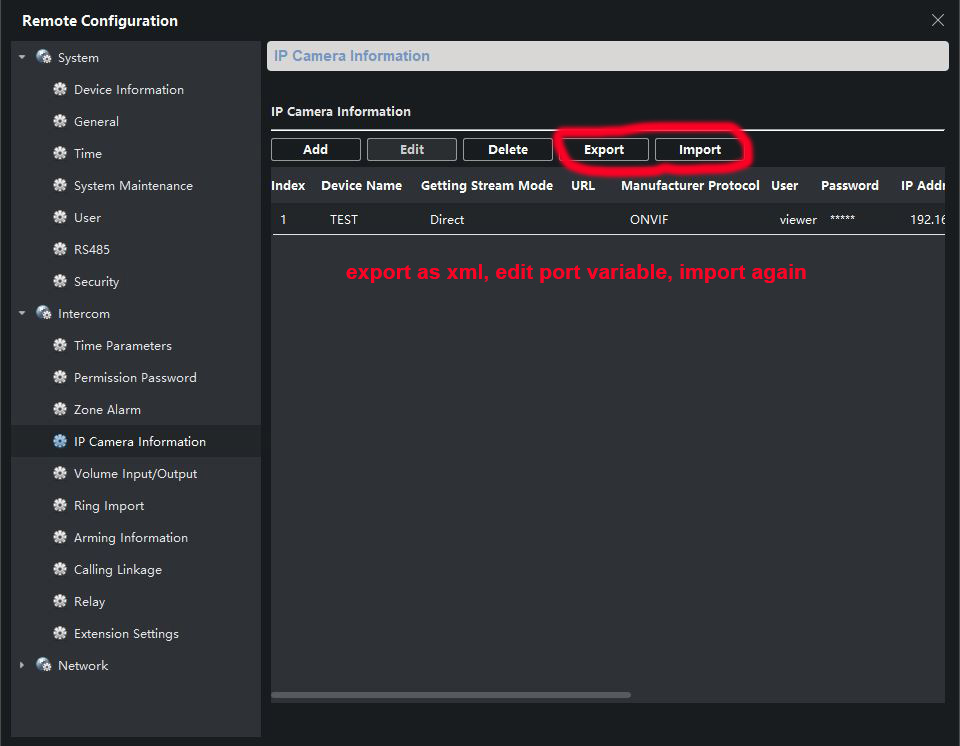

2) you can export the ip cameras as an XML file in ivms 4200 , then change the port and import it again (there is no port setting in the normal menu when using onvif protocol... only when using HIK protocol) ... BUT you cannot change the PATH of the stream url... the indoor station tries to connect to "rtsp.//username.password@ip.port/" .. no onvif camera is using just /
see:

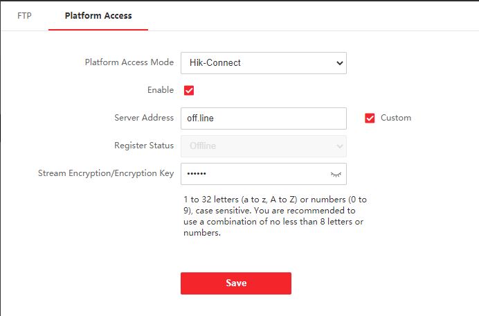

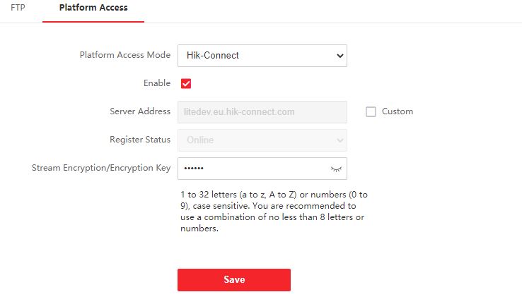

you cannot turn hikconnect p2p cloud on the outdoor station off, even if you have a indoor station connected.
Are you seeing the option to turn it off anywhere for this, and finding that this isn't working? Or, is it just that there is no option to disable it?
Thank for the detailed summaries @user7364 - I'll pass everything on to Hikvision and try to get the right people to look at these issues.

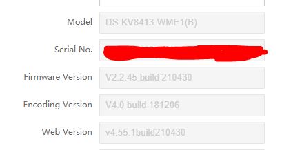

I have kv8 series, its also on my kv6 series... on older firmware 2.2.3 (on this firmware they include the standalone mode) and 2.43 it wasnt possible to click on the "enable" button, it was just grey (and also enabled).. so they fix something there but it still fail. i have no idea why the outdoor station have to be connected to the internet, because it is still working if only the indoor station is on hik-cloud.
See here:
only way out at the moment is this:
@Kyle
Me again..
i included some pictures and screenshots to make the situation better understandable when i am talking about import, export, XML file... see above in my original post ... !
All in all why i am writing here... i didnt buy this from an unauthorized seller... but ... if you buy this as a value set, the serial number of the display has region WR and of the outdoorstation RR ... DVS LTD has a youtube video of this set and he shows also the serial numbers of the devices... they are also RR and WR region... not EU. only if you buy the display alone, then you get a EU model
if you contact hikvision directly, they claim that you bought this not from an authorized seller because you dont have EU serial number... so you have to contact your seller, what i did. but this is more like silent post service... first i sent him all information, and he contacted hikvision and told them something like "customer want to add ip camera to display, dont work" ... so hikvision sent him general information what could be wrong if you want to add a HIKVISION CAMERA. after several weeks hikvision understand that i want to use an onvif/other brand camera ... so they send information about how to add onvif camera ... if you are not able as a customer or seller to figure out what the real problem is (with debug log) you are completely lost.
hope it works out now that someone on hikvision europe site can contact the china firmware guys...
Thanks again - I wasn't aware that was the case with the serial number on the value sets, it does sound like you've been going round in circles with it.

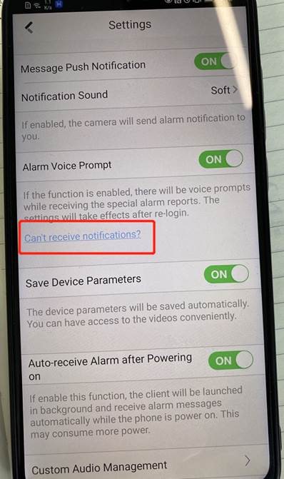

So this seems to be due to the app not running correctly in the background on some phones, as notifications sent when the app is not running in the background (e.g. via Google's FCM) don't work properly if the phone does not support FCM.
So, on new firmware, you just need to make sure that Hik-Connect is properly set to run in the background - touching this link in the phone's settings for the app explains how to do this:

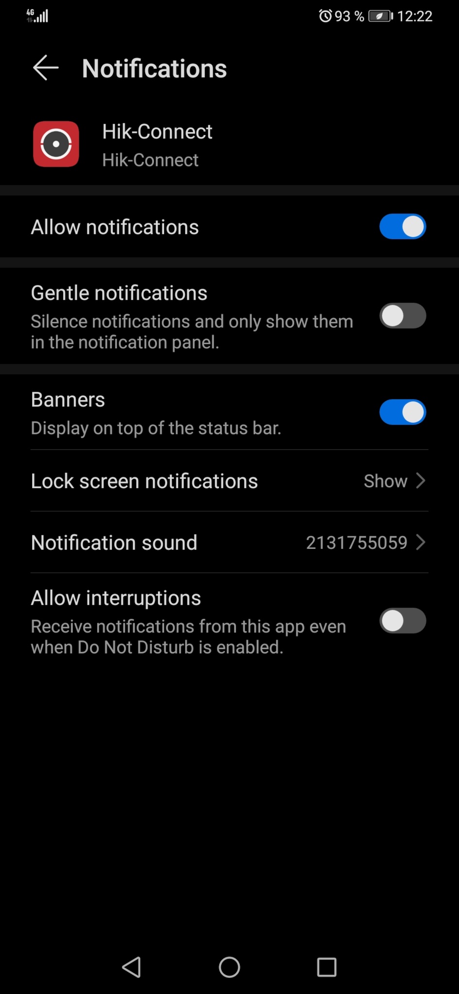

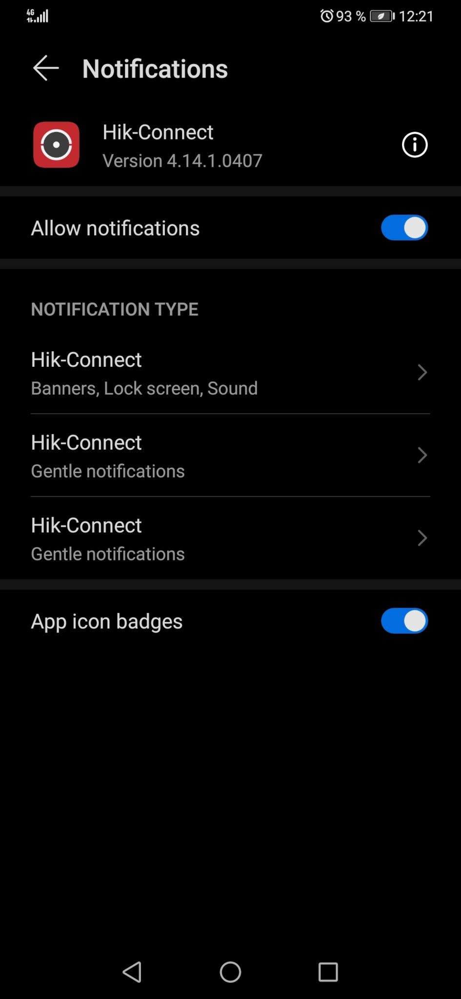

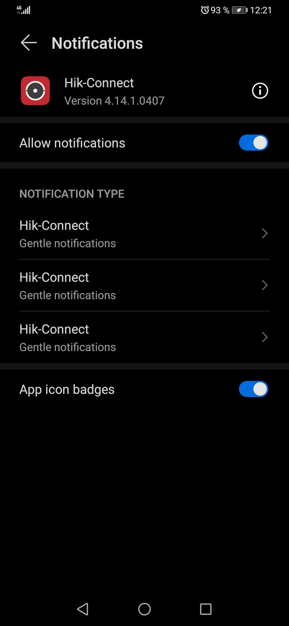

- change ringtone in system settings (its "2131755059" which is not related to anything on the storage)
- there is only a ringtone on calls (if not set to silent, dnd or virbate), NO vibration with ringtone
- "gentle notification" for the hik app only in system notifications menu do not work
if you set it to gentle, it will be default on next call.
also everytime you get a call, a new notification "type" is in the settings with default settings , some phones show them all, other phones show only a few (maybe only happens if you change the default settings)
if you send the screens to hikvision, please make clear that its also on 4.15.1 ... i have no time to upgrade/downgrade the app to have notifications on standby. the support of them is so stupid that they always not understand and say "there is a new version, please upgrade" ... :mad: And if you do and say "still not working" they stop answering you again.
screens:
before call:
after call:
