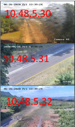

The problem: Fog/ water form inside the cameras below.
6 x IP67 cameras { DS-2CD4A24FWD-IZS, cost +- £550 per camera} and 2 x IP66 cameras { DS-2CD2625FWD-IZS, cost +- £220 per camera}.
Cameras were installed by CCTV company onto our towers +- 6 meters above ground.
The IP rating according to Wikipedia indicates one can immerse these cameras in water with no issue, hmm, we have this on tower not inside water.
Installed +- 20 months ago.
Water. fog became an issue +- 6 months ago.
Very slow response from CCTV company to replace the cameras.
=> Tiandy PTZ cameras installed +- 4 years ago on same towers have no fog/ water issues. {These PTZ cameras cost +- £1500 per PTZ camera.}
