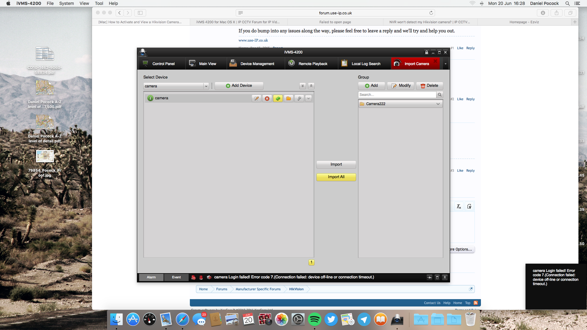

Hi, I seem to be getting problems trying this method and was wondering if you could help?
I manage to find and activate the camera, how ever when I try to add to a group I'm having problems. It keeps on giving me a error like the one in the attached photo! Any ideas?

  • Go back to the Show Online Devices table and select your camera from the list.
  • Click on the Select Device button.
  • Enter your camera's credentials and ensure that Export To Group is ticked.
This should automatically create a group for your camera based on the nickname you gave it. Can you just confirm for me whether the error presents itself when you use this method too?
