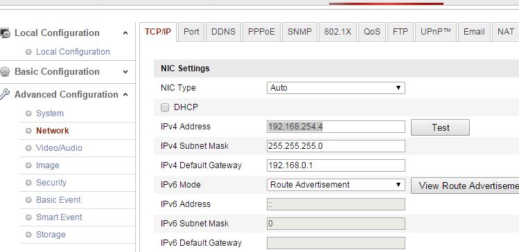

I have 5 DS-2CD2142 cameras and one DS-7608NI-I2-8P NVR. However not success full in the setup of time sync to NTP server as above. When testing get failed. I have tried to reconfigure the network setting in the camera to use gateway and dns as my route setting without succes as well. Also use nvr gateway without success.
Anyone who has got this to work where cams are plug&play to nvr?

Have tried few alternative ntp server and all failed.
The cam ipaddress is set by the nvr to 192.168.254.4. Can access the cam directly through the 'virtual host' functionality of the NVR. Could it be because the cam ip is not known by the router (I assume)?
The cam ip has been assigned by the nvr. But have tried to set cam's gateway to the nvr ip 192.168.254.1 but thats don't makes a difference. Gateway in the route is 192.168.0.1 and assume thats what to be stated as gateway for the cam. however that don't work either... (the default gateway was by teh cam set to 192.168.1.1 which I have changed to 192.168.0.1). But have tried any of them

If the camera is plugged directly into the back of the NVR as it looks like yours are, the NVR's settings will take priority over the camera. Further, the cameras will be on their own network segment defined by the NVR which is usually 192.168.254.x, unreachable by the rest of the network (unless you use virtual host) so they won't be able to directly contact the NTP server
You won't have to worry about setting the NTP on the camera itself, but should set it on the NVR instead. This will then manage and push the current time to the cameras that are connected.

Thanks / Yeps, all cams connected directly to the nvr. And the NTP seting works fine on the NVR. Willwatch whether cam's follow the time of the NVR over the next one-two weeks
