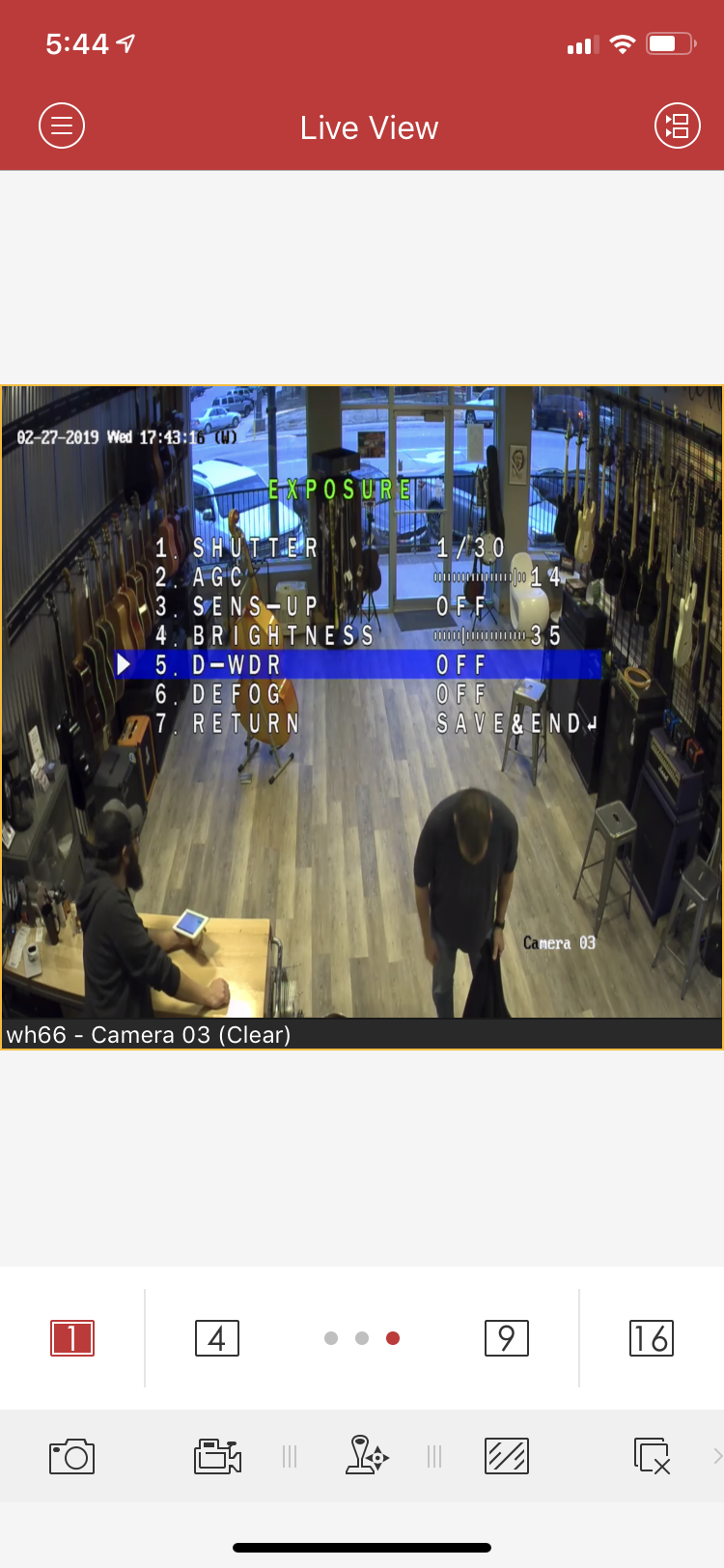

How do I get rid of the menu on the screen from my mobile device

Is this the menu of a CCTV App?
Which App please?
What device?

It is...it’s the iVMS-4500.
It’s on one screen on mi iPhone. I was looking at cameras yesterday and I must have clicked on something that opened the menu and now I can’t get it to go away.28E1C4F3-1ECE-4735-9D3C-5F61081E9FBC.png

That looks like the "menu" of a particular camera you were viewing.
Use PTZ zoom controls to navigate (ie. Up an down) and "iris +" as enter
